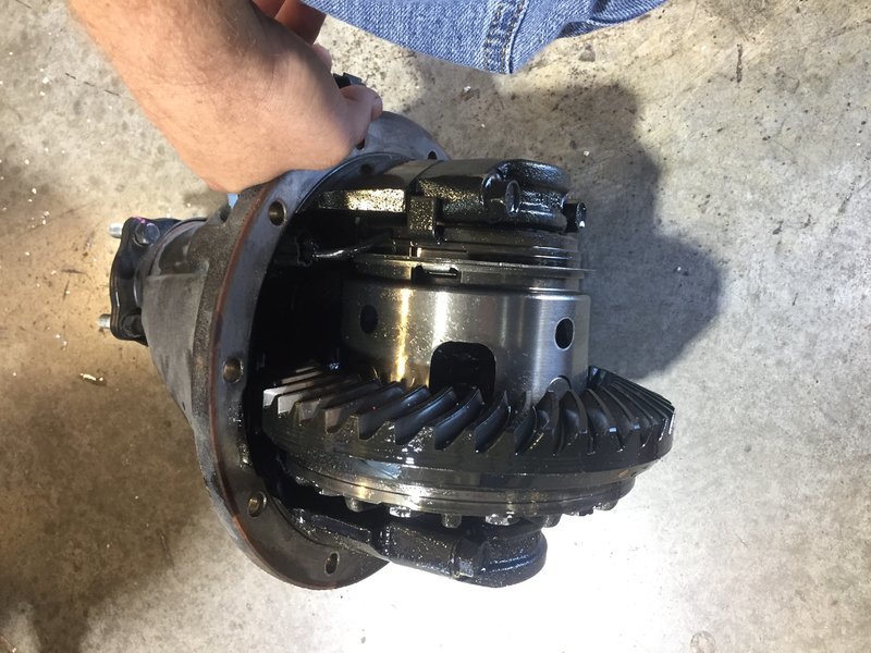

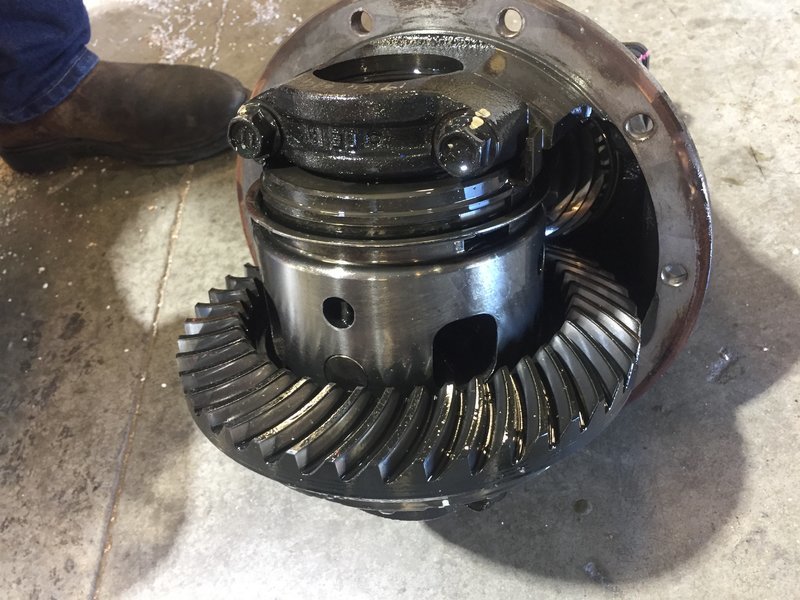

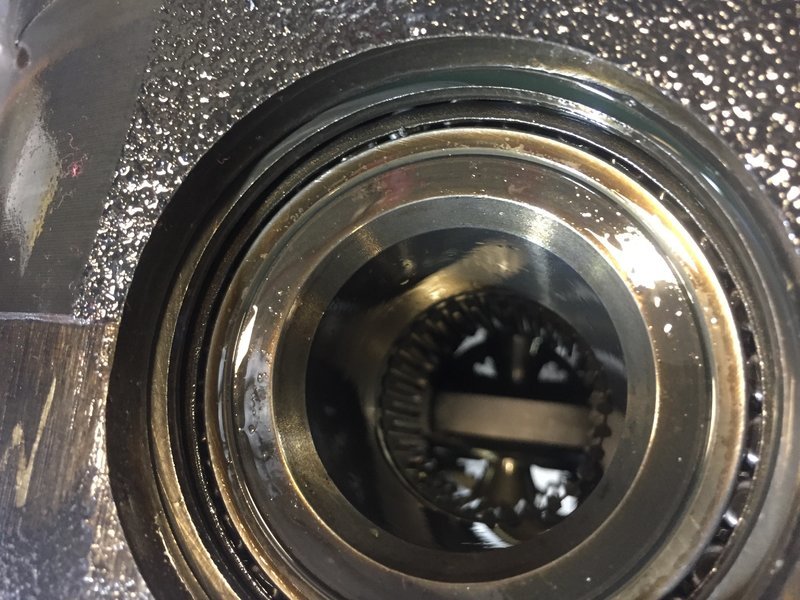

    It is an actual locker. There is not as of yet a locker any time mod. IMG_2610.jpgIMG_2608.jpg IMG_2609.jpg
    Edit: added pictures

    So it looks like they changed from the old style to an electromagnet style?

    That's correct. That was one of the improvements on the 3rd gen. It's all tucked away now.

    So yes after looking at the pic a little closer it is an electromagnet style. I can see the plug and the wire. I had a jeep JK front locker in my TJ unlimited. Great design and worked way better than the ARB.

    Oh thanks for the picture.
