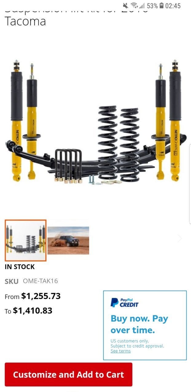

    Budget is $2500, looking at OME TAK-16 on Toytecs site.
    Want to keep daily ride quality, gain some ground clearance for mild off-road Backcountry camping.

    Is it possible to keep the Stock 16" Rims with the above OME kit? Or would it look odd with the added ground clearance??
    I guess what my main question is...
    Is the OME kit worth the $ over the Stock or should I keep the Stock Suspension and save for a higher dollar system??

    I didn’t bother looking up that kit but it looks like what I’m running. It’s not better and it’s not worse. I changed my UCA while doing the install too. The only thing I would have done different is put greasable pins in my leaf packs. The dakars LOVE to squeak!

    I just did the OME 2 inch kit with HD leaf packs. You will want the HD rear leafs with the added weight you have in the back. (I also have a Leer top and Decked system)
    The ride will be more stiff than stock and soak up larger bumps better.

    I found OME to be way too stiff and preloaded because they are designed for overlanders. I had the medium kit. And even with a bumper it was jarring. It settled and I lost 3/4” of lift and it was still stiffer than my new shocks with 700# springs, but the valving is way better
    I would do a Bilstein 6112/ 5160 setup instead and you will spend almost the same anount
