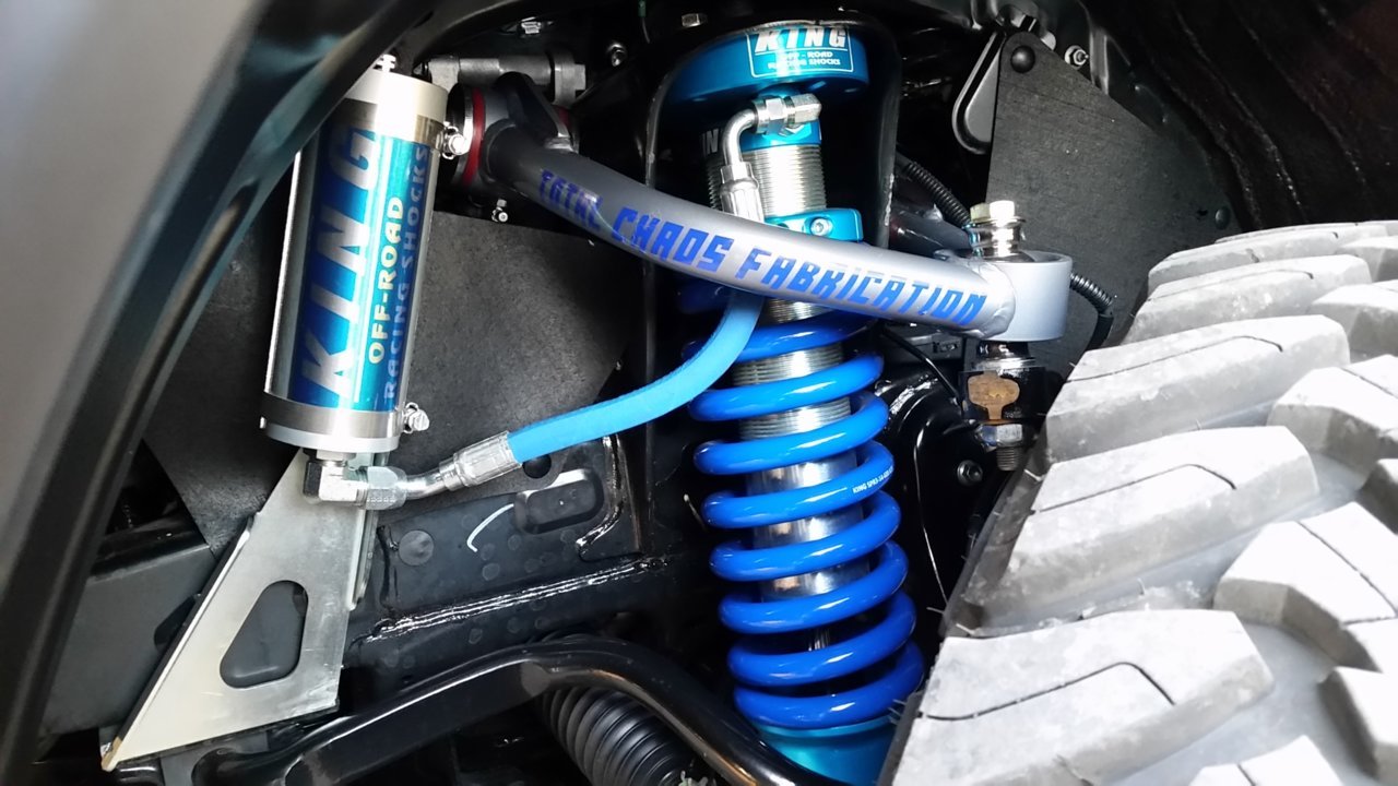

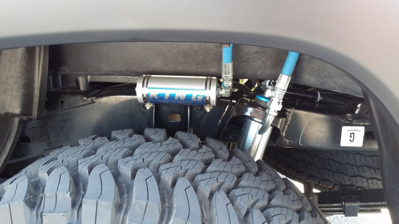

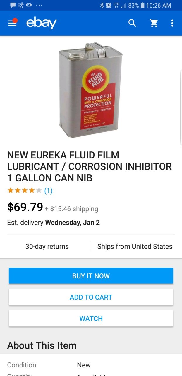

    Kings for the win, I can't wait until Spring to put all my shit on. Also got the new Delta Joint ICON UCA's, and Fluid Film is amazing stuff as this frame is 4 years old now in the Salt Belt of Saltachusetts. And next week these beasty monsters go on, I currently have OME 887's up front with 5100's and in the rear I have an ICON 3 Leaf Progressive AAL with ICON 2.0 Shocks. Ride is nice but I said screw it on Black Friday and bought a bunch of stuff.

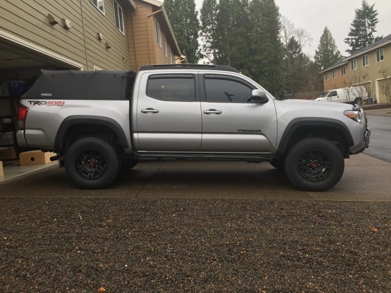

    KD Max Tune, King 2.5 coil overs T.C. UCA's, Deaver leafs, 17x9 Black Rhyno Warlords, 33" Toyo M/T's, Metal Tech rear bumper, Westin HDX drop steps with Bullet Liner coating, K&N CAI, Baja Designs fog pods, Rigid Midnight addition 3" pod ditch lights. Cali Raised brackets and 32" behind the grill mounted light bar, Southern Style Offroad Lopro Stage II front bumper, Warn winch, FACTOR 55 Ultra Hook, FACTOR 55 Hawes Fairleed, full debadge, Cosmetic goodies such as 15% carbon tint, matte black in channel rain guards, interior LED's, Teton Workshop shift knob, Inferno vinyl detailing on the interior, Cali Raised multi rocker switch cubby insert with Mc Tuning LED switches and a few other mods I've probably left out.
    Yeah buddy!! :thumbsup:

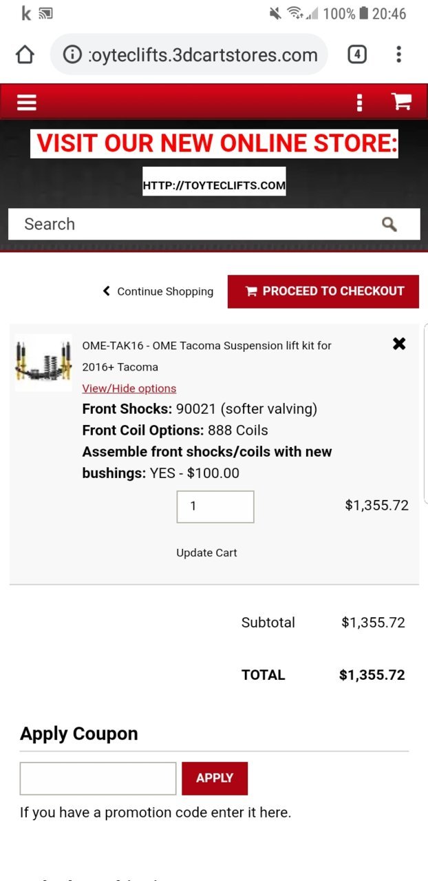

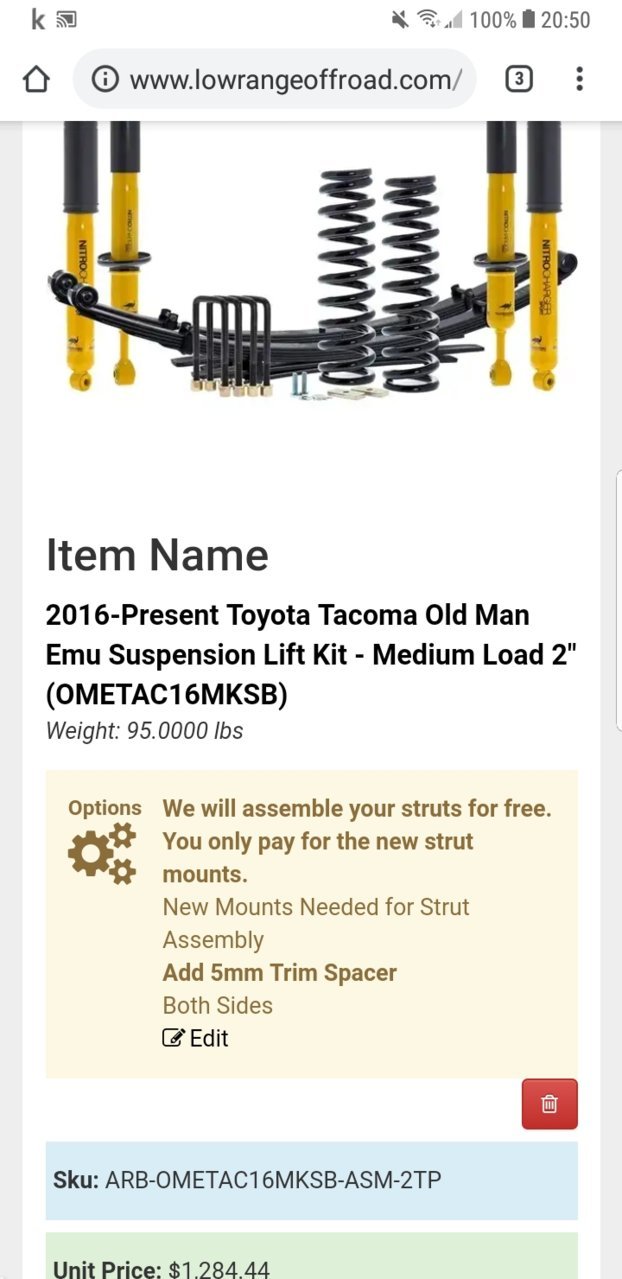

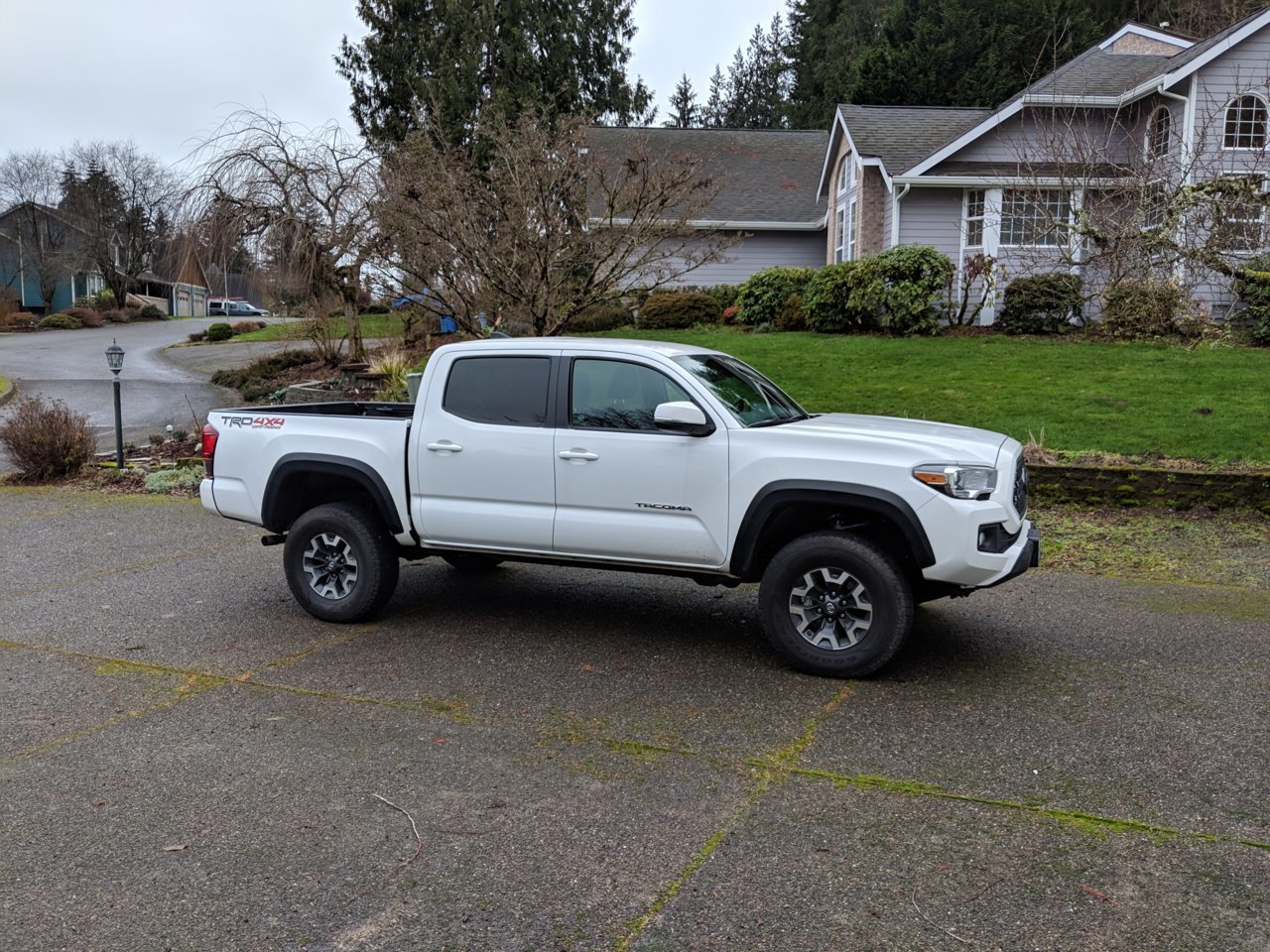

    Been reading as much as I can about all options and thought about what my real needs are going to be.
    My original thought was the OME Medium kit. Get a bit of ground clearance, Be able to handle a bit of added weight but still be a good daily ride.
    Then got caught up looking at and drooling over all the high dollar builds and kits..
    Anyone know of a better price???? I have never dealt with either of these Companies... Any thing to worry about???

    Cruiser outfitters quoted me a little cheaper on the phone today. Call em
