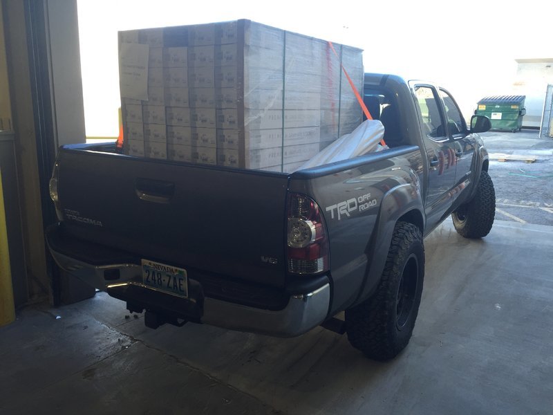

    I just hauled about 1400 pounds and it was fine. I've got a toytec add a leaf, it still bottomed out though image.jpg

    Interesting.
    Oh...not fine.
    :confused:

    *bottomed out over speed bumps. I only had to drive it about 10 miles
