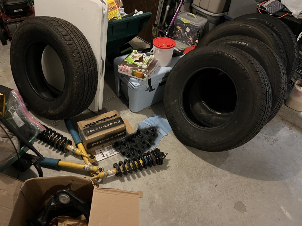

    Just to update on the situation I posted about earlier: Jtaco gave me a pretty good price on parts to ship out here to Florida but I thought I would be able to find the parts here. I took a trip down south to go see my grandpa and on the way down I got some shocks from a guy in Deltona and on the way up I got some upper control arms from a guy in Daytona (also stopped and got some stuff from the outlet mall for Mother’s Day). I’ll post an update after they’re mounted.
