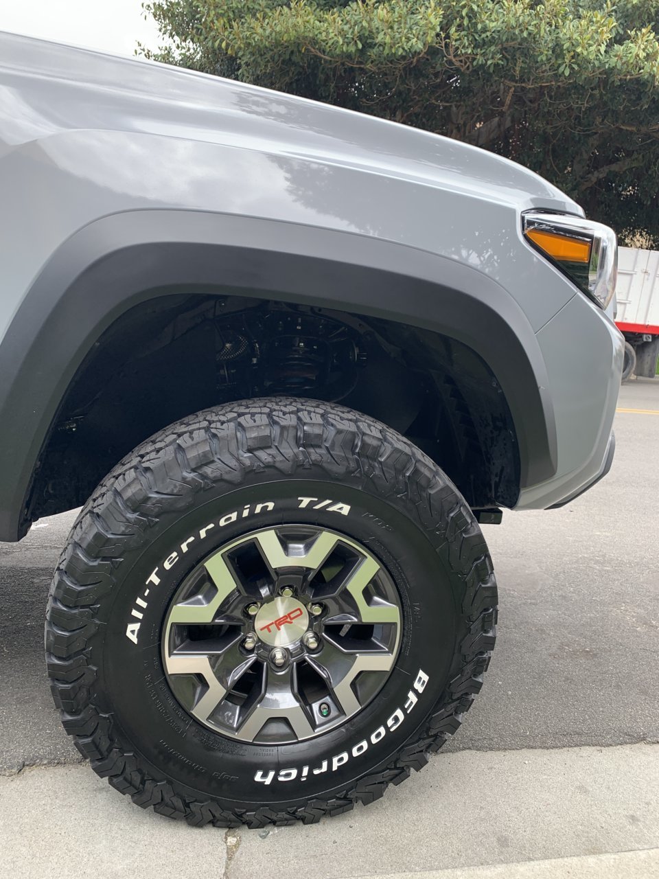

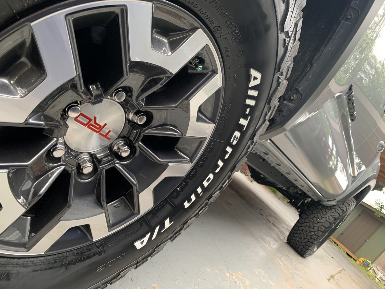

    The finish on the wheels and centercaps are virtually identical. The caps are slightly more glossy. The wheels are in fact a little more “machined”, but in the sun these wheels pop.
    To me, this completely changed the look of these wheels and the truck. I was about to trash them or paint them or just buy Volks until I figured I’d take a stab at this. Now I’m thrilled I did it.

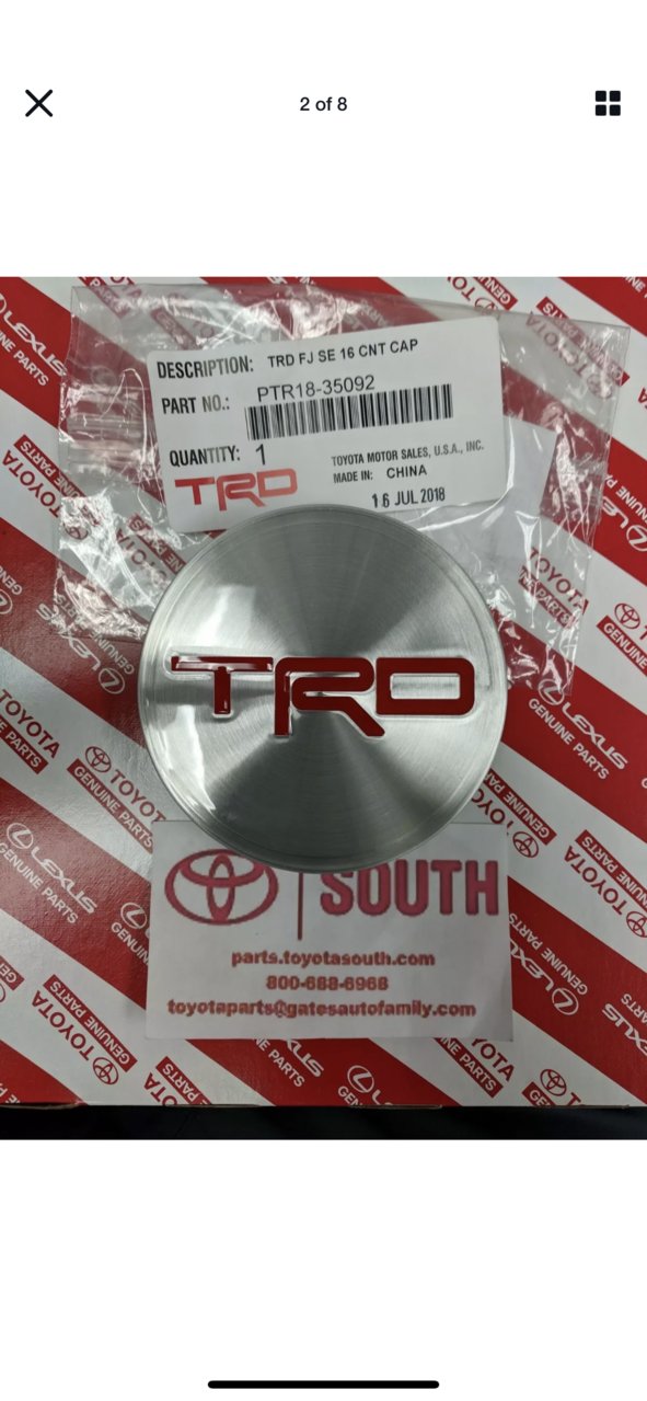

    The trick to getting these centercaps to work on these wheels is in the use of the Spidertrax spacers. The spacers serve as the backing for the 3M adhesive to bind to. Without spacers you’re likely not going to be able to make this work quite like this.
    You have to cut all the tabs off the new center caps, make them smooth by using a very sharp blade to make the back as flat as possible where the tabs were, clean with alcohol, then apply the 3M super strength tape so that it adheres the cap to the spacer. The tape I used is very thin and nearly permanent. When you pull the wheel, the centercap remains adhered to the spacer. It’s a pretty trick little detail.

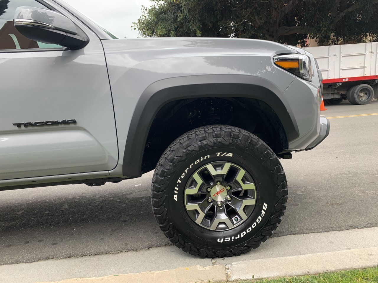

    Another pic. You can see how flush the cap is to wheel. I personally love that I’m using the stock wheel, get the stance and clearance I need, and I’m using hub and lug centric equipment. The stock lugs are awesome. I’ve had some really bad luck with aftermarket wheels using conical lugs and vibration. This setup is smooth as silk.

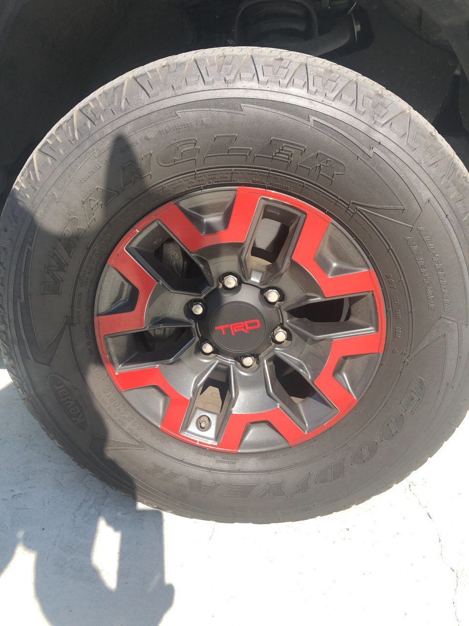

    B56FA7D1-CA33-4165-AD70-728A5EF5F74F.jpg I use the 4Runner TRD caps for mine.. I did a similar mod to make em stick as well.. New tires & spacers going on this weekend
