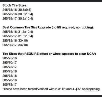

    Hi everyone..
    I need to know if I can fit 265 70 17 (snow tires and rims) on my trd off road tacoma which has 265 70 16 now

    No I am not using same wheels I wanna take off 265 70 16 wheels and tires and put 265 70 17 wheels and tires(snow)

    Yes that will work fine.
    :hattip: as long as 17 wheels match 17 tires and 16 inch wheels match 16 inch tires.

    Last question please if factory size is 16 if I put 17 wheels and tires will not harm my differentials or gears

    None whatsoever.
    Sports typically come with 17's stock and limiteds' come with 18's stock
    Off roads and sr5's come with 16's stock.

    The cross section is the same, just 1” in height. Should be fine

    Use your new found 1/2" of lift to lord over all the stock trucks you see.

    Most people run stock size for winter and 1 size up for summer.
    245/70R17 and 245/75R16 is the best size for winters on a Tacoma.

    But I already got 265 70 17 for winter from a friend and I was wondering if I can use them without problem
