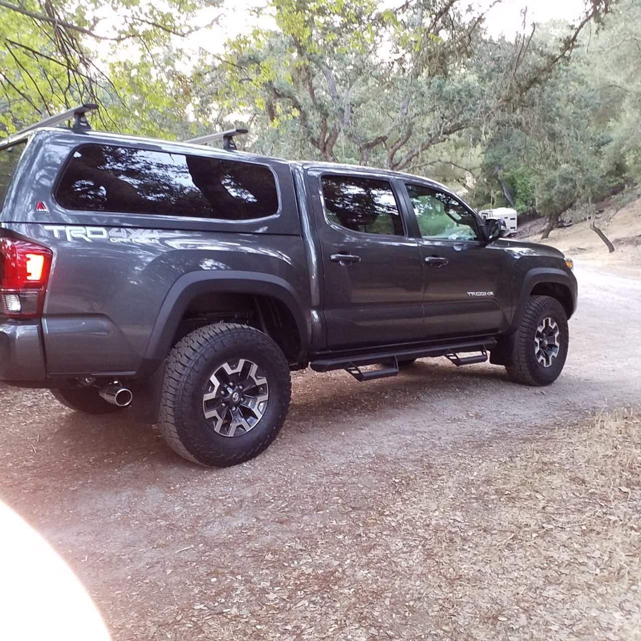

    Update I went through Toyotec lifts and did the OME 887 front springs with the OME soft ride loaded front struts and OME rear soft ride shocks. Front diff drop and skip plate spacers and Toyotec 1.5 blocks. Installed it all. took the truck to my shop. Aligned the truck. I did a 200 mile plus road trip today. Ride is very good. Handles good too. I thought the stock TRD/ Bilstiens were good riding. Wrong. The size difference in the diameter of the shocks is night and day. Thanks everyone.

    Pics?

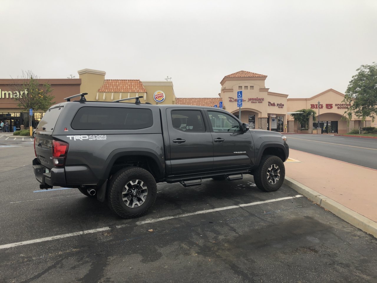

    This picture is stock suspension with Falken Wildpeak AT/3w tires
