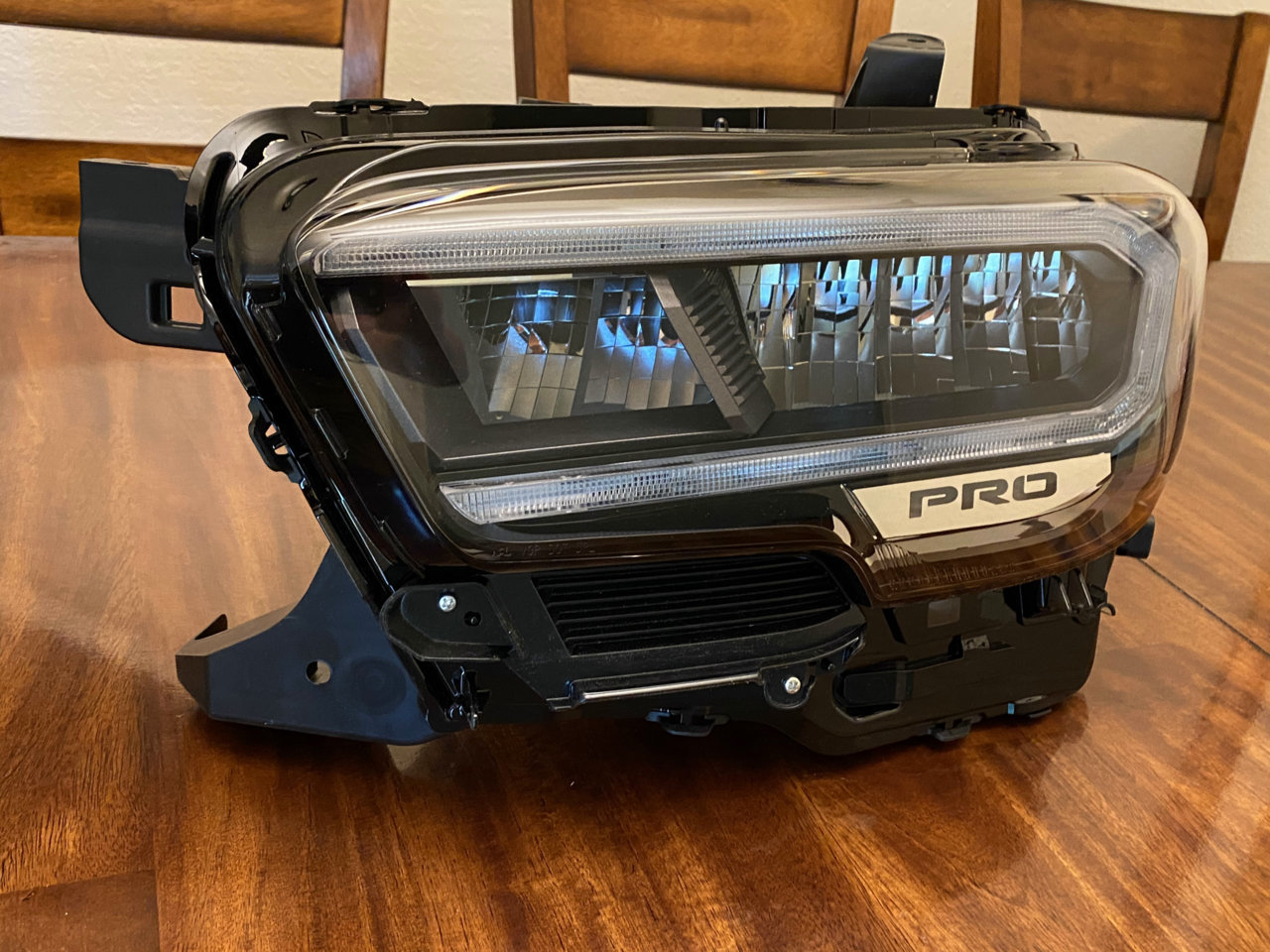

    Welcome to the forum! The LED headlights are an outstanding performance option. They can be added later by purchasing them separately and installing for approx $1300. Certainly would be far more ideal to have them come on the truck though. Note that replacement LEDs in the halogen lights come nowhere close to factory LED performance. Lots of headlight info here, see post#3 for factory LEDs:
    https://www.tacomaworld.com/threads/3rd-gen-hid-vs-led-vs-halogen-h11-projector-headlights.589465/
    They use LED reflectors, which are more efficient and higher performing than LED projectors.

    Interesting. So they aren't a typical reflective housing you see on the older vehicles.
    What's the LED package consist of if you're already getting LED headlights?

    Halogen LED reflectors are more of a half bowl shape to encompass all the light from an omni-directional bulb as much as possible to redirect it forward. LED reflectors are more like sloped scoops, where the LED fires down from above into the sloped reflector to direct the light forward. They use this design as the LED light is directional, and mounting the LED on top allows the use of the largest reflectors for a given lamp size (and larger reflectors are more performant) and using the top mounted LED also reduces direct emitter exposure (glare) vs say mounting it on the bottom.
    OEM LED
