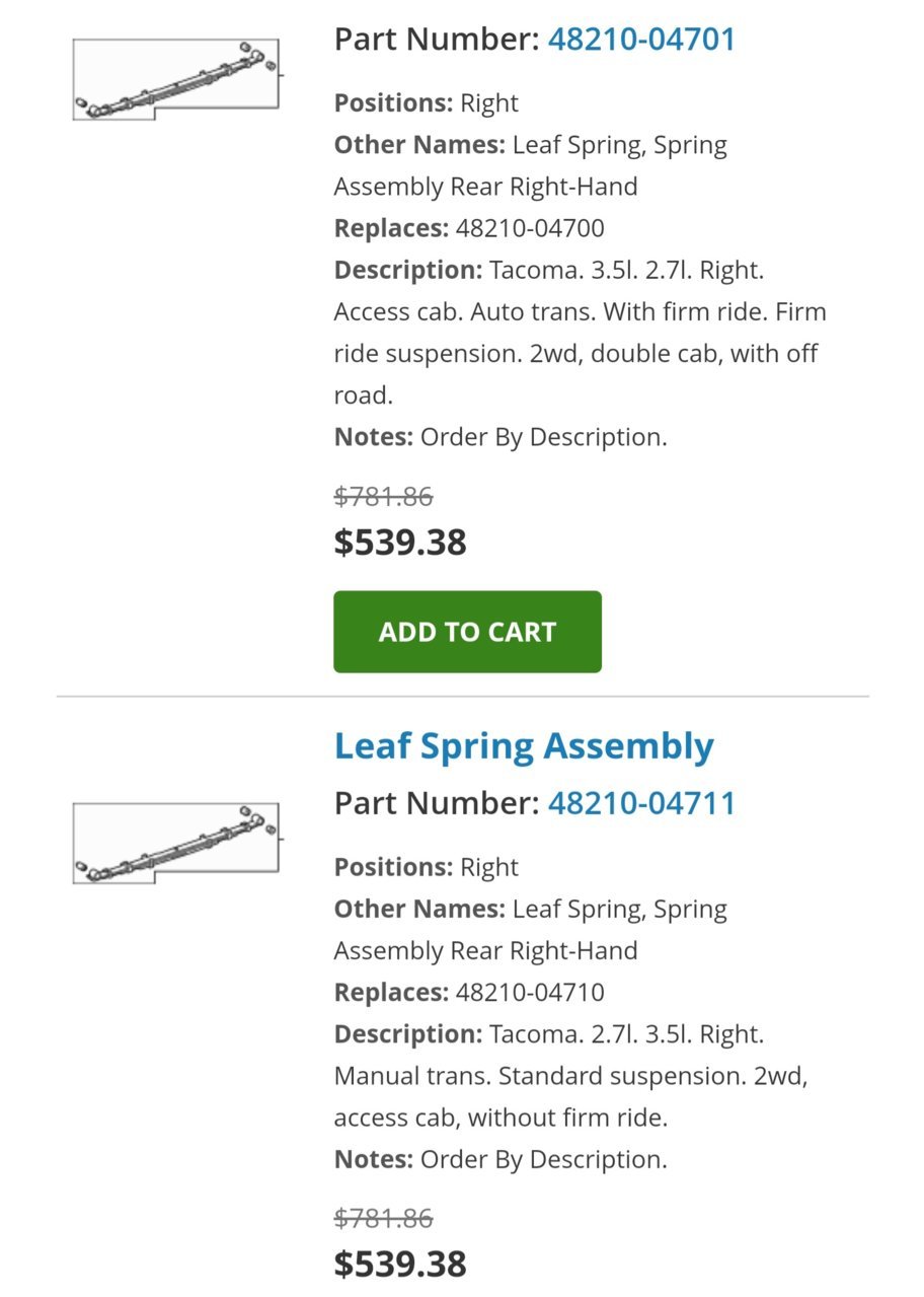

    I changed the leaf packs. Look at the part numbers, they are different for a reason, I have OR coils and leaf packs w the billstien shocks. Drove it 2 weeks 100 miles a day, w out changing the leafs, noticeable softer.

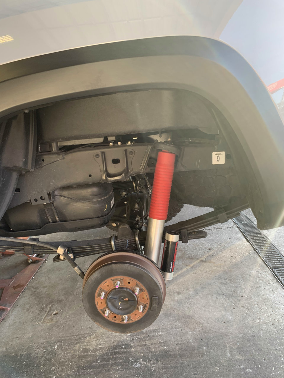

    If it helps, here is a photo of the TRD OR leaf pack (Ignore the Pro shock, I replaced my OEM OR shocks this weekend). A93A8493-79AD-4FB3-8833-FD54B11DDEDD.jpg
    One is with firm ride the other is the standard.
