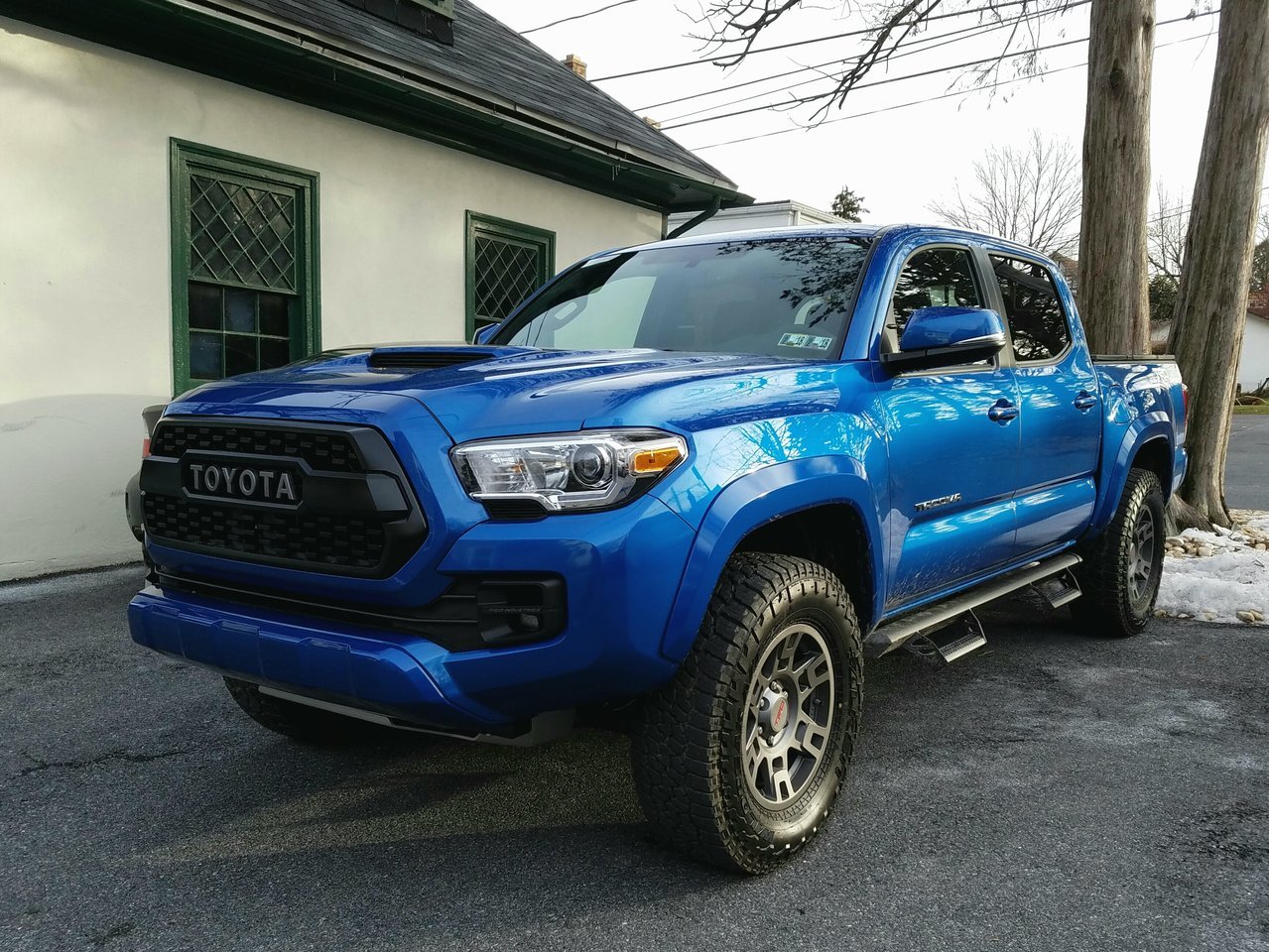

    I did a TW classic set-up and went with the TRD 4-runner wheels with a tire 1 size larger than stock. This is a well-known and proven mod. The stock 17” tire they use on the TRD sport model is 265/65/17. If you go 265/70/17 you gain a 1/2” of ground clearance, and keep the same amount of sidewall as the OR’s stock 265/70/16 tires, for a similar ride.
    The other thing you gain, is the TRD 4-runner wheels have a different offset, so you get more “stance”.
    Super happy with how it worked out for me.
    Comb, DavesTaco68 and NerdTaco like this.

  10. Dec 22, 2017 at 7:47 AM
    Comb
    Comb Known Member
    Oct 27, 2016
    #200814
    1,834
    2017 TRD Sport 4x4 DCSB 6MT BBP ABCDEFG
    OVTune Verified Purchase
    This is the way to go. I did the same, and I love it.

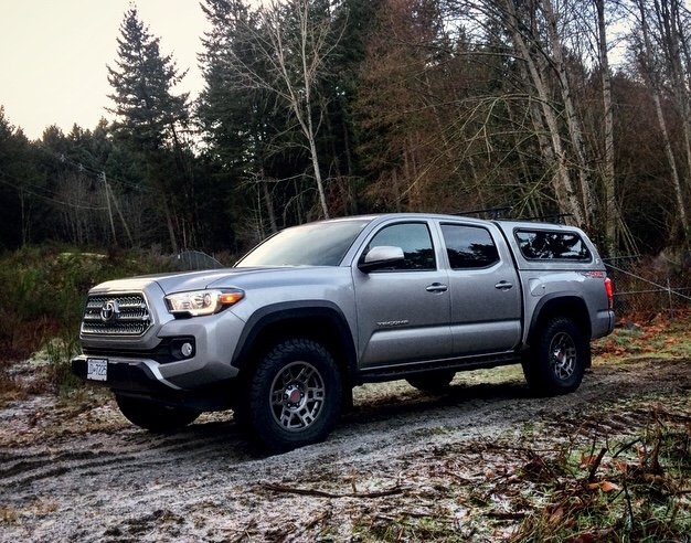

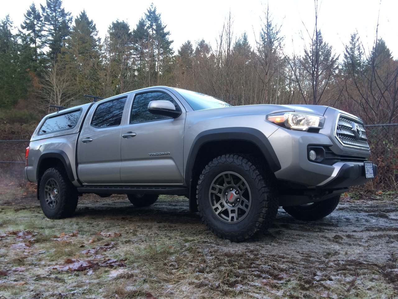

    #219125
    12,741
    17TRDORDCSBAT
    I did the grey as well. Nice!

    Is that a factory stance or is there a lift?
  16. Dec 22, 2017 at 9:20 AM
    #16
    Comb
    Comb Known Member
    Oct 27, 2016
    #200814
    1,834
    suspension is stock
