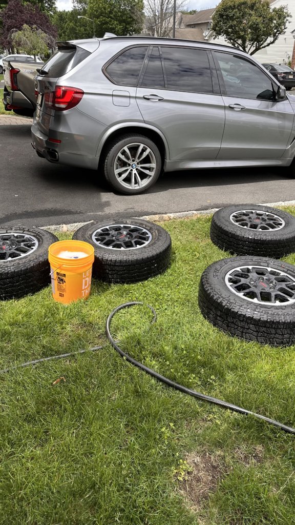

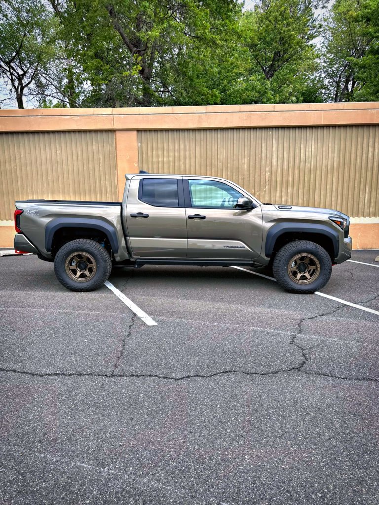

    Uggg you’re in Alabama… if you were local to NJ I would sell you my 18” wheels I took off my trd off-road hybrid at 500 miles. So practically new.

    So your aftermarket 17” wheels fit with no issues on the hybrid Off Road? I was thinking maybe the hybrid has bigger brake calipers or something requiring the bigger wheel?

    No issues.

    2025 TRD OR - Hybrid Bronze-Oxide, Premium PKG.
    No I don’t but those boxes would only fit 17” wheels. Mine is 18” with the tires still on the wheel. Each wheel+tire is 66 lbs.
    I just washed and tucked them away for now.
