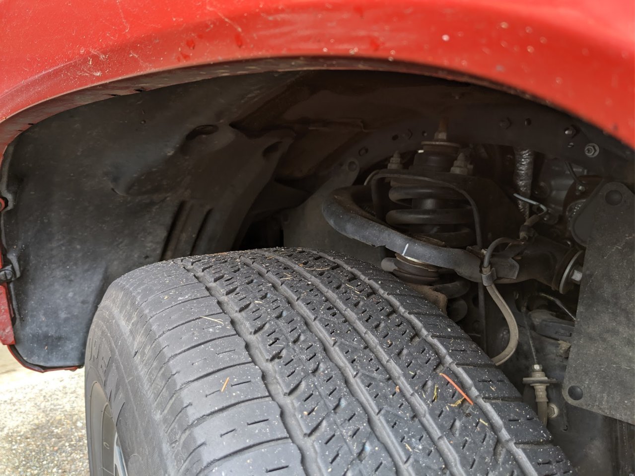

    It sounds like you have some miles on your Taco. With that, what does your tire wear look like?
    These were my stock Toyos at about 25k, just before I swapped them:
    I ran 35psi pretty much since new because I didn't like how soft the tires felt in corners. I'm running 35psi on the 265/70R17 SL Wildpeaks. They seem to be doing well at that pressure also, but I only have about 8,000mi on them. No wear to notice.
    There would be a bit of variability depending on how you use your Taco. I like to play in corners, so that pressure seems to work well for me.

    You have 24k on your original tires and have no wear? Best case scenario, half of the tread should be gone?
    If you have even wear at the mileage on all four corners, increasing the pressure for highway trips may wear the center, like you were thinking. Of course, additional weight on the Taco will play into that also.
