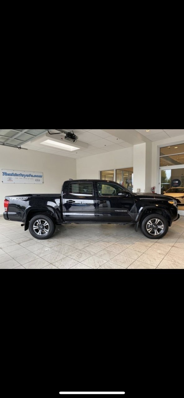

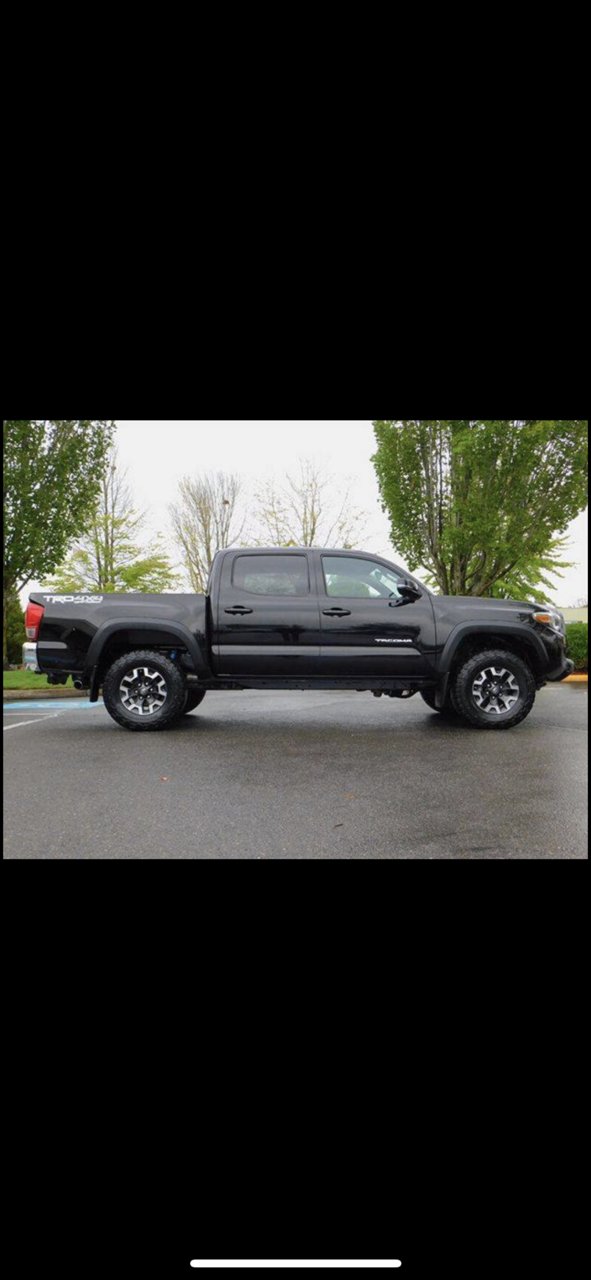

    Sup dudes,
    I am considering buying my first taco and was looking at the TRD OR and TRD sport with the MT.
    The only manual Tacoma’s that are in my area are years (2016-2017). In your opinion, would you rather have a 2016 OR with moderate mileage or a 2017 sport with low miles? I do like the look of the OR A little better, but all I need a truck for is to haul my trx450r and go up to the mountain for snowboarding a few times out of the year. Are the 2016s complete trash and should I stay away from them? Or am I safe with the MT.
    Thanks in advance!

    The OR that I am looking at has 70k miles and the sport has about 18k miles. Both are similar in price.

    If it was me, i would get the sport. Mileage is way better.

    No question there, Id go with the sport with 18k instead of 70k for the OR. That said, might provide some bargaining on the OR to get the price lower...

    I'd 100% go with the sport. Swap hood if needed, swap (or just buy) OEM OR wheels or even better pro or aftermarket wheels if you really care, and if you must you can get the fender flares in matte black but since the truck is already black then there's next to no difference with that. Remove and/or replace the bedside sticker if you really care, lots of guys remove, plenty of options for custom ones, I think on black it'd be nice debadged.
    Color keyed bumper is nicer than chrome (IMO) though you could easily swap with just about anyone if you wanted chrome caps.
    Then all the $$$$ for your mods and upgrades :)
    Mileage is for sure the difference.
    Unless you decide the locker is important just to have / for resale /etc. Though pretty sure you can add lockers after the fact for front and rear.
