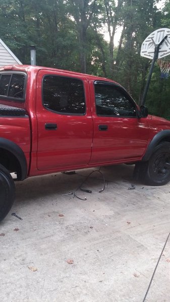

    Oh so you want a nice big lift. It already looks damn good. I could definitely see it with a 5-6 inch lift and 35s.
    Also, if you could get some more pictures of it, we could help verify its TRD status. It sounds like it is, but the lack of locker surprises me. Maybe it was optional, even with TRD? I really didn't think so.
