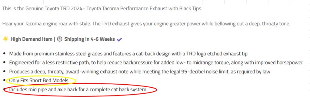

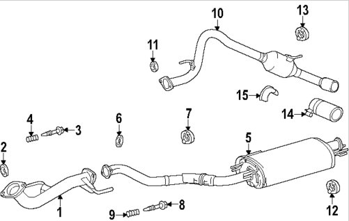

    Second, there is a TRD Performance Exhaust Black/Chrome Tip (PT226-35241, around $800USD) and a TRD Center Pipe (PT226-35240, around $1,000USD) which also is sometimes called a mid pipe. YotaGarage sells this as a package (no part # specified) for $2,099. CA dealers may be selling the combined part numbers as the TRD Performance Exhaust.
    What is confusing is that the OEM Tacoma exhaust has a front pipe, a muffler with pipe, and a tail pipe (#1, #5, and #10 below). The 35241 part number replaces the tailpipe (#10). If the 35240 part number (the center/mid pipe) replaces the front pipe, then it is way overpriced (the standard pipe is about $180). If 35240 (center/midpipe) replaces the muffler with pipe, that would seem about right. The TRD Pro uses the same muffler and pipe (#5) as all Tacomas, only the tail pipe is different.

    Thanks for all this info. Yes the price is $2125.00 CDN Dollars,not sure if that is mid pipe and tail pipe. I guess why it is only available for the short bed is the mid pipe would be a different length for short or long bed. But I guess we might be safe in assuming the twin tail pipe only,is compatible with both long bed and short.
