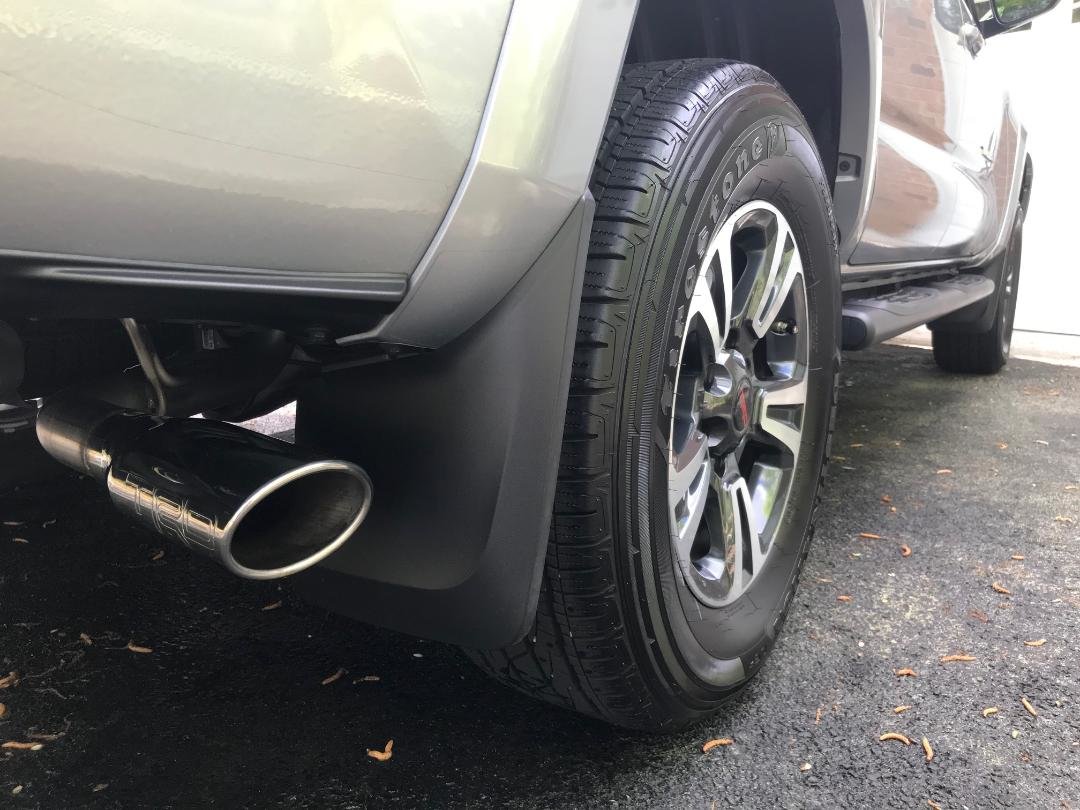

    I installed the TRD Pro cat-back exhaust on my 2018 and though pricey, I'am very pleased with it. It isn't just LOUD (as in no muffler) like some after-market exhaust but it's got a very deep throaty tone.
    It doesn't increase HP but does give the illusion of more power.
    It took me about 40 minutes (by myself) to change mine on the ground (no jacking needed). I call bull-shit on anyone who says they can do it in 20 minutes.
    Installation Tips:
    • Soak your flange bolts and rubber hangers in WD40 the night before you are to do the work.
    • Tape paper or cloth padding around your exhaust tip for protection. If you don't it will get scratched up.
    • The most time consuming step for me was routing your new exhaust around the axle. I recommend laying your new exhaust parallel to the axle and then basically turning/wrapping the front end (curve) around the axle while turning the tip end out the side as you go.
    I don't believe you have to worry about a warranty as the TRD Cast-Back is all stainless and should last a very long time. It actually weights about twice as much as the OEM exhaust you are removing.

    looks good man, but don’t call BS on the 20 minutes just because it took you twice as long. It’s one piece with two bolts and a few hangers.
