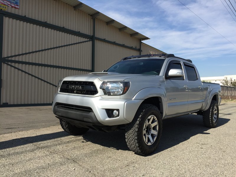

    Hey Dropitmore - your truck "looks" level from the angle of the photo. It's cool, obviously not stock. Adding a spacer is going to make the ride a tad rougher. Just sayin'.
