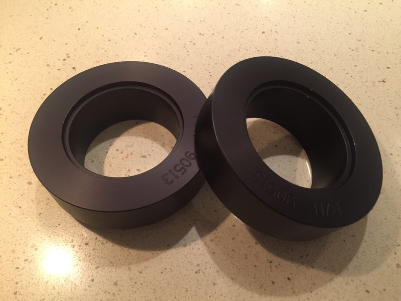

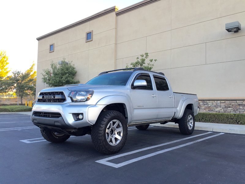

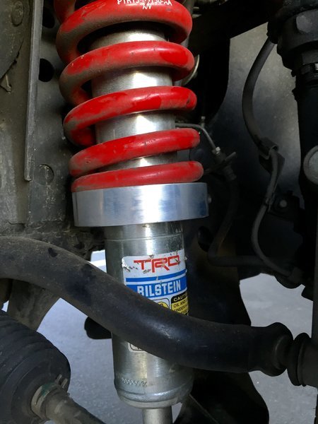

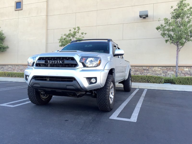

    What a difference. Very happy with the results. The seat spacer firmed up the front suspension equally to my rear set up. My handling has improved on the streets and my trucks stance is close to level. Completely satisfied. Curious to see how it will perform on the trails. Should know during my Big Bear trip in 2 weeks.
    The only downside to this experience was I received the wrong color spacer. I originally ordered anodized black but ended up getting aluminum. Not a big deal and Toytec plans to refund me the difference so all is good there.
    Enough talk, here are some pics. I'll take some better ones soon.
    Ignore the crooked skid plate, missing a bolt.

    Truck's looking good!.....Was waiting for your response on if the spacer stiffened up the coils. Thanks for posting, was getting nervous after reading the few posts before yours as i wasn't sure if i was going to add the spacer or not but def will now. Mines not a daily driver and see's mostly pavement but having the front end dipping in turns isn't what i want....Now i need to get off my ass and get this lift installed!.........2 questions though if you don't mind, 1) did you install the spacers yourself? and 2) are your tires in the pic's still the 265/70/17?
  11. Sep 13, 2016 at 11:12 AM
    #371
    Dropitmore
    Dropitmore Panda Man
    Feb 16, 2015
    #148835
    1,995
    Andy
    Downey, CA
    2013 TRD McDouble Cab
    Mall Crawler Edition
    Thanks, appreciate it.
    To answer your questions:
    1.) No, I had a shop perform this. I dont trust myself disassembling the coilovers without killing myself lol. They knocked it out, including alignment within 1 1/2 hours.
    2.) Yes you are correct, they are BFG KO2s 265/70/17
    Hope this helps everyone.

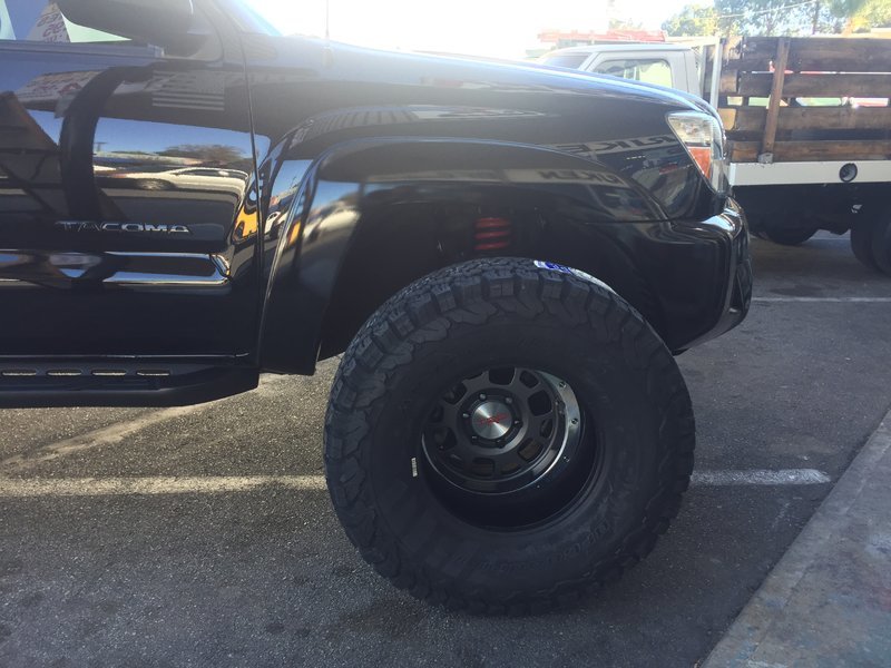

    Installed the front spacers today, and the truck looks awesome. Sits almost perfectly level. With the spacers and the AAL, with a tape measure off the floor to the fender, 1" exactly higher in th rear. Now to get my 285's, truck is gonna look WAY higher!

    Got any photos?

    2013 BAJA w/ too many mods
    Too many to list

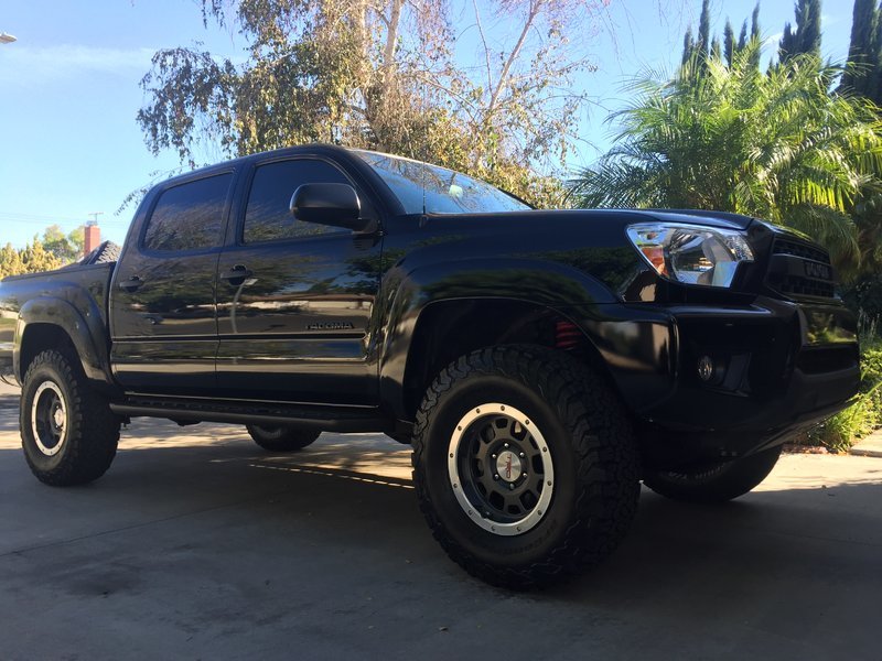

    Got the 285's installed today, and they're awesome!!

    Love the black.
