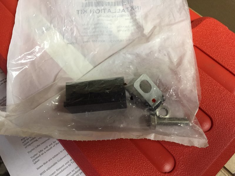

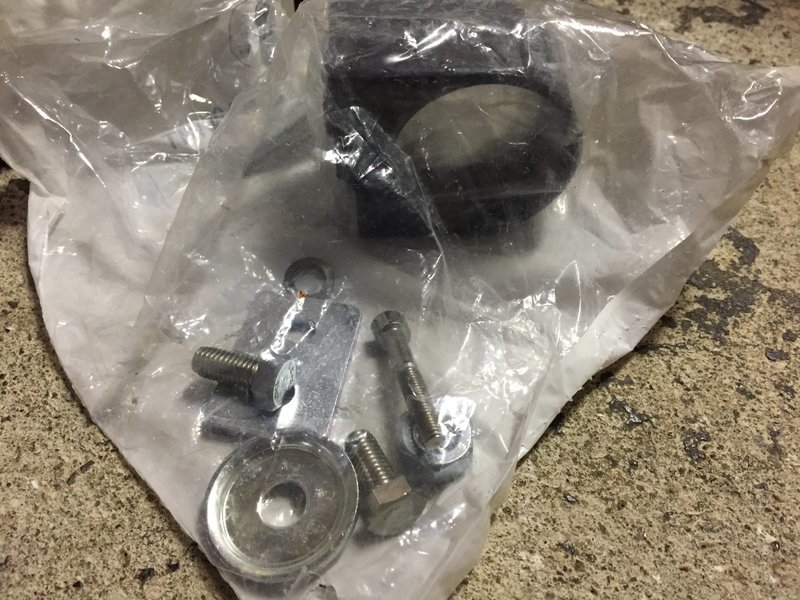

    this is the hardware that came with my PRO kit:
    Brake line spacer and brake line clip (for the rear)
    reservoir brackets for the rear shocks(1 package for each shock, 2 total)
    no front or rear bump stops

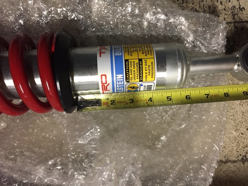

    @JuanitoBunito .....I measured from the bottom of the lower perch to the end of the shock and it's 6" on the drivers side and 5-3/4" on the pass side so it 's the stops (for the lower perches) on the shock itself that that actually fix the taco lean...Pic is the drivers side, pic angle isn't showing it correct but it's actually 6 " there.....

    Thanks. Same as what came with mine. The descriptions were obscured on the package so didn't know exactly what the brake line spacers were. I'll take another look and see if I can figure it out.

    Check out the "bajaTXPro" thread by crashnburn80. Theres an excellent write up in there and a pic of the brake line spacer installed...
    QUOTE="syswalla, post: 14754601, member: 162191"]Thanks. Same as what came with mine. The descriptions were obscured on the package so didn't know exactly what the brake line spacers were. I'll take another look and see if I can figure it out.[/QUOTE]
