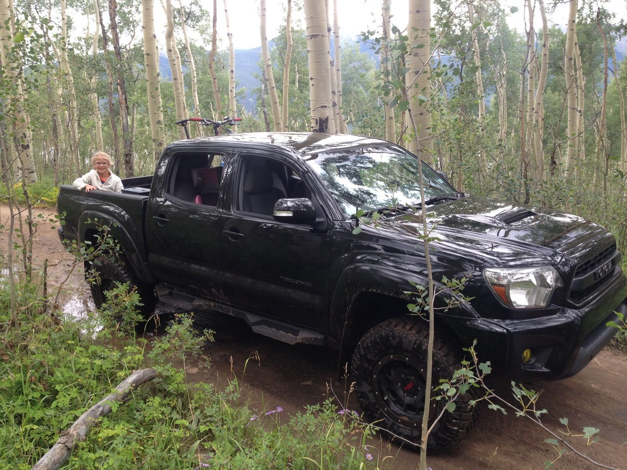

    thanks. Are they 285s? and do they rub? Looks like you painted the beadlock?
  2. Aug 21, 2017 at 8:49 PM
    #442
    hack4875
    hack4875 1 of 377
    Mar 22, 2014
    #125905
    1,769
    Steve
    Colorado Springs, CO
    2015 TRD PRO Supercharged
    Nope, 265s, so of course no rubbing. Yes, I had the beadlocks powder coated "Triple Bronze".

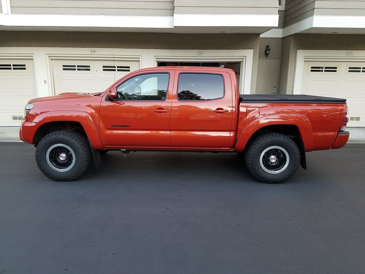

    I think I asked @JuanitoBunito this before but I want to make sure I understand AND get the results that I'm looking for...just to recap.....
    I just bought a stock 2015 TRD PRO with 23,000 miles and want to "correct" the rear squat cuz it just plain bugs me. I measured the center of the front hub to the bottom of the fender well and it measures 23" and I did the same in the rear and it measure 22.50" which means the rear squats 1/2". I measured with the bed empty except for the Extang Solid Fold 2.0 tonneau cover. The only thing I've done so far was install new BFG KO2 265/75/16 tires.
    I was think about installing the Toytec 1" Front Lift for BAJA TRD Tacoma's, TRD Pro Edition Tacoma and 4Runner......http://toyteclifts.3dcartstores.com...JA-and-Pro-Edition-Tacoma-4Runner_p_1065.html which would raise up the front 1" for a total of 2.75" as well as installing the Toytec Progressive 3 Leaf Add A Leaf Pack WITH the stock overload which would raise up the rear 2.5". If I do both of these then not only will the truck be raised up but it also should be pretty level right?? I think this slight lift should look great and if it almost levels the front to back then my OCD will be happy! but.....20171109_162406_resized.jpg If I leave the stock overload leaf in will it ride like crap?
    Also, what is the difference between the Toytec Progressive 3 leaf add a leak pack and the Icon 1.5" Progressive AAL-51100? Is it worth the additional cost for the Icon AAL versus the Toytec ones? I want to keep the stock shocks in back and also I want to keep the stock coils and struts in front. If I install the Toytec 1" front lift spacer and the 3 leaf progressive aal do I need to change the stock front struts or the rear stock shocks? and do I need extended SS brakes lines for the front and/or back?
    or should I just simply install an AAL in the rear and leave the front alone???
    please help me make the right choice!! ;-)
    here's a current photo of my truck
  15. Nov 9, 2017 at 10:30 PM
    #455
    JuanitoBonito
    JuanitoBonito Que Pasa
    Dec 29, 2013
    #119422
    9,194
    Juan
    CHI-TOWN
    2024 Raptor
    You are dead on...putting the 1” toyotec specific Baja/pro spacer and the progressive aal w/overload was what I was going to do to raise it.....with a level stance.
    When it comes to the progressive aal’s.....I have icons and have heard the wheelers one is the same. That being said, I’m certain toyotecs is very comparable as toytec makes great products.
    You won’t have to change the front coil overs as this spacer is made specifically for our trucks. You won’t need extended brake lines either as you you really don’t need them until you reach 3” in height .....and that’s still only if you plan to offroad due to flexing your suspension to its limits.
    One last thing, leaving the overload in will only make the rear red a tad stiffer......nothing that would stop me from leaving it in. :thumbsup:
    Hope this all helps.

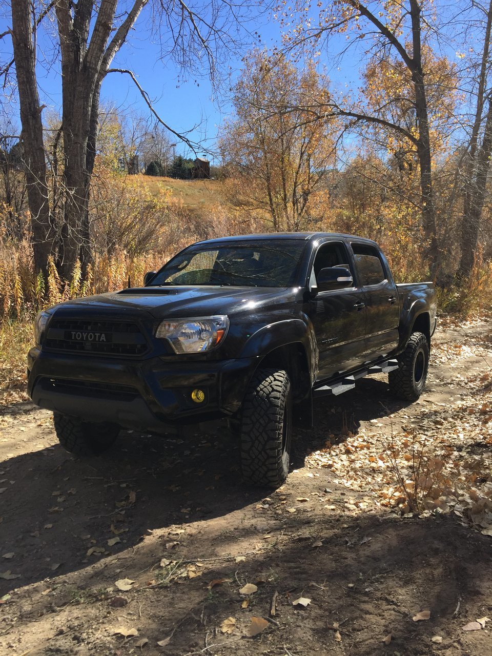

    Here is mine with the 1” pro/Baja spacer and the rear icon progressive AAL. It sits pretty dang close to level. I did NOT leave the overload in. Ride is comparable to stock. I love the way it sits. I am running 265/75/16 duratracs.
    Sorry the pictures suck but that’s all i have on my new phone.
