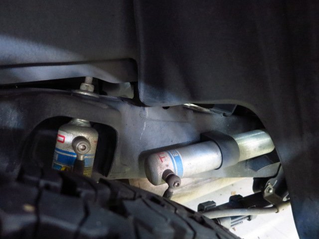

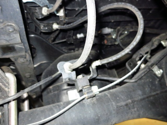

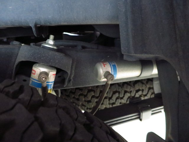

    Question for folks who have done the install as mine didn't come with instructions. The front seems fairly straightforward, but for the rear where did you mount the remote reservoir, as well as the various brake line spacers? Want to make sure I don't screw anything up.

    Here's how I have mine installed. Driver's side resi goes on the frame rear of the shock. Passenger side resi on frame in front of the shock. Third pic includes the brake line spacer.
    Driver's side
    Passenger side
    Brake line above driver's side axle housing

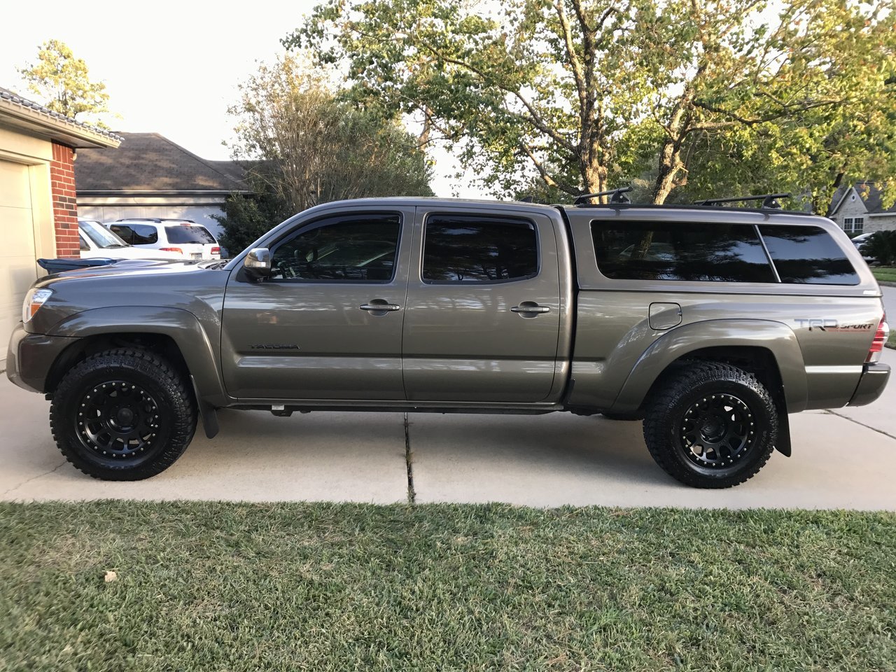

    Just ordered a kit as well...hard to pass on $640. I'll be putting it on a 15' Sport DCLB 4x4, will be doing an icon/wheelers aal as well. I run a camper shell so I'll probably be keeping the overload in.
    1. Will I need anything else that is not provided in the kit for install? Bump stops?
    2. With the AAL+ overload will I still retain a decent amount of rake?
    Any thoughts/opinions appreciated. Thanks

    You don’t need anything else .......unless you want the front end a little higher. You can replace the spring seat with the 1” toytec specific one. This will get you from 1.75” to 2.75”. Or you can just raise up 1/2” to 2.25 by adding top plate spacers like I did.
    For the rear, you can remove the over load leaf or keep it and raise the rear a little higher (1”) but it’ll be a little stiffer ride.
    If you just install the lift and remove the overload, you will retain a small amount of rake....
