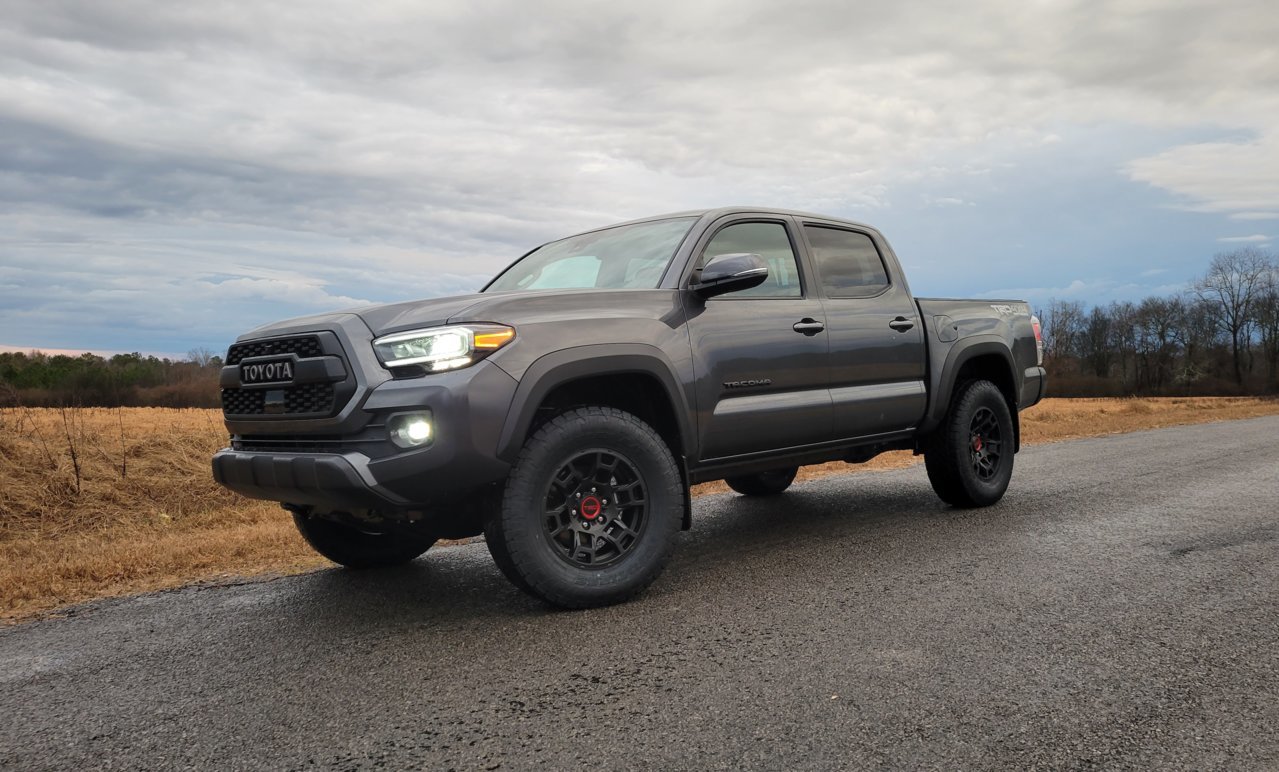

    I had my PTR56-89210-F2 wheels mounted today and not aware of any issues up front. I had to do a pretty significant bevel(more than 1mm) so the wheel would remove freely. I HIGHLY recommend doing this before you mount the tires on the wheels. It took a good bit of trial and error before I called it good. Also, protect your wheel studs. I've very good with a 4.5" angle grinder and end up with a few gouges on my studs. 1/2" PEX works awesome.

    Also, Dr. Beasleys Wheel Seal seems to do a good job helping keep these clean. Despite what pictures show, the OEM finish is more matte than what I expected. It's very smooth though and a sealer helps keep smudges and grime from setting in.
