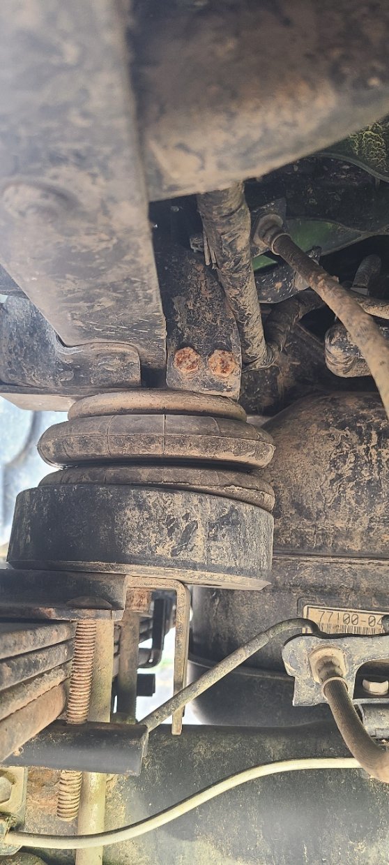

    Got ahold of a used TRD Pro a couple years back and one issue has always bothered me; while great off road it is absolutely BRUTAL when just driving around and hitting minor bumps.
    Digging threw forums they all suggested one of the following:
    Lower PSI in airbags (tested, mild/no difference)
    Lower PSI in tires (lowered, very minor difference)
    Put 300 pounds of concrete in the back (Did 400 pounds, helped some but not worth the weight)
    Assume the person has never driven an unloaded truck before (this is my 5th)
    As none of that helped, I tried to go a little more technical and look at what I actually have:
    I have the upgraded Canadian leaf springs.
    I have airbag suspension
    Looks like they had a camper on previously as electrical is ran to the top of the bed railing + bed stiffeners.
    All of this seems to suggest to me that he had the rear end setup to hold a LOT of weight.
    So, I dove in even further and am now under the impression that what I'm running into is some type of 'internal' bump stomp INSIDE the airbags and that this makes your truck bottom out insanely easily (the 'harshness' that I'm feeling)
    I'm going to pull them off later today... if this doesn't work I'll take it to some friends to investigate but with a newborn I just don't have the time to chase all this down.
    Any other ideas to check for are welcome.

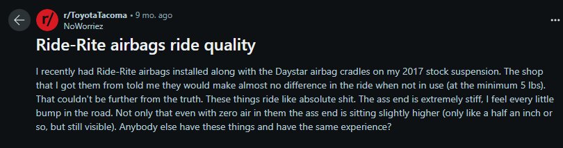

    I'm pulling off the airbags on my 23' Off Road due to the harsh ride over uneven pavement. I'm putting on Active Suspension.

    Leafs look pretty flat. Might be riding the bump stops. Where are you located? Want to sell the airbag setup?

    It looks like your leaf springs are completely shot, or was that picture taken with 1000 pounds of cargo in the bed? You might actually try airing them up higher so you actually have some suspension travel, as it appears you have zero up travel currently.
  16. Jun 18, 2024 at 3:42 PM
    #16
    BigCarbonFootprint
    BigCarbonFootprint Well-Known Member
    Nov 25, 2019
    #311686
    233
    Andy
    2019 TRD Off Road
    King Racing 3” lift
    ^That^ above is a terrific observation. Good catch.
    I agree, something is quite probably off with the geometry and suspension travel.
    And, perhaps this is an optical illusion, but that leaf spring bolt looks wonky to me.

    :rolleyes: the rear bolt that appears wonky is likely the Daystar cradle bolt, not u bolt.

    I agree, those springs look weak. I thought it was odd that the truck was level with upgraded springs, this would explain why. My guess is once the bags are removed the rear might sag a touch if its not already on the bump stops.

    looks like firestone airsprings, which do not have internal bumpstops.
    and as that setup eliminates the stock bumpstops but decreases uptravel significantly, you are basically bottoming out the airsprings constantly which is terrible for ride and longevity of the airsprings.
    more pressure will gain you some more uptravel which could help

    it's the airbags. if you dont need them, remove them.
    i know several people with airbags for towing (all different types of trucks) and they all confirm that airbags, when not towing, make the ride quality trash.
