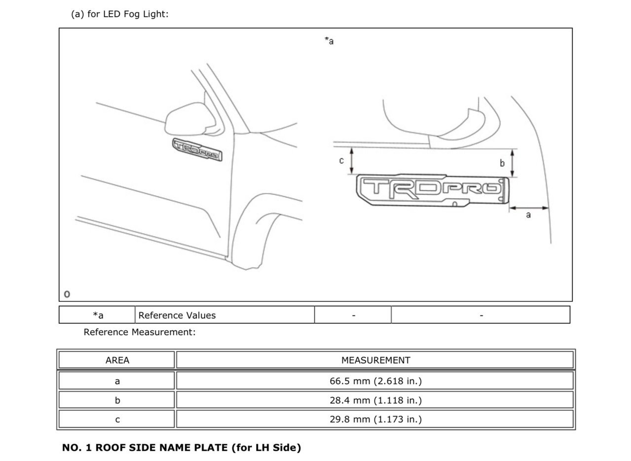

    Anybody have the diagram that shows where it’s supposed to go?

    Careful the diagram is slightly off with it's measurements.
    It says about an 1" from the mirror's line, but that would put the badge right on the doors body line.
    It is suppose to be about an inch from the door's body line.

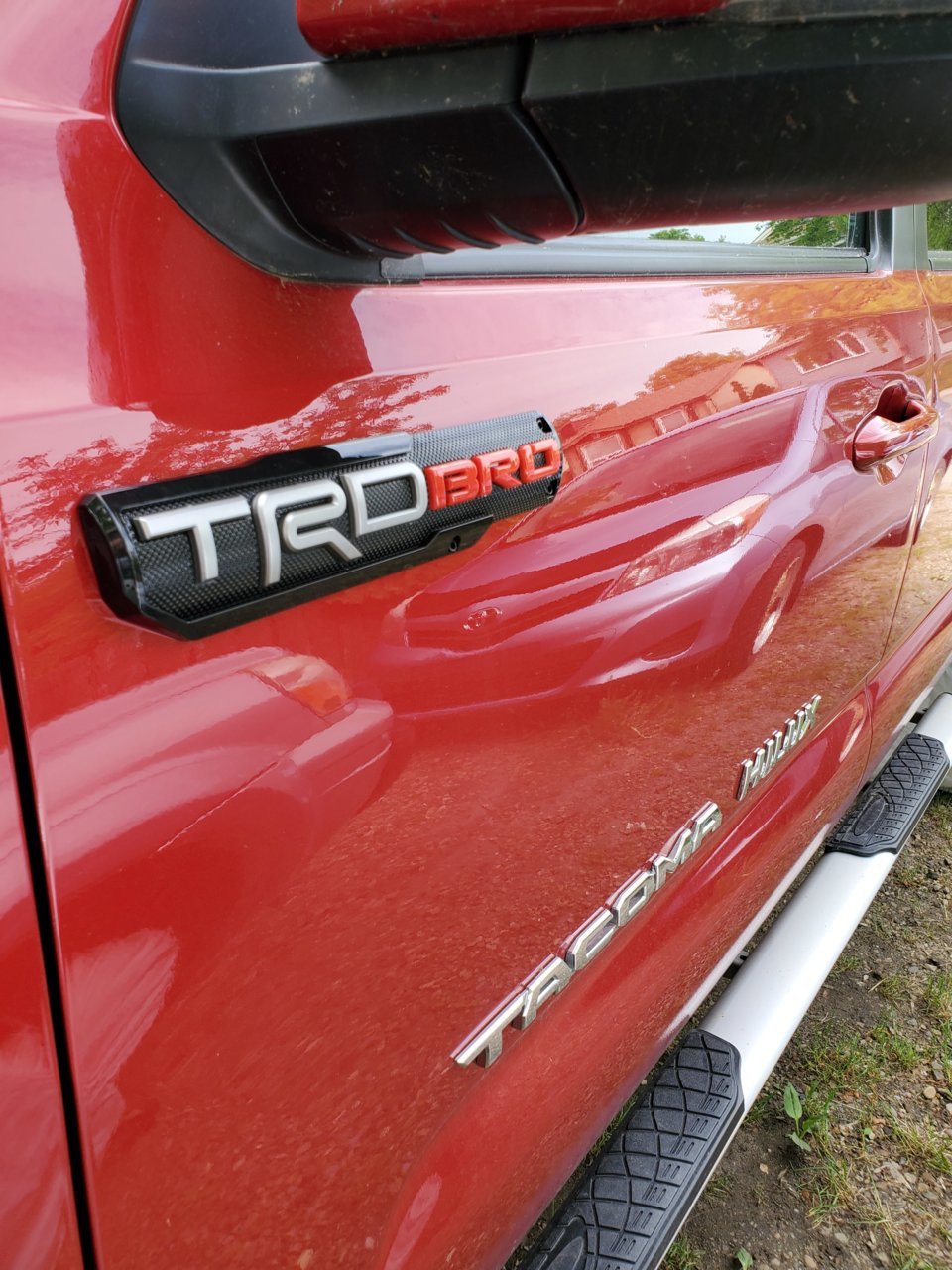

    It's so funny I love it...

    Some of us do it right then you have ppl like this lol

    Is it something wrong?...remember we are all different

    Nothing wrong I would just have done it differently man.

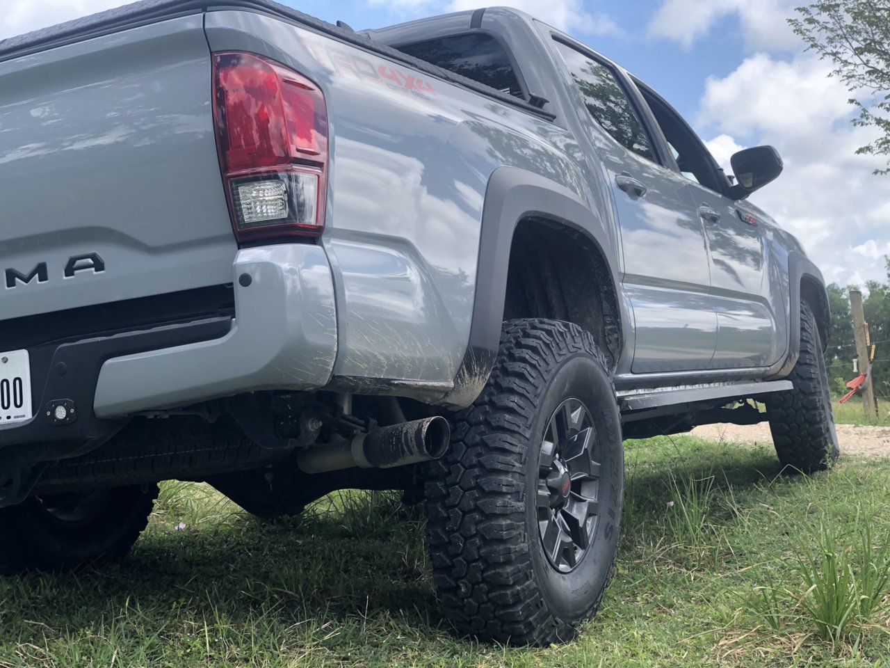

    There is no measurement specifically for the TRD Pro emblem on the tailgate.
    But it would be the measurements for the 4x4 emblem mirrored to the passenger side.
    Its somewhat odd, cause from the factory the 4x4 and V6 side measurements are switched when compared to the measurements given in the pdf.
    Are you badging your TRD Offroad with TRD Pro badging?

    I went based on the picture. Looks good lol

    Been sitting here measuring over and over and reading this post scratching my head. Glad someone else thought the same thing I did.
