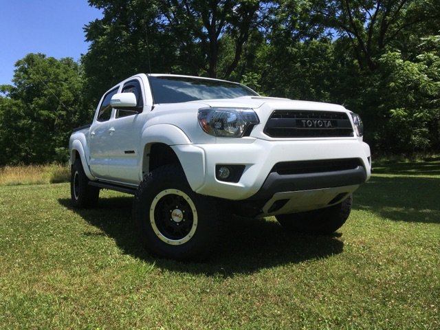

    That's a great looking truck. I bought my 2015 TRD Pro with 21k miles on it, swapped out the bilstein suspension for a set of icon coilovers and couldn't be happier. You'll get some coin for that stock pro suspension as well, so sell them and you'll recoup half your money on the icons.
    Edit:
    The icon comes with a 650lb spring rate - the pro (I think) is around 590. That will solve your "bouncy" ride. Nothing wrong with the bilstein reservoirs in the rear, so keep them and add a 3 leaf progressive pack from @HeadStrong Off-Road and you're done.
