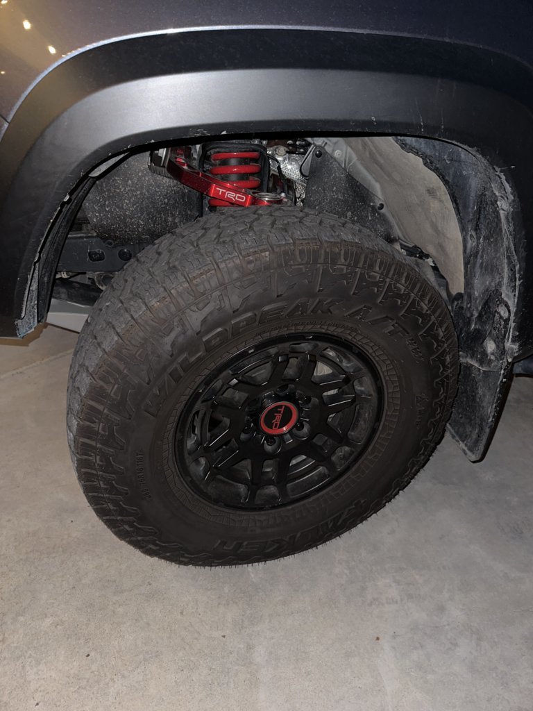

    Falken Wildpeak 265/75/16 on my ‘22 Pro. Fit fine no rubbing at all. My truck rides so nice, I am not going to mess with any of the suspension.
    I have read that the red UCAs actually give you less room. Apparently 285’s are no go with the shiny red UCAs and stock offset wheels. The tires will run the UCA.

    I went with 265/75/16. Plenty of tire for the type of off-roading that I do and no rubbing.
