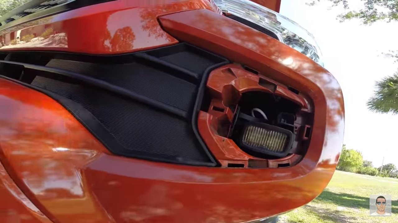

    That's how the rigid light sits without the bezel in place, I bet the bezel wouldn't even snap in with the regular fog light.Screenshot_20180821-102512.jpg

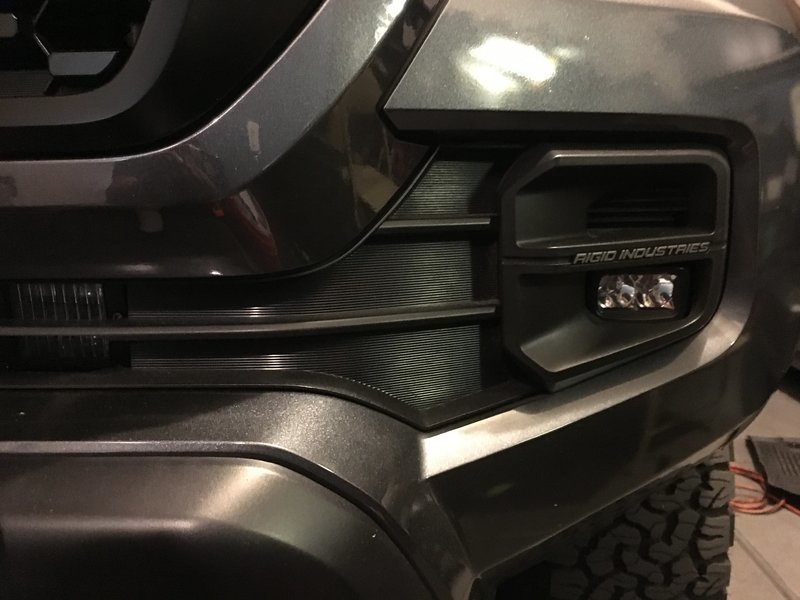

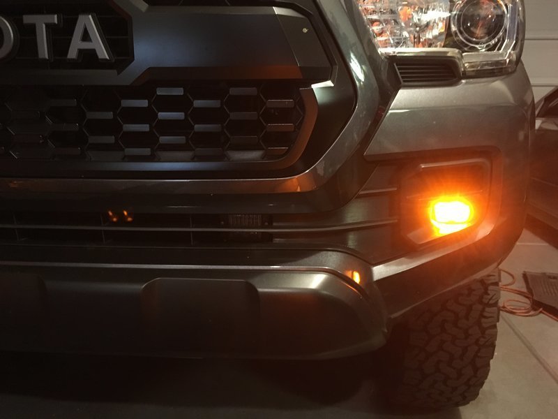

    I did this a few years ago just have amber light up front.
    Lamps were Amber SRM mounted to a 19W OEM fog light bracket.

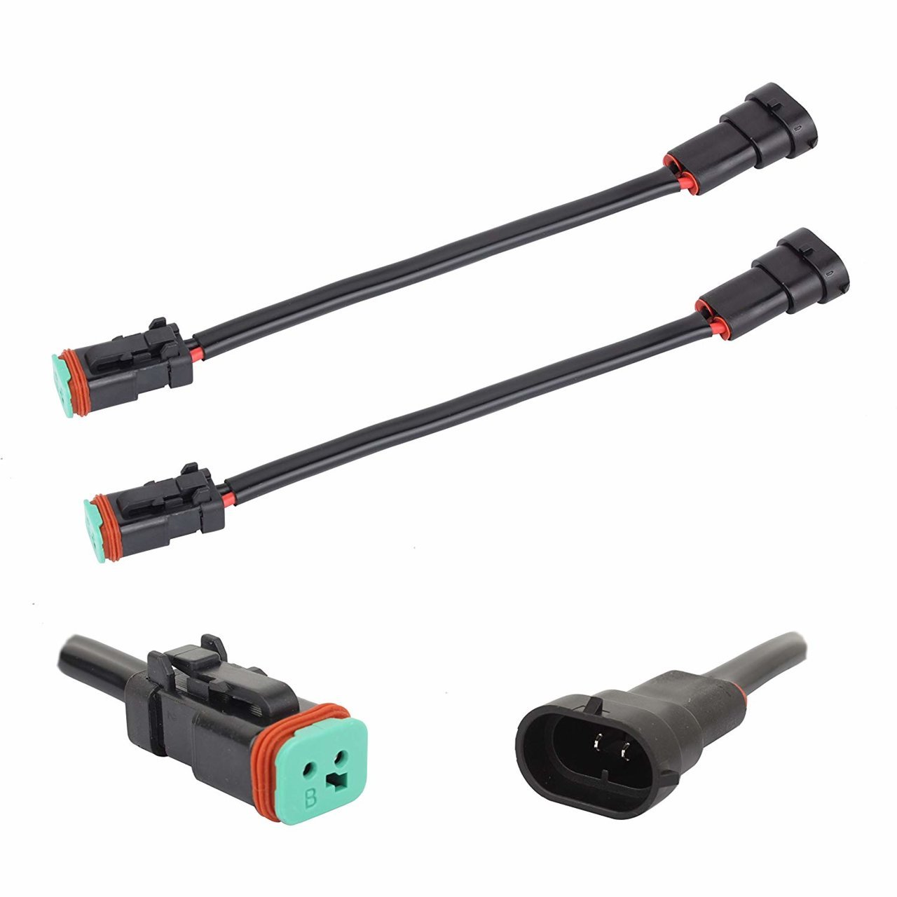

    Hey man so you connected the rígid plugs into the OEM fog lights plug? Or you did something else?

  8. May 11, 2019 at 7:33 AM

    Exactly this one here shown in the picture?
    Siblue[QUOTED] likes this.

    25 Tundra TRD pro
    Yes

    How do you guys manage tu put the light in the bracket?

    How did you manage to do that? I'm in the same path.

    Easiest way another member has done is use Rigid 46566 kit without ugly face plate, using OEM Rigid shroud.
    Other wise source a set 19W plastic lens OEM fogs to rig up the SRM
