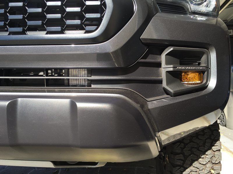

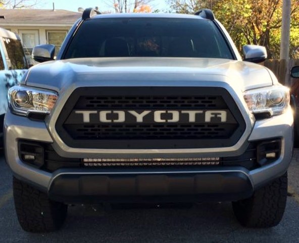

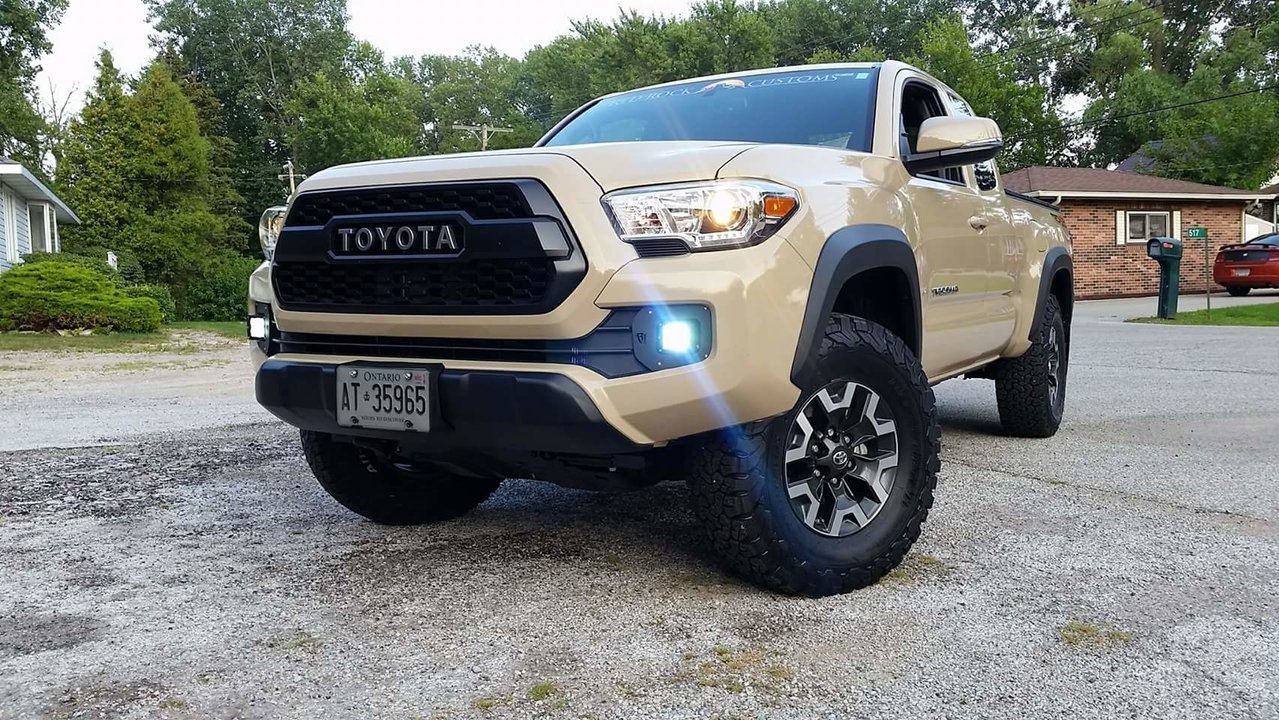

    I’ve done this mod twice. SRM are not direct fit. I rigged up OEM 19W fog brackets to make it work.
    @jwilson2899 simplified this mode using the above mentioned mounts.
    The all white was too much for me.
    Here are my 2 attempts.

    Are you using the trd pro brackets or what? Is there a thread explaining this?
  5. Feb 4, 2018 at 12:50 PM
    Siblue
    Siblue Well-Known Member
    Dec 2, 2014
    #143489
    3,159
    So Cal
    25 Tundra TRD pro
    Did not used pro brackets as they aren’t cheap to destroy. I used 19W fogs from my 4Runner or you can source 3rd gen SR5 or Limited to rig them. The other member perfected the mod with Rigid mounts.

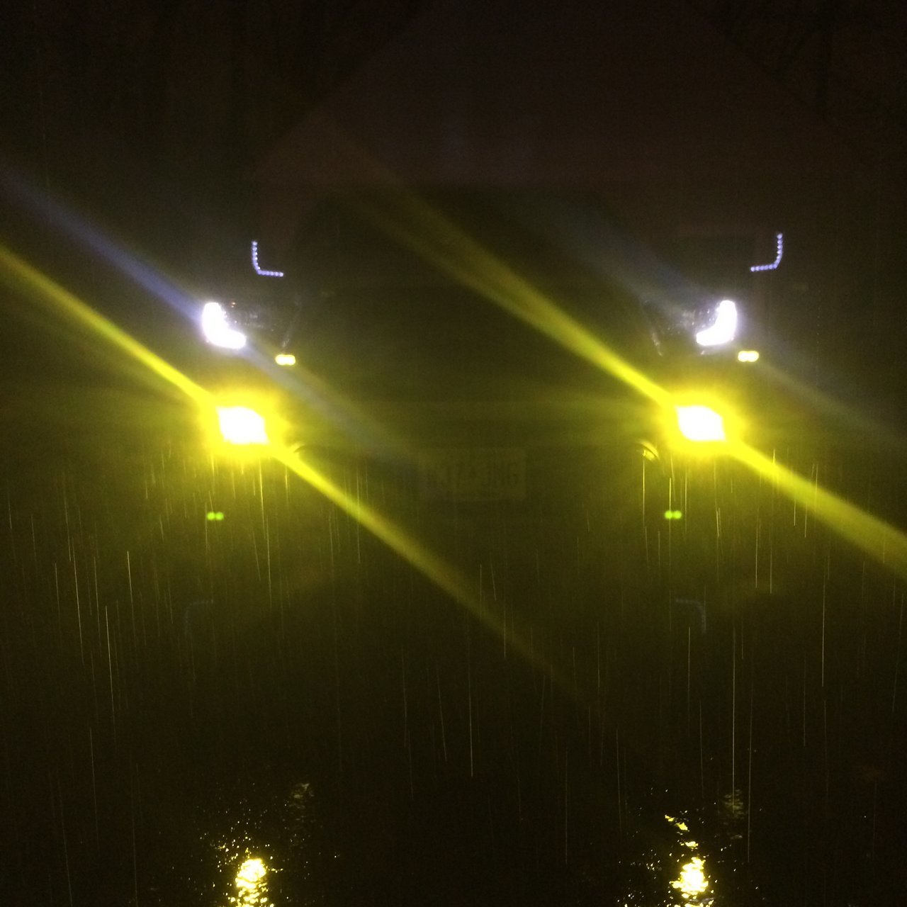

    Not my photo but I have the same as what's shown in the top photo from Siblue. The bottom photo appears much deeper orange than how mine illuminate so there might be something different going on there. With just the yellow lense cover they shine a bright neon-like yellow.

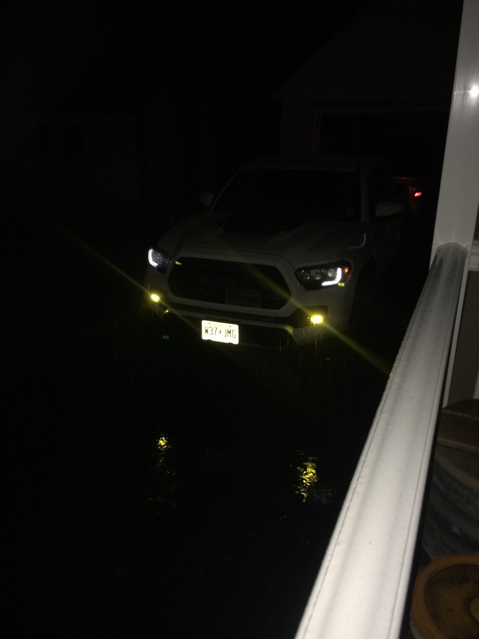

    My first attempt at pictures, so no guarantees...
  15. Feb 4, 2018 at 3:11 PM
    blown ION
    blown ION Well-Known Member
    Jan 26, 2018
    #242492
    121
    NJ
    2017 TRD PRO White
    Second one because it worked...
