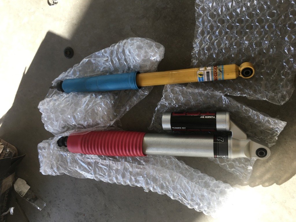

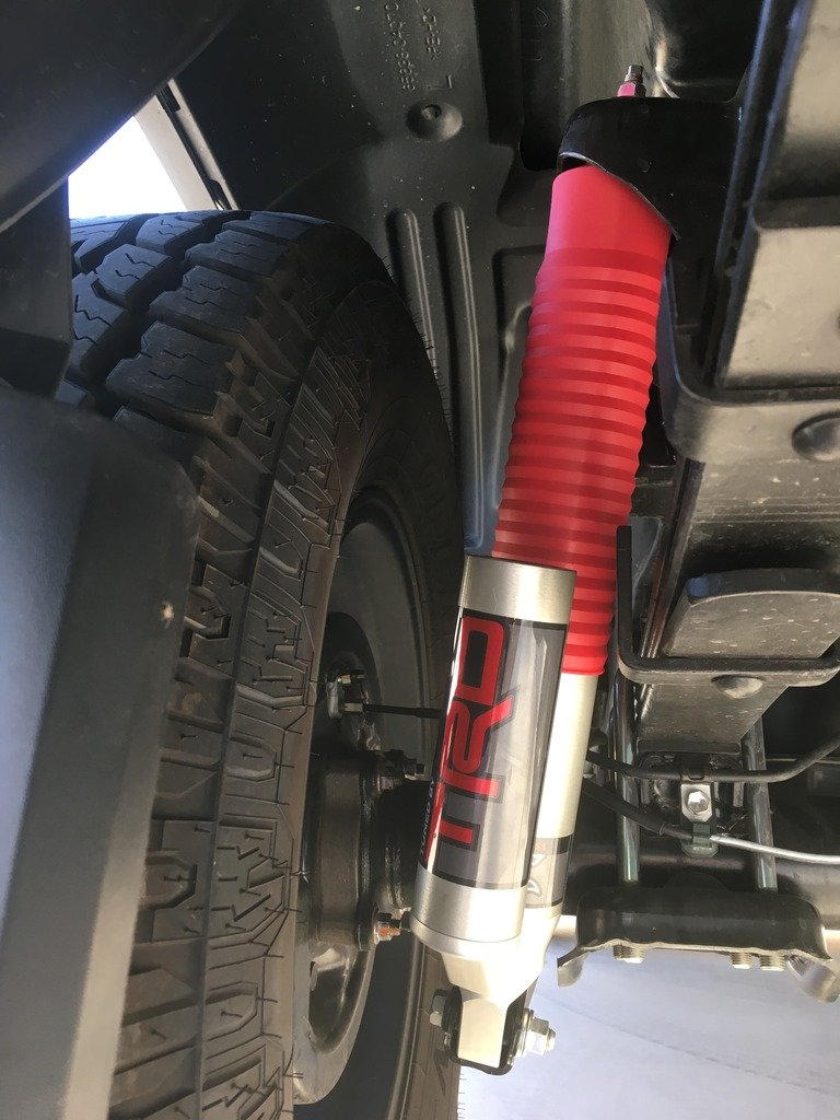

    just added the rear TRD Pro Fox rear shocks today, now both front and rear are done
    I updated the first post to also include these rear shock pictures, I'll take an updated side shot of the truck tomorrow

    After installing the rear shocks, are you seeing a 1 inch lift in the rear like on the front? I'm guessing you did as it looks like there is still a little rake on the truck. I was curious about this because the TRD Pro is 1 inch taller in the front and rear but they use the same leaf springs as the TRD OR so the lift must come from the shock itself. Is that true? Also, what's the overall ride quality now with the Foxs all the way around? Compared to the Bilsteins?

    I didn't do a before and after measurement in the back after replacing the shocks but it does appear taller. I did take before and after measurements in the front after replacing the shocks and did get a 1" lift. The truck rides so much better and feels more solid adding the TRD Pro snocks, no comparison.

    I don't mean to reign on your parade. No hate here, seriously. Just so you know though, those TRD pro Fox rears are literally just rebadges with red dust boots over them whereas the Fox's have a bare shock shaft and are full silver with black markings on it. They are still nice regardless.
    I hope you didn't pay too much for them. I had those exact same ones on my truck at one point, but didn't like how the fixed resi was mounted to the bottom of the shock not the top. If you like to go wheeling those resi's could become a potential damage point, which is why I opted for a remote mount resi version direct fit (not an advertised OE fitment) on mine.
    Back when I first installed them. I believe it was the only picture I snapped of them at the time. The shaft faces upwards into the upper shock mounting point.

    I can't see how the rear shocks could lift the rear of the truck. Since no measurement was taken, I inclined to think there was no additional lift. Since the truck has a notable rake, I think a 1" lift in front would push it more toward level (like a leveling kit).
