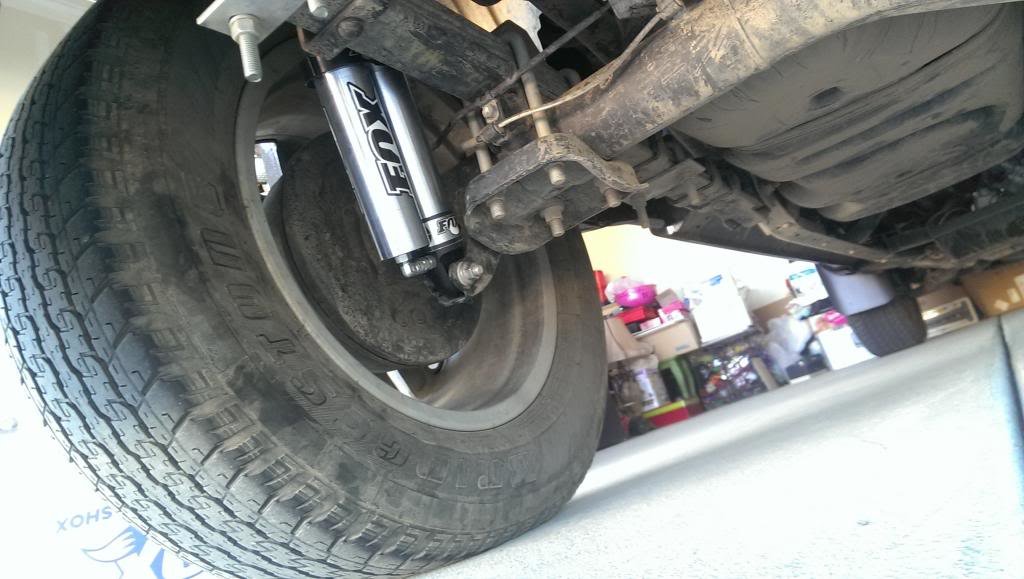

    I was really impressed with the ride when just the fronts were replaced, lean and dive control were better.
    The rear Fox shocks have a stronger charge than the Bilsteins, I didn't take a before or after measurement in the rear so I can't confirm.

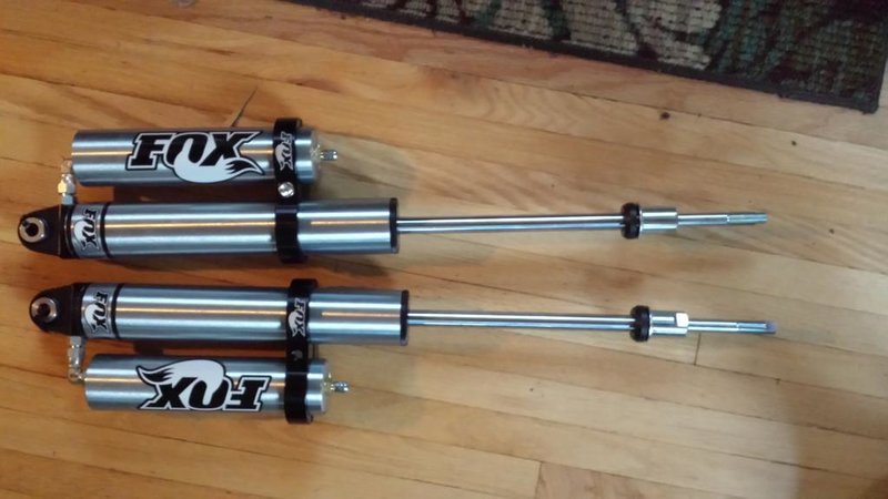

    OK I guess that could add a some lift, though I've never heard of it mentioned. It seems like an easy way for Toyota to lift the rear since they can keep the same springs.

    The shocks in no way are capable of lifting the vehicle unless they are coilovers by design. The lift would only be achieved by using a thicker spring pack or by utilizing extra leafs.

    That was my thought, but if they really had high gas pressure, I could see how they could generate some lift. Taken to extreme, you have those nitrogen charged setups that have no springs at all. Without evidence, I can't say it's true one way or another.

    After installing the TRD Pro Fox shocks, the rear wheel well height centered on the axle is 37.750", keep in mind I have 265/70/17 tires. I am not sure what the factory height was, maybe someone with a stock OR can help out here.

    The only time something would be a factor is if you had air shocks like some of the Jeep's are retrofitted with. Lift is not generated unless there is something of physical height, be it blocks or additional to thicker leafs set in place there. For trucks with springs like the 4Runner's, taller coil springs. Gas pressure affects the valving and how the shocks behave more than anything else. It is there to simply keep the oil inside the shock bodies from caveating or frothing up when the shock is being worked.

    This is incorrect. While valving is different, it is a completely different shock design. What you have shown is a remote reservoir shock with a internal flaring piston. It has a single piston for the entire stroke of the shock. The trd pro foxs are a internal bypass design. This allows for the shock to be tuned differently depending on where it is in the stroke, which when tuned well makes a world of a difference. Have you ever seen the smaller tubes coming off a high end (non coilover) shock on a long travel truck? Those are a externally tuneable bypass design. This is the same thing, just fox and Toyota tuned them so they are able to put all those tubes inside the shock body. Basically they can resist bottom out in a much more controlled way, not rebound too quickly deep in the stroke, be very active off the top, etc.

    Oh shoot. I totally forgot that Fox has internal bypass design integrated into their shocks now on certain models. Well hell if it has it then more power to Toyota for utilizing this design. It makes me wonder what their valving is geared towards.
