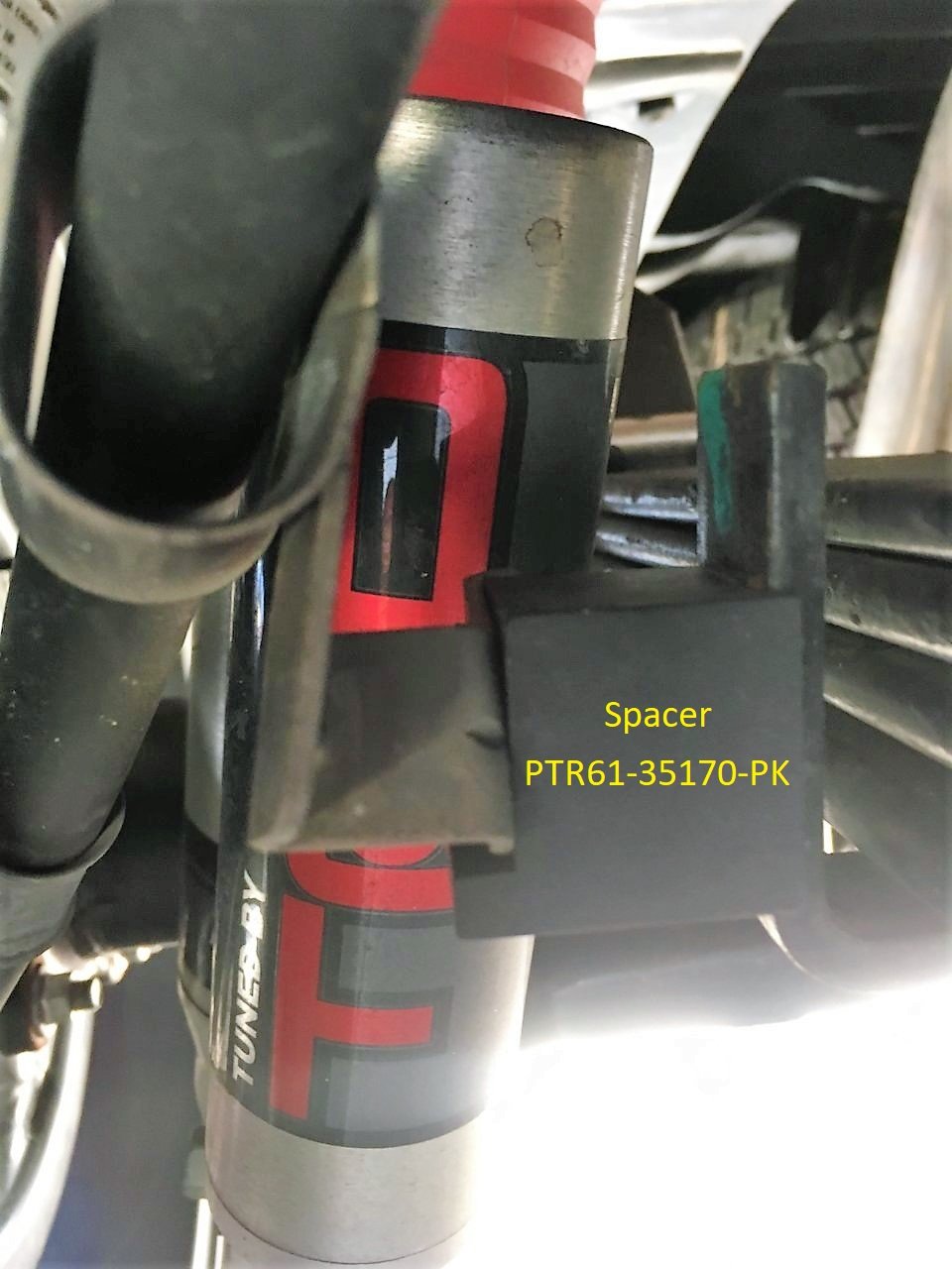

    I was just about to tell you that the part # and orientation is printed on the external bypass, bottom. Did you get the pbk spacer for the passenger side?

    TRD Pro Tacoma Pkb Bracket Toyota (PTR61-35170-PK)
