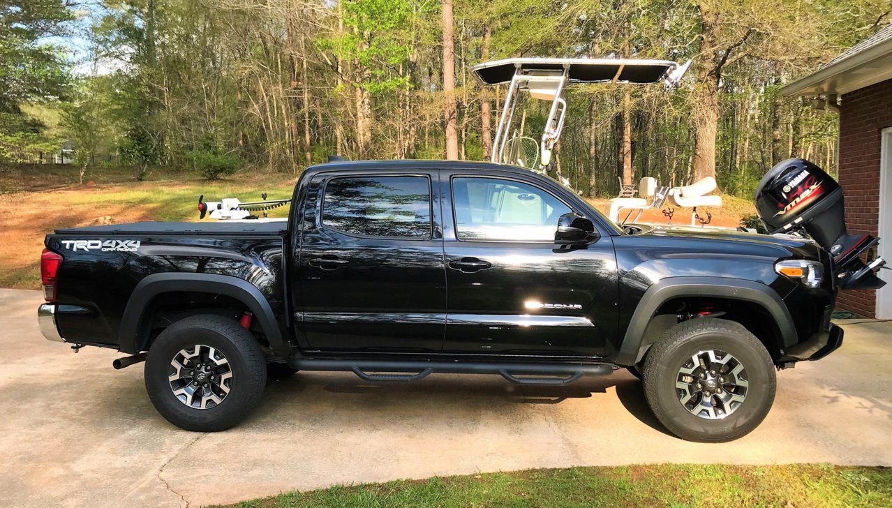

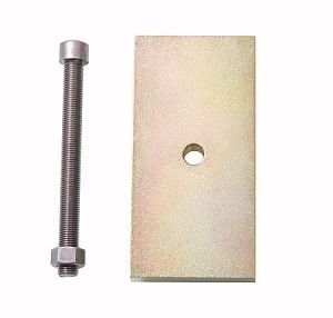

  12. Apr 11, 2019 at 5:11 AM
    #32
    BadCow
    BadCow Well-Known Member
    Jul 6, 2016
    #191365
    220
    David
    2019 Tundra TRD PRO Super White
    Instead of using 1 inch blocks, I went with 1/2 inch ToyTec flat shims under the leaf packs. This gave me the exact rake I was wanting. With the PRO suspension and the flat shims, it now sits 1 inch higher in the rear. Worked well for me.
    MrBrooks likes this.
