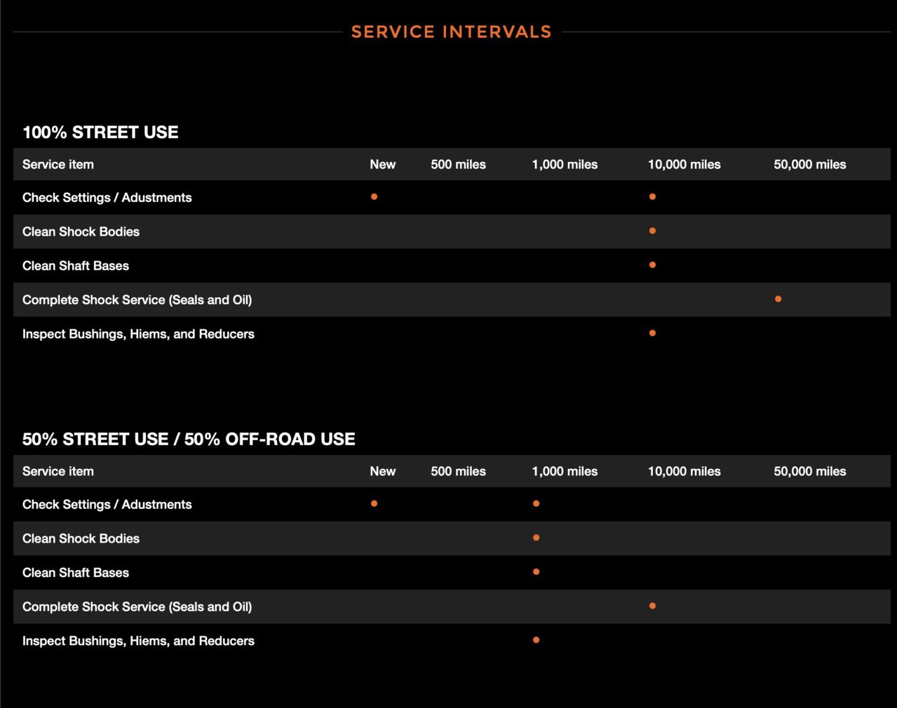

    @ian2016 what is the recommended service interval for the stock Fox shocks on a TRD Pro? I imagine I'm a ways out, but it's good to know in advance.

    50k miles is a good number to follow. Could be sooner but most guys aren’t running their trucks hard every weekend.

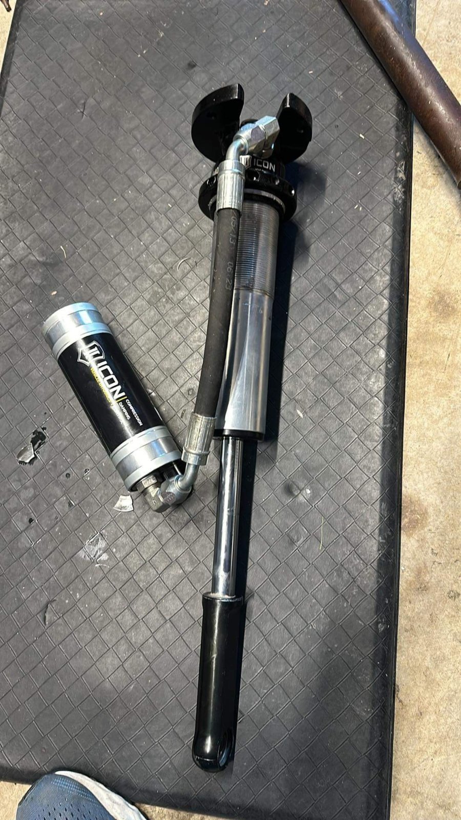

    Rebuilt these icons for a tundras.com member. Had him in and out the same day and will be doing his trd pro shocks soon so he has a spare set when needed. Thanks so much for the referral @Texoma

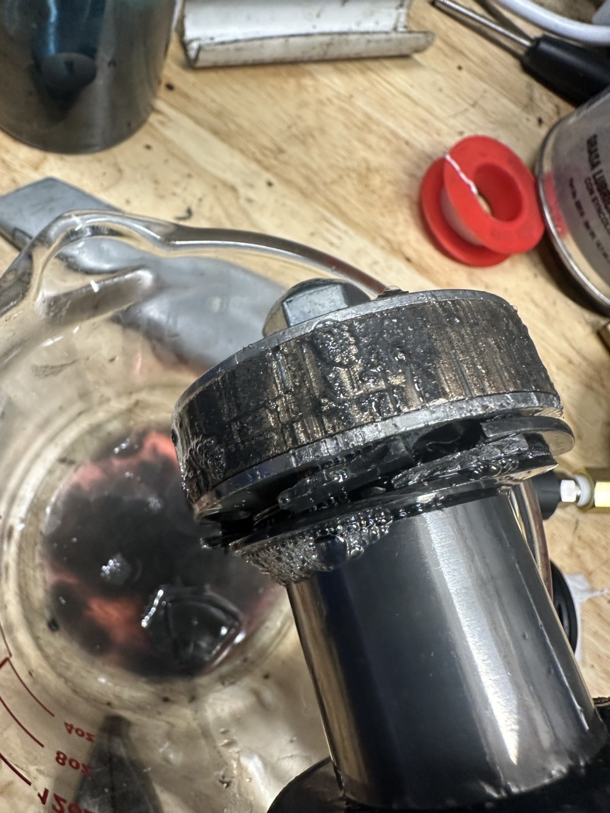

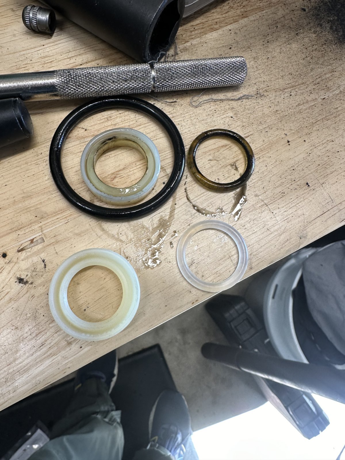

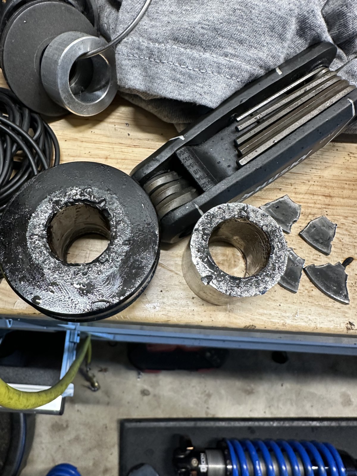

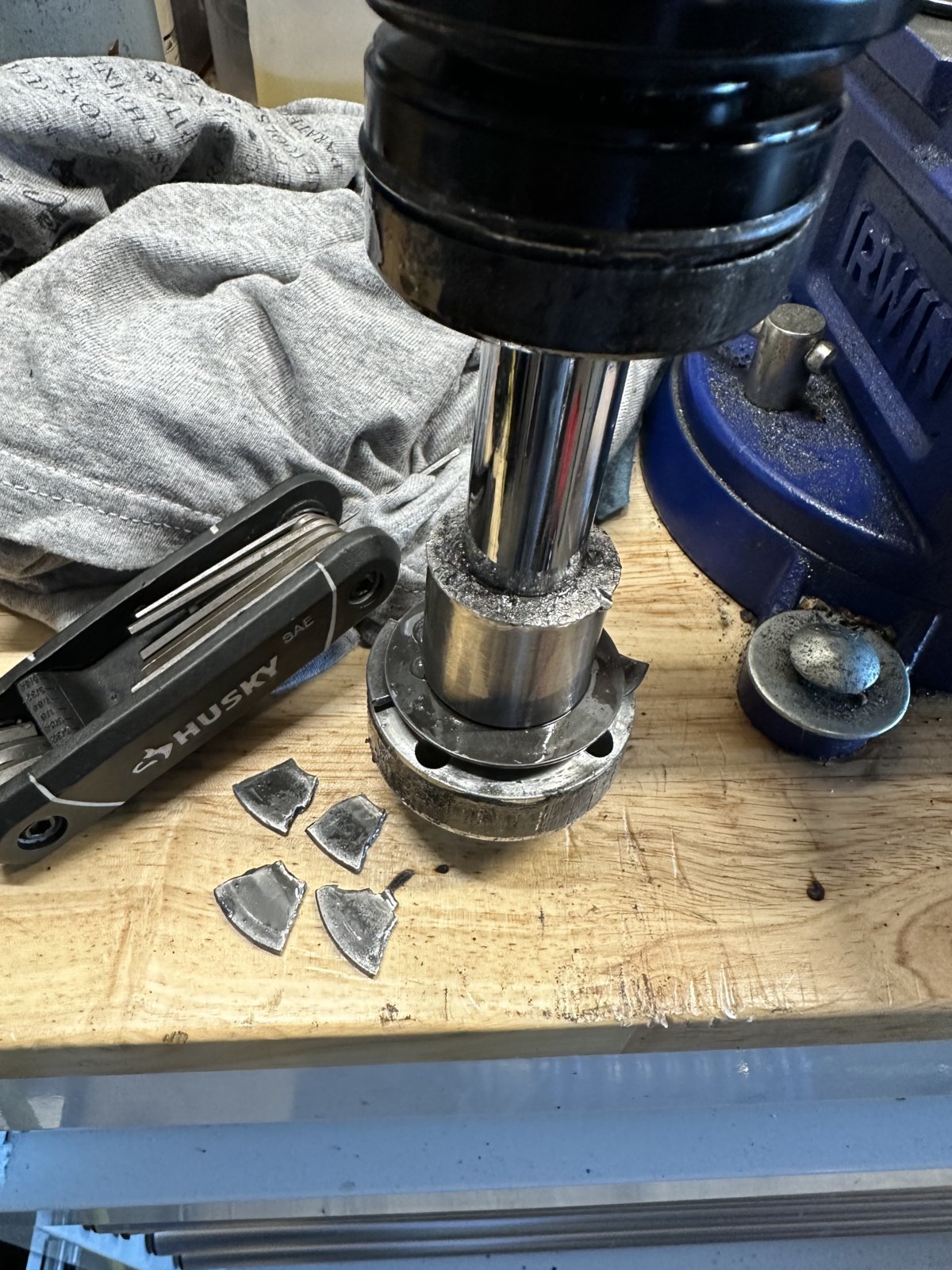

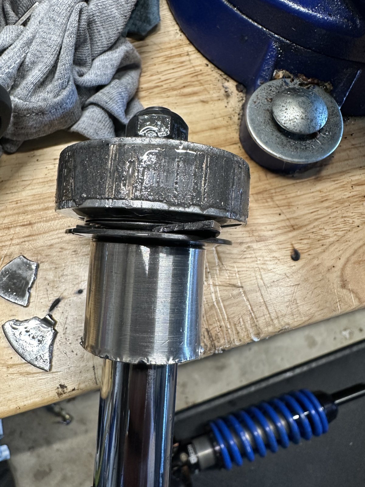

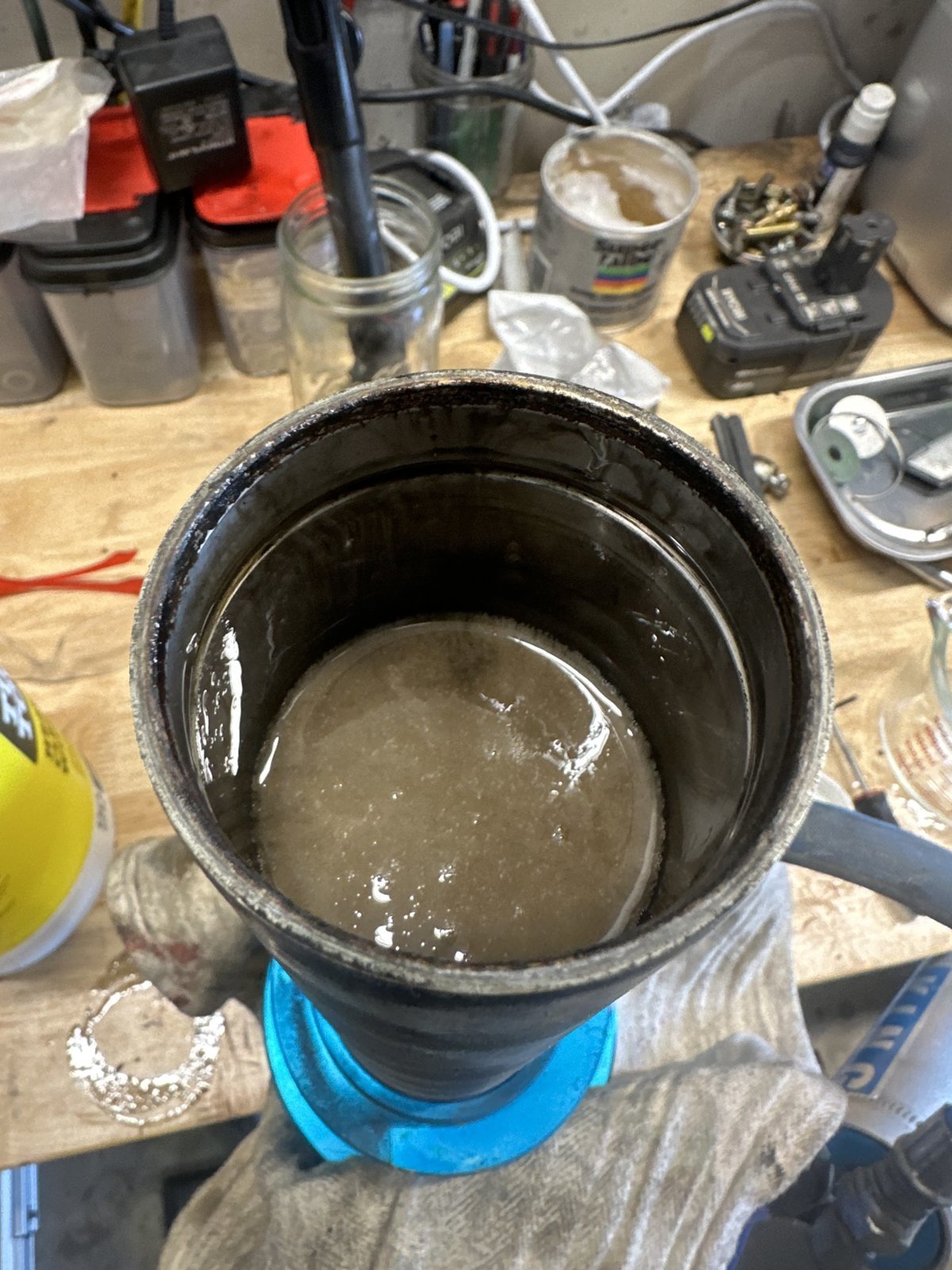

    Just because they look decent doesn’t mean they aren’t hiding something on the inside. I’m building these for myself from some busted up sets I got on marketplace. Taking two worn out sets to get all the parts to make them remote reservoirs with cdc valves.
    If y’all ever buy used shocks i recommend at least letting me look at them for you and check pressures before taking the time to put them on your truck. If these had been sold to someone just wanting to throw them on the would have leaked and rode terribly.

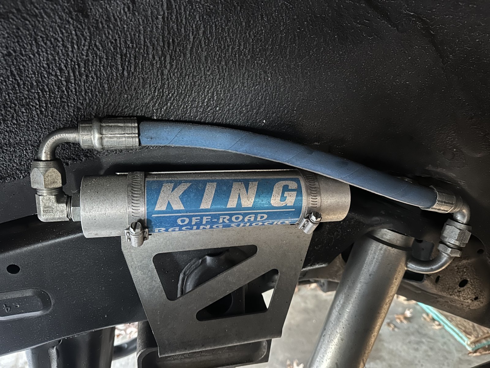

    Rebuilt a set of Kings for a local guy. Loved his 4runner! Had him back on the road the same day.
    I also have a set of Trd pro shocks ready to exchange if anyone needs theirs done to limit your down time. I can send you rebuilt shocks and you send me your old ones for the next guy to exchange.

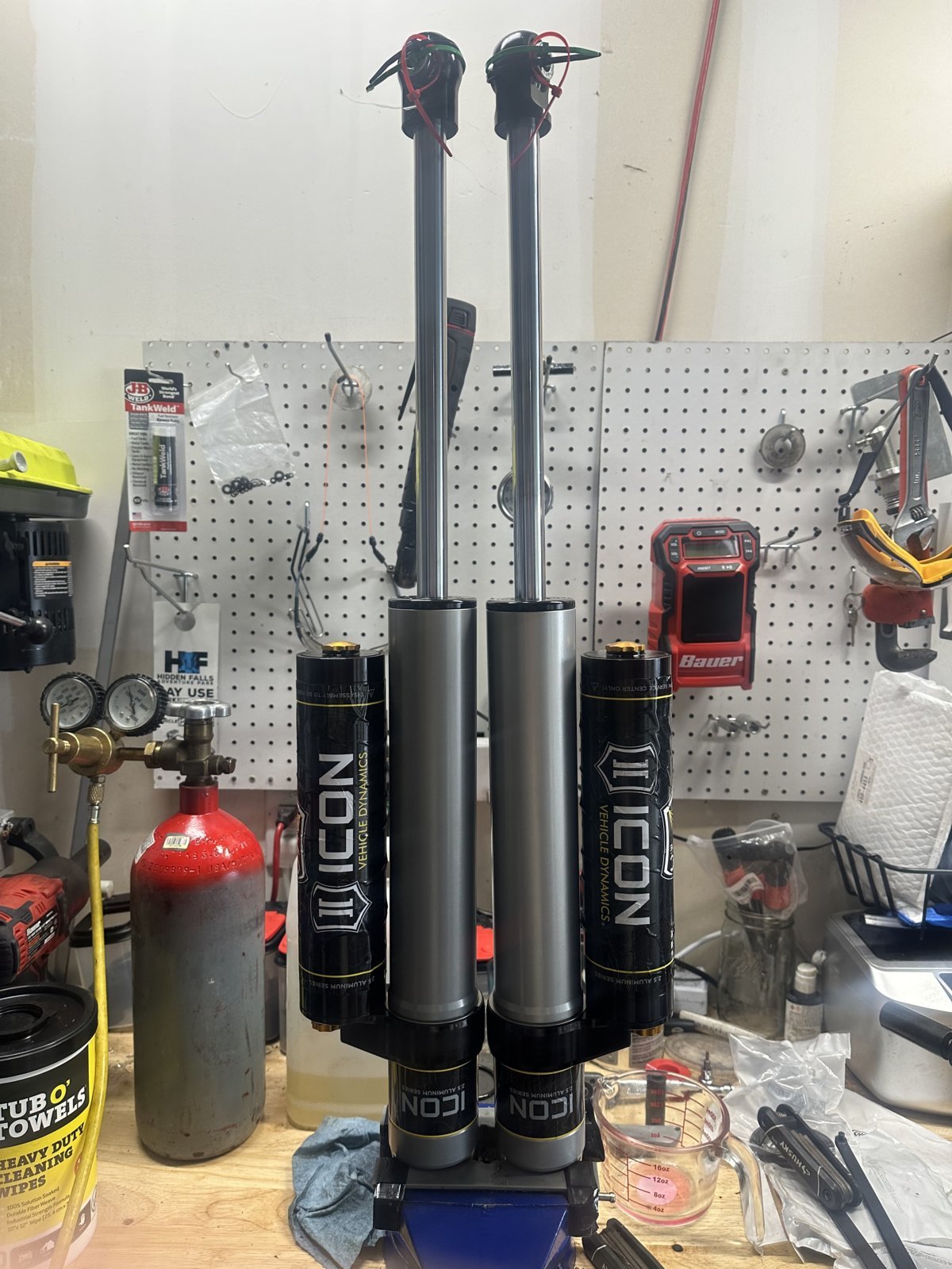

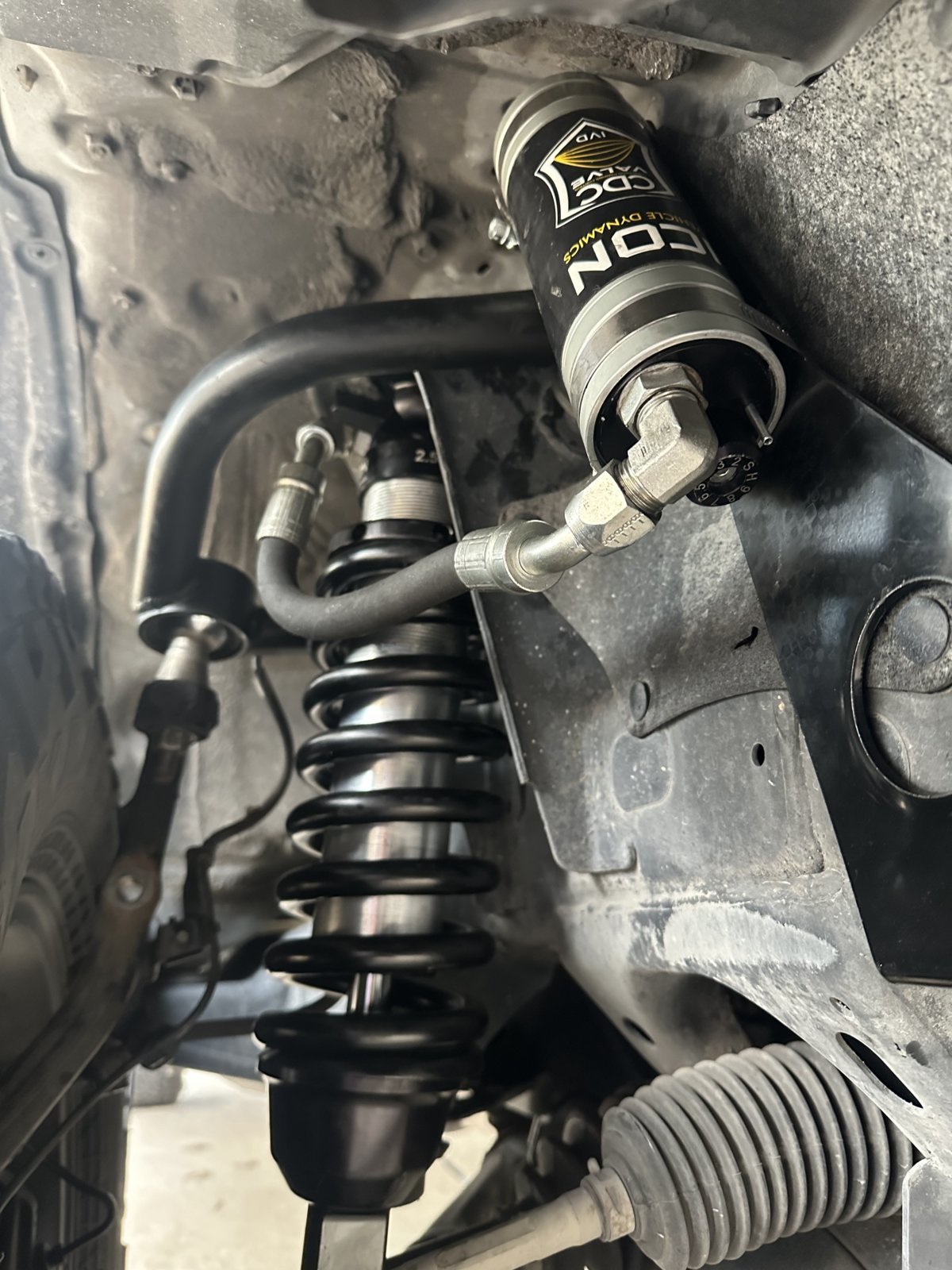

    Full rebuild of these icon 2.5 extended travel coilovers with cdc and 2.0 extended travel rears. Send me a message if you need your shocks worked on!
