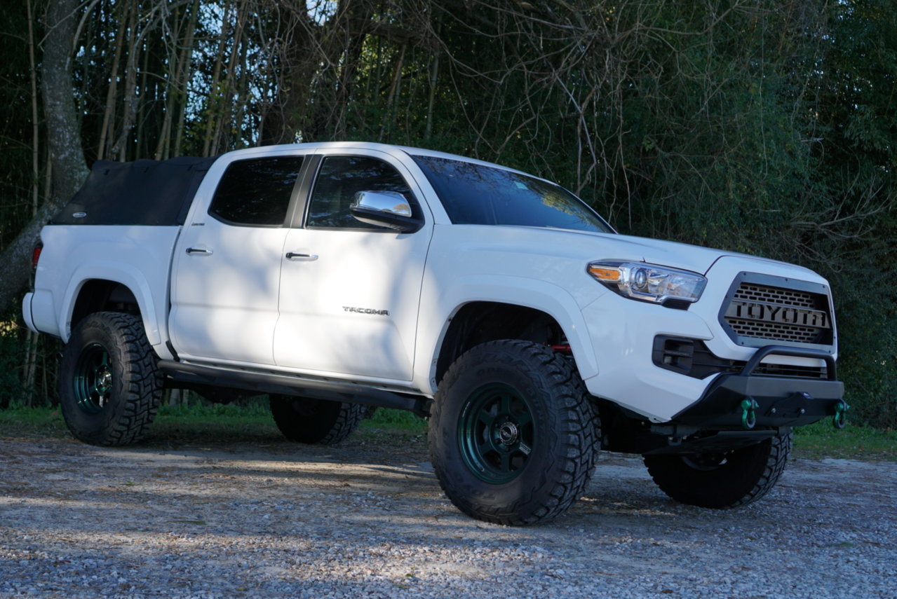

    I’ve been chillen on pavement since I installed these a few months back. But the ride is way better! I have yet to mess with the rebound and compression on the 8100s. Coming from the 5160s before, they were just not doing the job when I was offroad at the time. The shocks were nice and cool due to the resi, but the ride wasn’t the best but it got the job done.
    I will only change out the Bilstein 6112 to 8112 until my 6112 decide to blowup or start leaking. I wouldn’t suggest this setup if your wanting more than a 2” lift.
    Here’s a side view of the setup. 285/75r16
