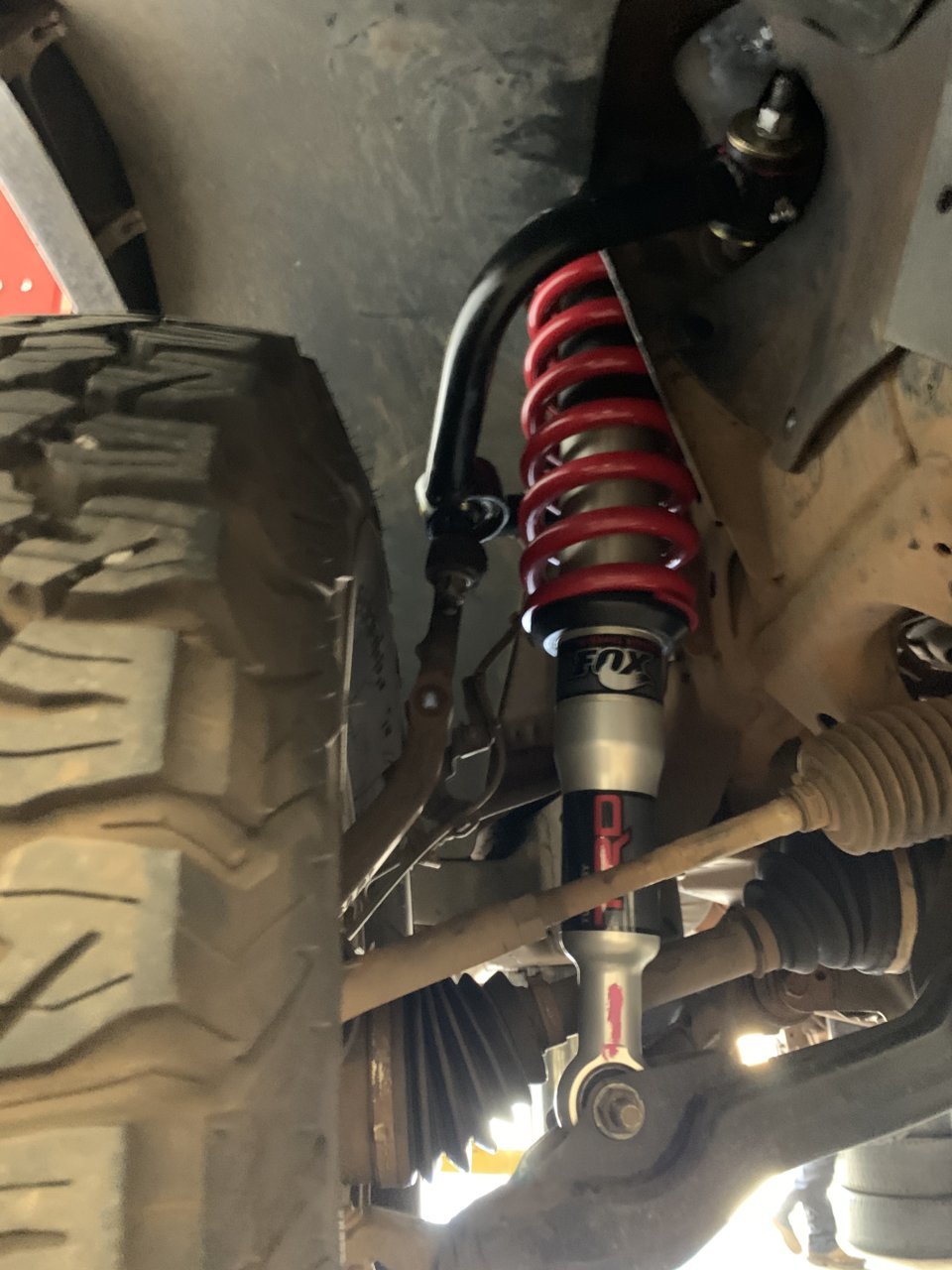

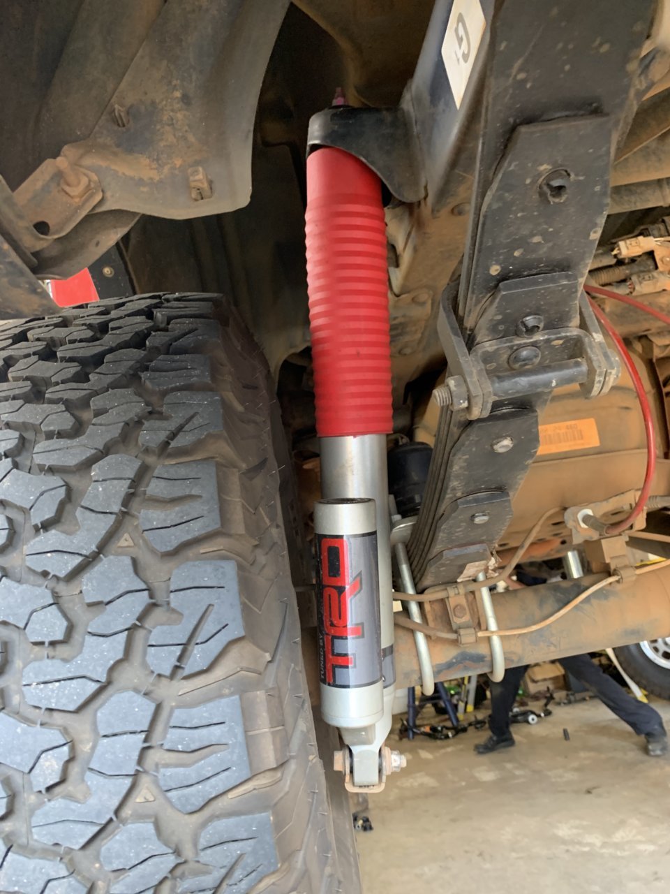

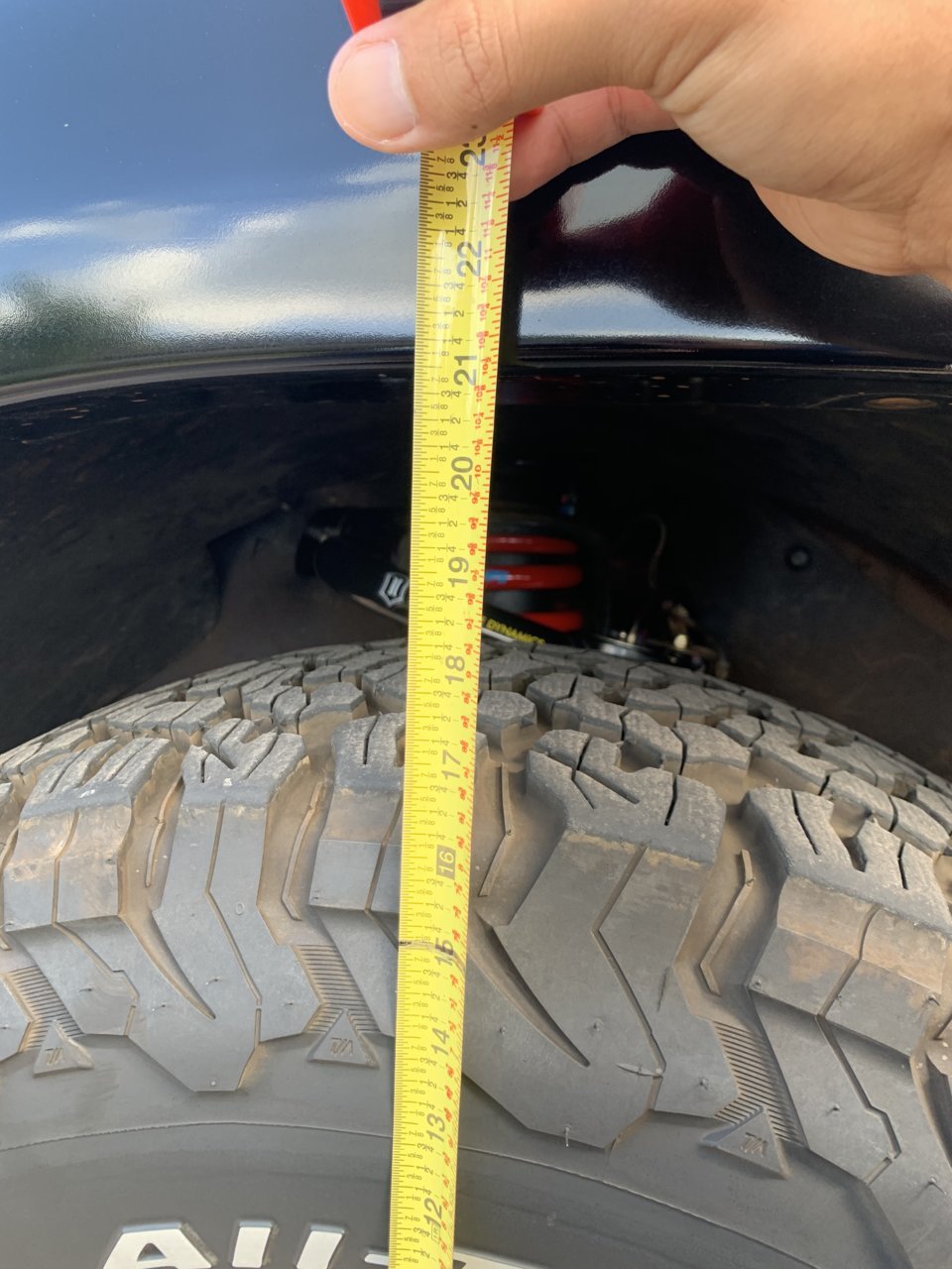

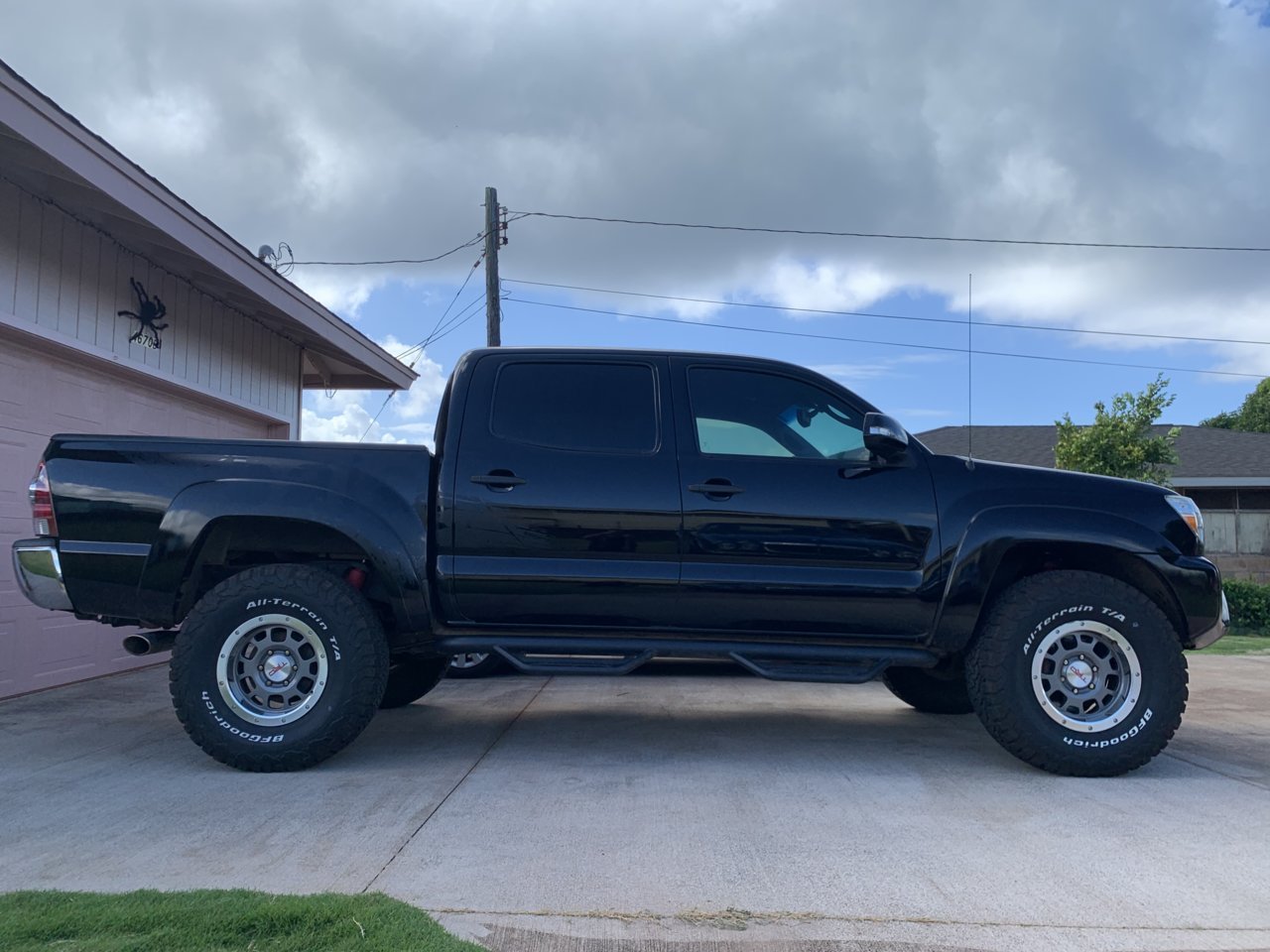

    It in fact did not lift my 2nd Gen as anticipated. Fronts netted me a whopping 21-21 1/4”
    Pics for reference:
    (Note I had Icon RXT leaf packs on Option 1 in the rear)

    Just want to confirm, are those the TRD Pro shocks from a 3rd gen? Because a stock non-pro 3rd gen is 1" taller than a 2nd gen. The 3rd Gen TRD Pro is an additional 1" taller in the front compared to the rest of the 3rd gens, thus 2" taller when compared to a stock 2nd gen.
    If you had a 2nd gen TRD Pro coilover, then swapped out for a 3rd gen TRD Pro coilover, then you would only gain an inch at best.

    Yes sir! I have a Baja(similar suspension to the 2nd Gen Pro) which is 1.75” taller from a stock 2nd Gen. From factory, I was at 22.75” on all 4 corners.
    I had the 3rd Gen Pro suspension put on back in 2019 under the same exact assumption, but it dropped my front down to 21” driver’s and 21.25” passenger’s lol. With my RXT leaf pack in the back, I had a massive 3” rake ready to my whole neighborhood lol!
