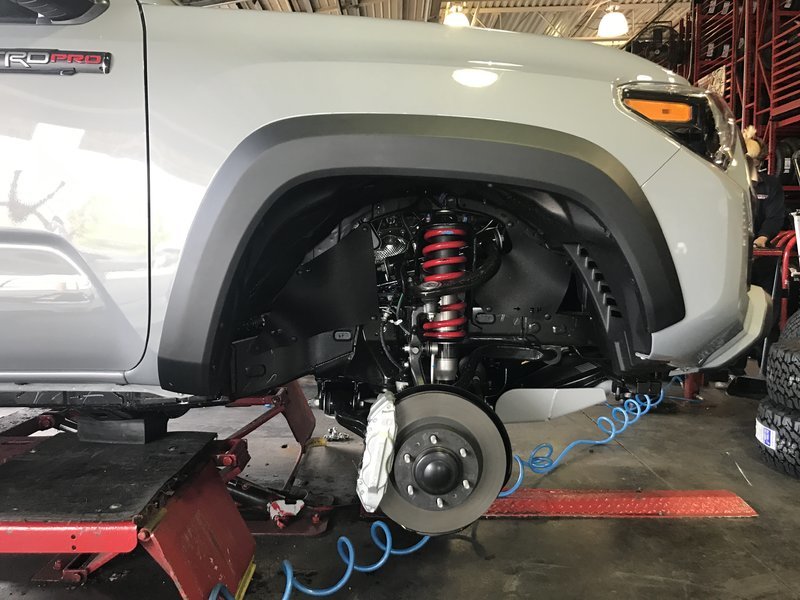

    Just in case can anyone take an array of pictures of their TRD Pro fox coilovers?

    FOX TRD Pro Absorber Information
    From what I know they are FOX components tuned in house by Toyota. They are pretty great compared to other (dare I say all) OEM absorbers.
    Extended Length
    Front: 555mm
    Rear: 595mm
    Collapsed Length
    Front: 443mm
    Rear: 357mm
    Stroke
    Front: 112mm
    Rear: 238mm
    Shaft Diameter
    Front: 22.2mm
    Rear: 22.2mm
