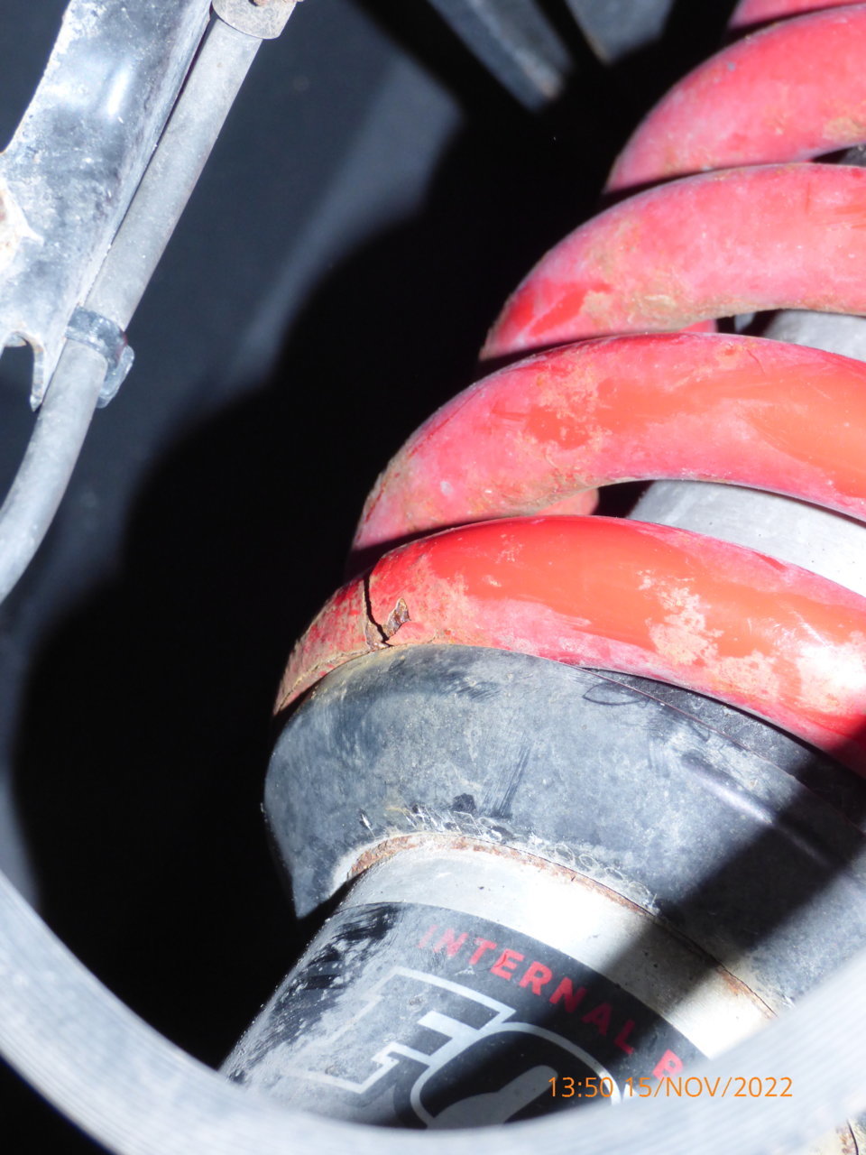

    P1070121.jpg Here is the driver side broken coil spring. The passenger side actually had a 3 or 4 inch piece break off.P1070121.jpg

    same thing happened to my 2017 at 36500 miles...37 months old,, not covered,, found a 3 inch piece of spring laying on garage floor.. replaced with eibach pro springs,, red color..

    If anyone is actually curious this is a known issue with these springs as they use a truncated end instead of a tapered end like most springs. This causes a stress point leading to failure.

    I wonder if once the truncated end snaps off if the remaining spring would be OK to run with? I also wonder if the replacement springs still have the truncated end or are they pigtailed. One local guy at a 4WD shop told me his son has a 2019 TRD Pro which had the broken springs and his replacements now have 40 or 50K miles on them. So I hope these replacements have been improved.

    mine broke because they rusted so bad, here in NE PA...... my passenger side spring is good, its a wall hanger in garage

    This will probably be my last post for this thread. My shocks with springs on them finally came after many weeks. They came from Montreal for some reason. They were listed at over 2000 dollars for the pair. They do not sell the springs separately for some reason. Unfortunately, we compared them to the broken ones after the mechanic removed the old ones and they look exactly the same. So now I have no confidence that they will not break after a similar mileage or time. The service manager thought that maybe corrosion gets in under the red coating and causes the spring to eventually break. Looking at my broken piece it really does not show signs of rust at the exposed metal ends. Labor cost me just under 400 plus the required alignment was about 75. I still feel that Toyota should have covered the labor as well. If they break again I will go to a different suspension not the Fox.
