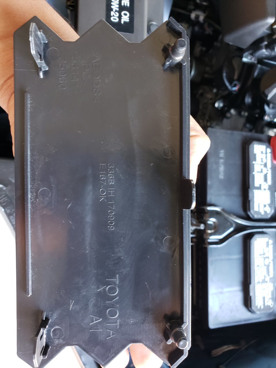

    This is the garnish cover

    Yes the garnish have wrapped in the front and came only in box

    Sounds like you got a knock off garnish, which has caused error problems for others.

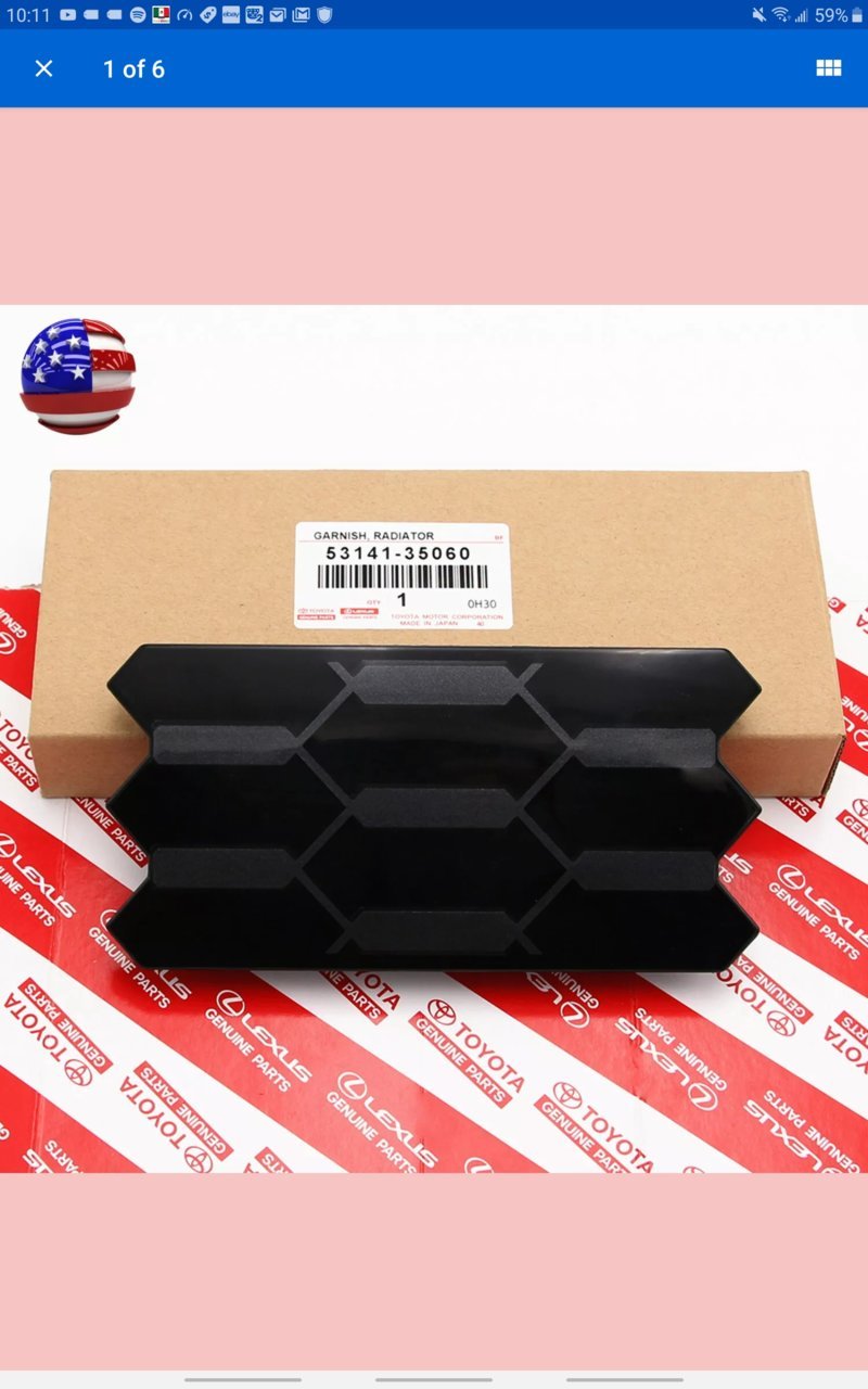

    This is i bought

    Did you get both items from the dealer? Purchased my grill from the taco garage and garnish direct from dealer and everything worked fine.

    I’m not sure if they do come in boxes because the only ones I seen is in the paper wrap, I work in a warehouse that supplies toyota parts.

    Fattypack is on point :thumbsup:

    It's fake. Get your money back then buy the real one. Problem solved.

    you got a fake.. lot of posts about this including the one posted above.

    His problem is not the faux grille but the fake garnish.

    Does anyone have a picture of the genuine toyota one? The one posted above does say toyota on it and its fake?
