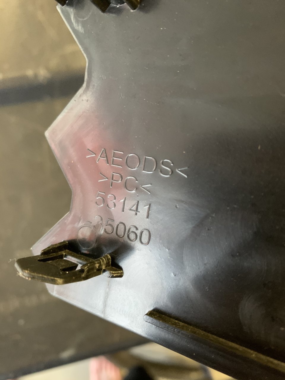

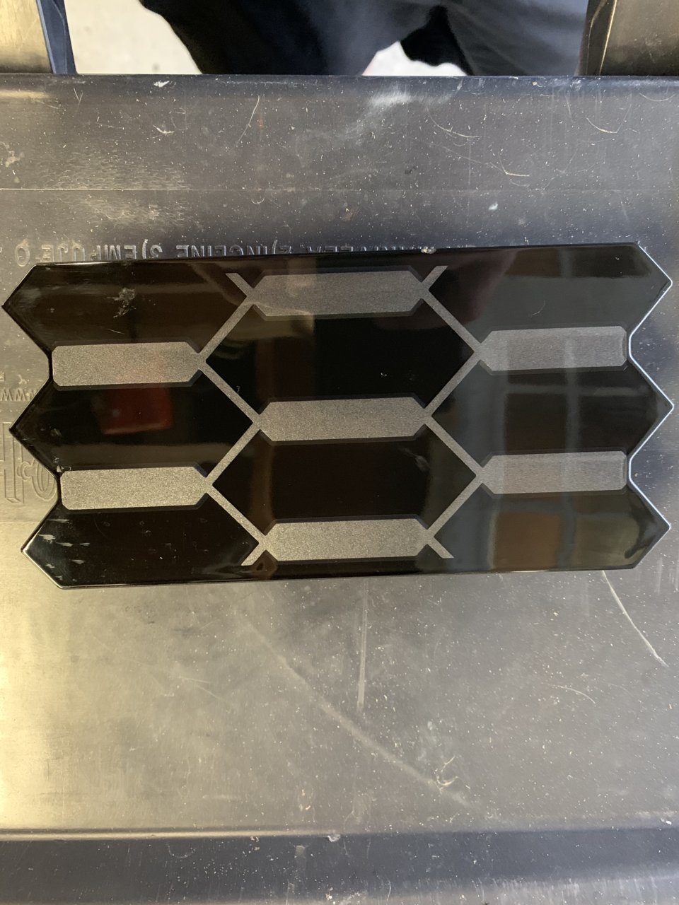

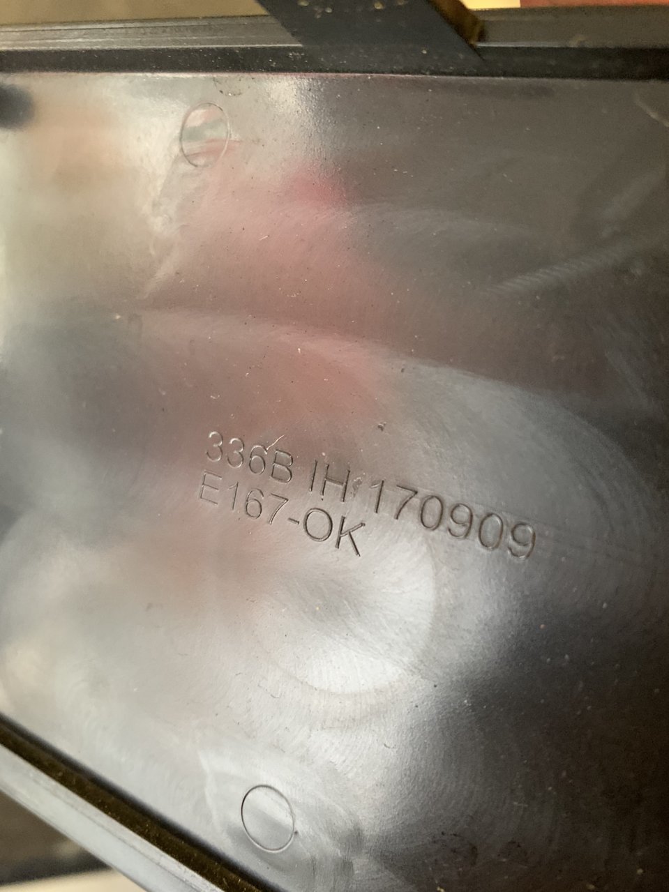

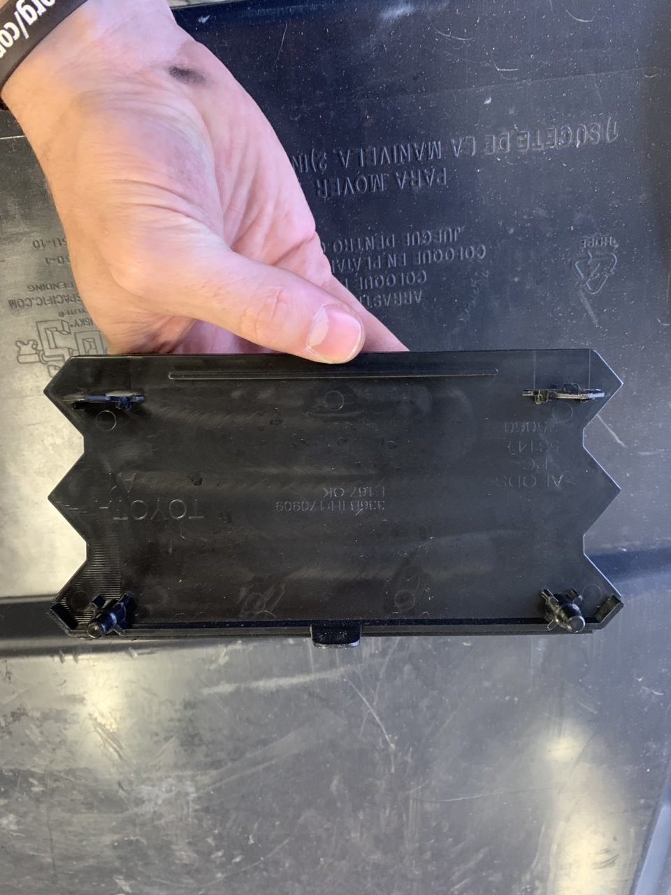

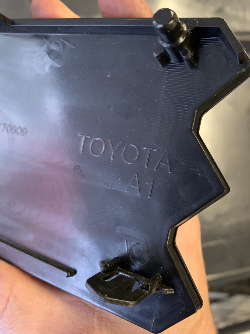

    got any pictures of the garnish front and back?
    Baker4595[QUOTED] likes this.
    auskip07[QUOTED] likes this.
