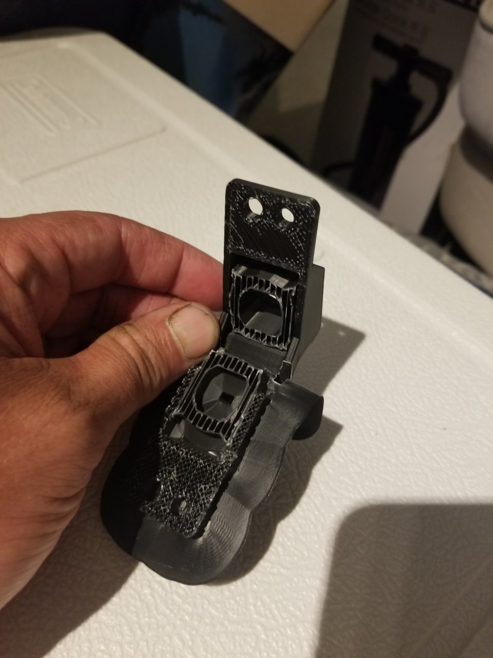

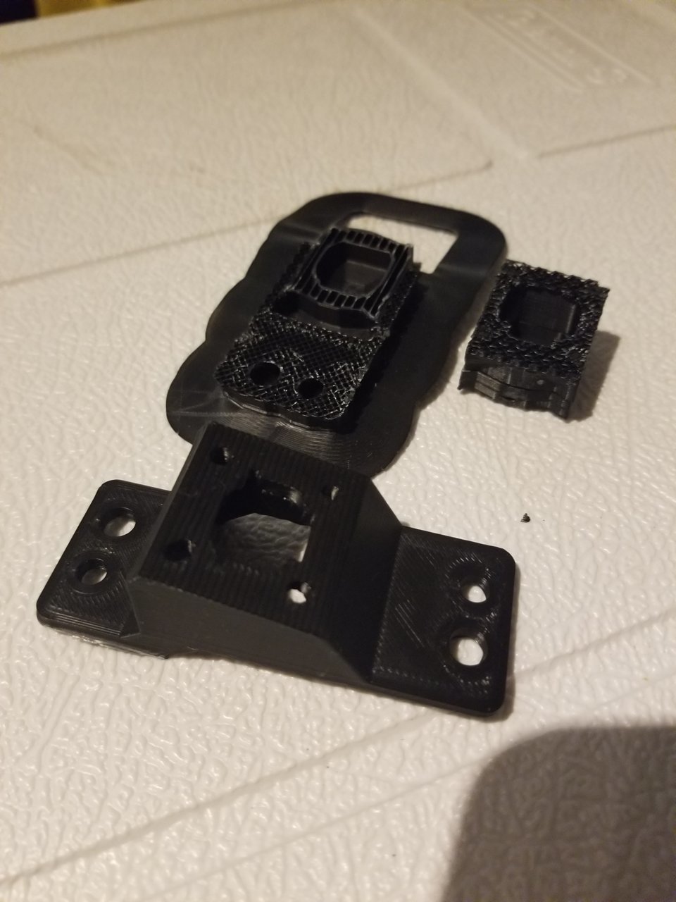

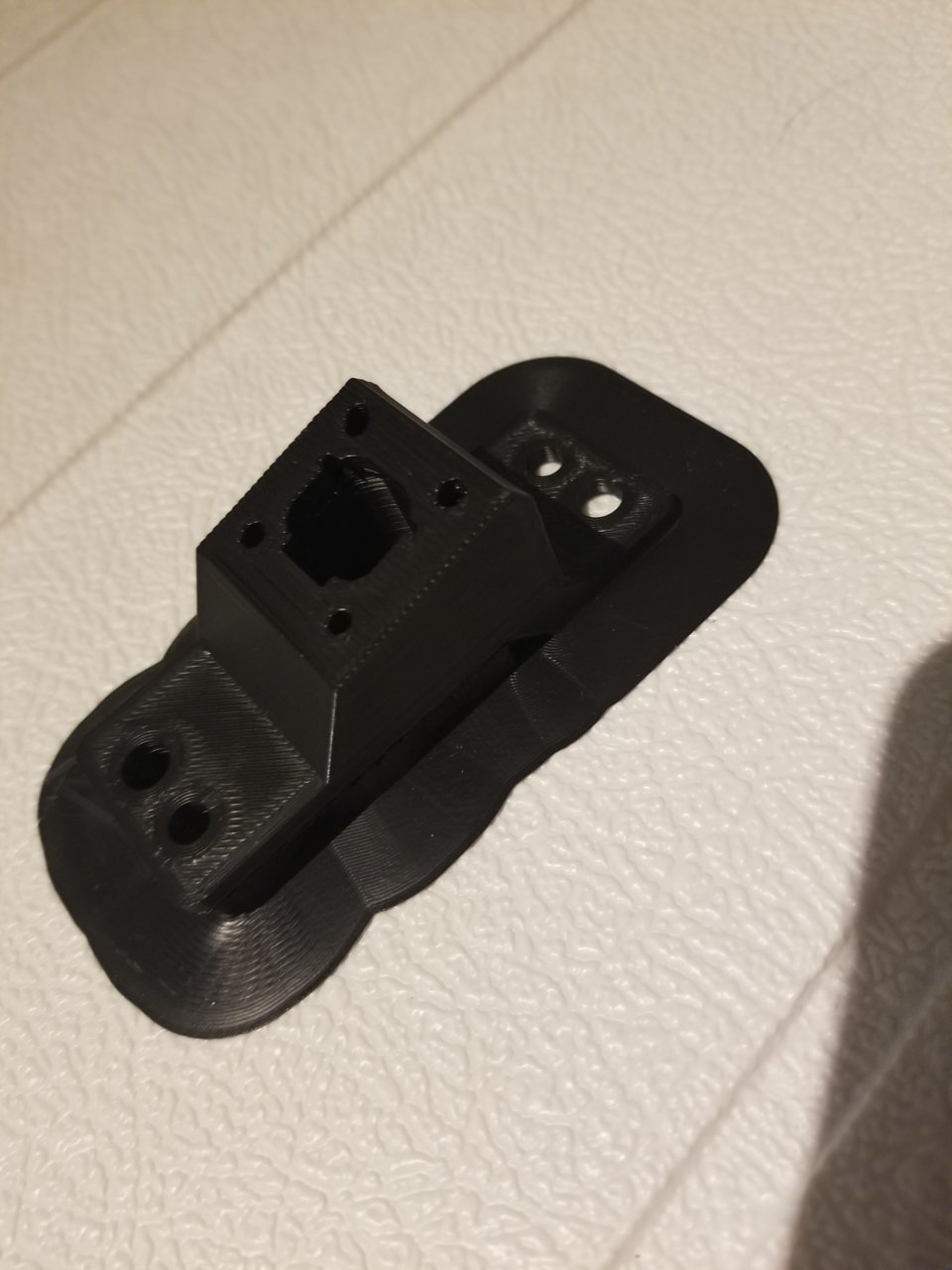

    I have made a Mark II of the camera mount bracket for the Pro Grill. The overall design has some added strength and is now manufactured from ABS plastic with has good thermal resistance for hotter environments.
    Grantschoenit@gmail.com
