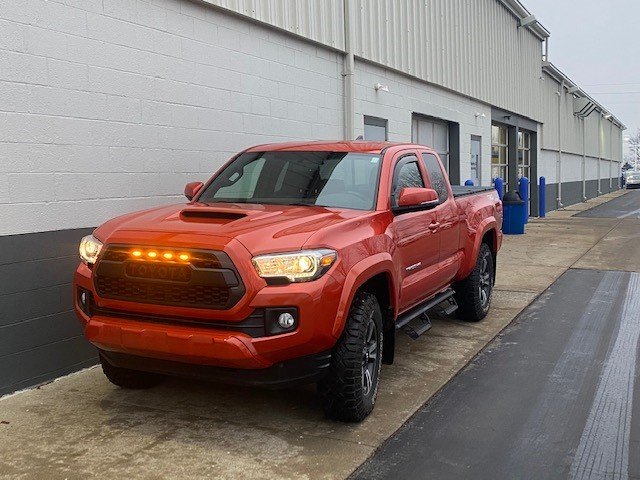

    [​IMG]TRD grille.jpg New grill installed quite easily. Now I'm trying to decide whether or not to pull the letters back off and paint them in Inferno. This was the only only body color they didn't offer them in. Still trying to figure out how to get the lights to come on with my running lights without adding a separate switch. Currently they come on with the headlights.

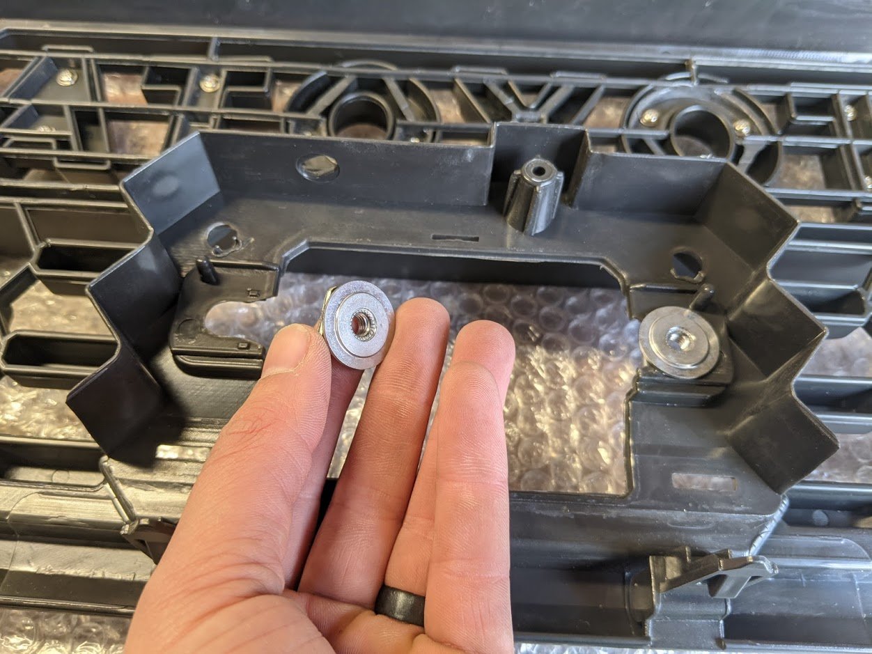

    When you take the sensor off your old one grab the two threaded inserts off the old grill and put them on the new one, they slide out towards the center. The videos I watched didn't, and just installed the sensor with the one screw in the upper corner... I'm wondering if that might be why some people have issues.
    sc9j2F7Lp2XNRvP4AMA8u6jxCL30w6AMSpZVeIZb_dae793e56a785ceccf0f4d8789227efa427855ca.jpg
    Rock-N-Roll[QUOTED] likes this.
  10. Dec 17, 2020 at 3:16 PM
    #370
    Rock-N-Roll
    Rock-N-Roll Well-Known Member
    Sep 17, 2015
    #164506
    276
    James
    Westminster, CO
    2021 T4R TRD ORP
    One mod away from marriage counseling
    Thanks for the heads up on that! I'd likely blow right past it myself if I didn't know. :cheers:

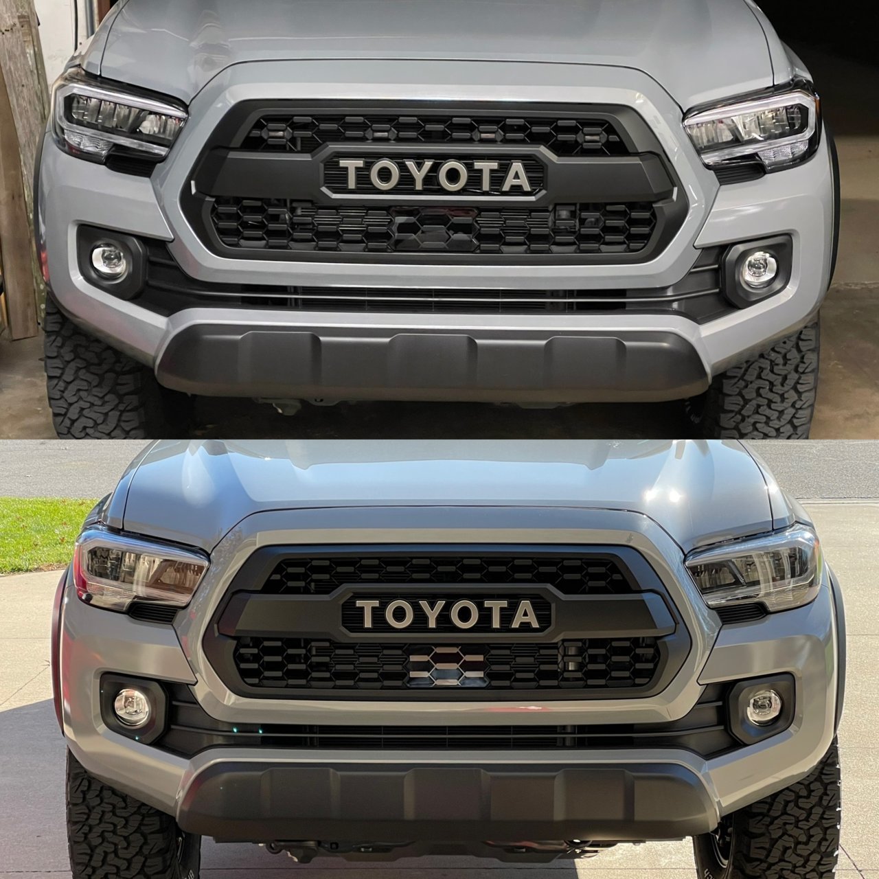

    @zane-z
    Is the top the after? Any follow up with issues?
  19. Jan 12, 2021 at 3:30 PM
    #379
    zane-z
    zane-z Member
    Nov 6, 2020
    #346024
    15
    Zane
    2021 TRD Off Road Tacoma - Cement
    285/75/16 BFG AT/KO2, 2021 OEM TRD PRO 16" Wheels
    @along16 yes, top image is after, bottom image is before. Still working perfectly, no issues.
