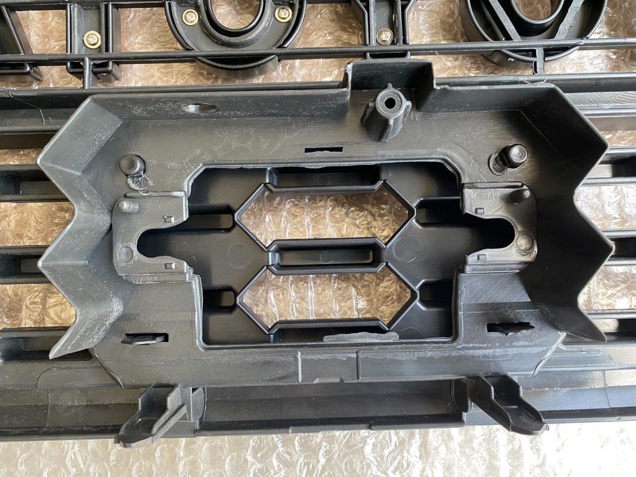

    One point I remember from the Taco Garage video is: there's an angle of the garnish holding area. In the video, it's mentioned at the 5:15 point.
    From what I recall, the placement area is already angled and does not need the washer on the top of the TSS.
    You just have to make sure the garnish is pushed in and flush. Press down the locking washers with a 10mm socket to make sure it seats as flush as possible.
    From this photo, the garnish is pushed in as far as the entry holes allows.
    As suggested by the Taco Garage guys, make sure your TSS connections are snugly snapped into their terminals.

    @ChrisIz Here's the angle at the top of the Garnish...I just noticed the thickness at the top.

    I looked again...and the holes for the garnish don't seem big enough...the garnish posts are not sitting flush right up against the grill entry points.
    If I pull the drill out to make slightly bigger holes/entry points, I'll need to be real careful not to crack the plastic.
