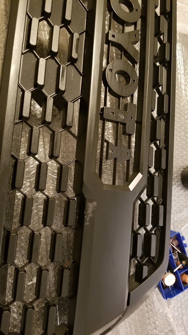

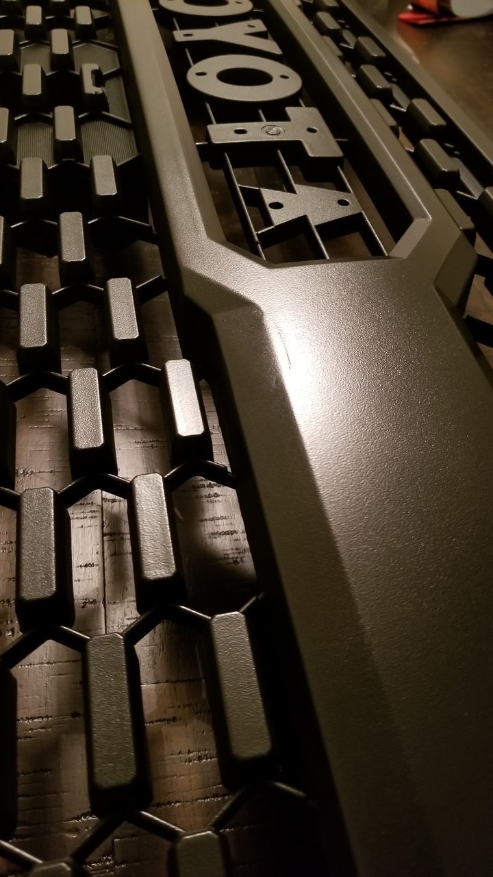

    While making some mods to install a front camera on my aftermarket chinese cheapo grill I accidentally made a gouge with my Dremel across the face of the grill. Tried to buff it really quick and ended up making it worse.
    Does anyone have any tips to repair? I'm thinking of taping off the area with a little space around the edge and then using like a plastic epoxy filler and then sanding it down and repainting the whole thing. Any recommendations would be greatly appreciated.

    Sand it and repaint it? If the marks are super deep, little jb weld or plastic filler might work, sand and paint..

    Hard to tell how deep the marks are but you could sand it and Bondo that area then paint or plastidip the whole thing. By the way, welcome to the forum.

    Definitely looks like you would need to add some filler, sand, and repaint by the looks of that 2nd picture.

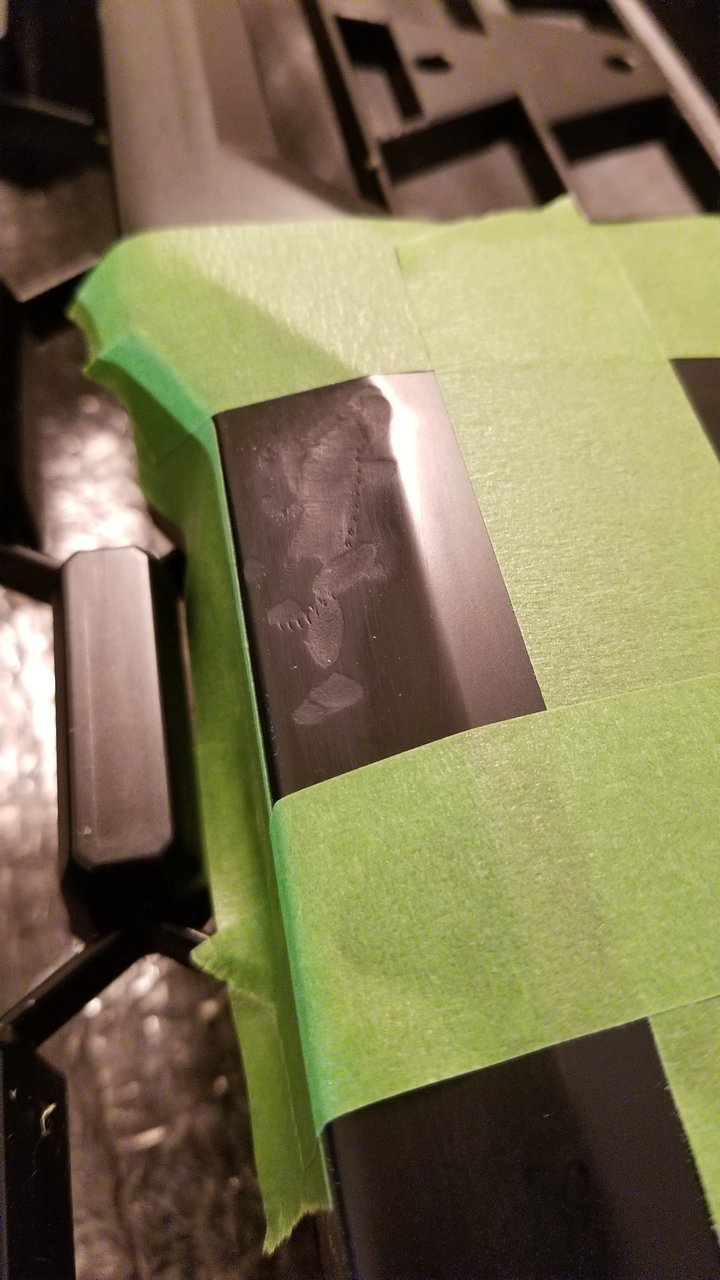

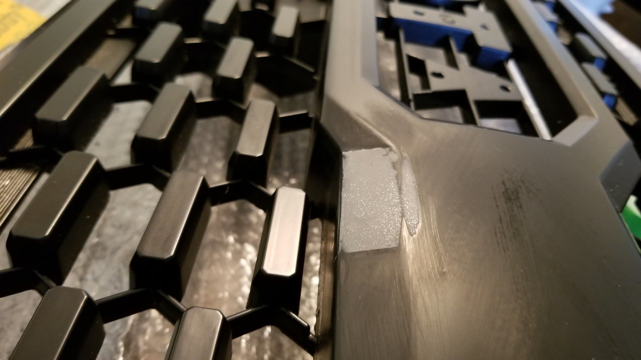

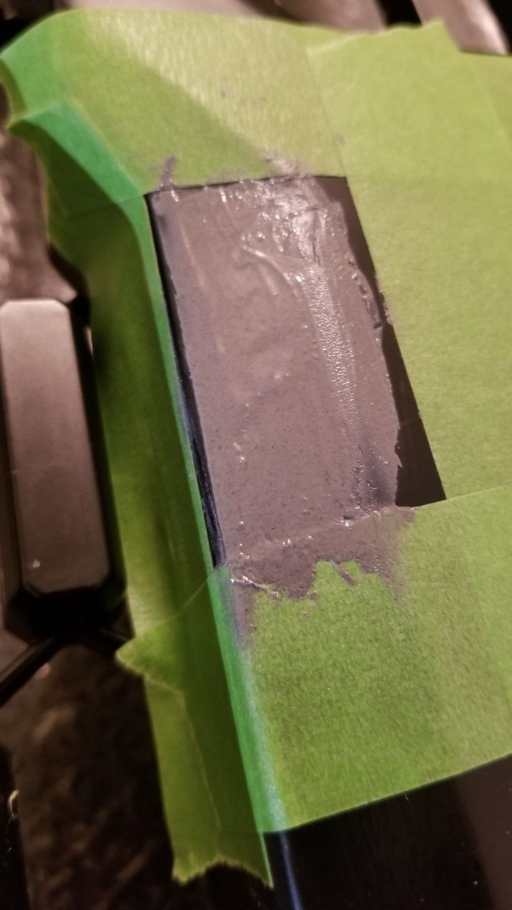

    Here's an update to the fix. I ended up using some JB Weld and sanding and painting it with some Rustoleum Matte finish. The fixed area is only slightly visible and i can live with it. I probably could have spent more time on it and made it totally invisible but this is fine for me. I did end up lightly sanding the entire things and giving it all about 3 coats to make sure it was all covered evenly.
