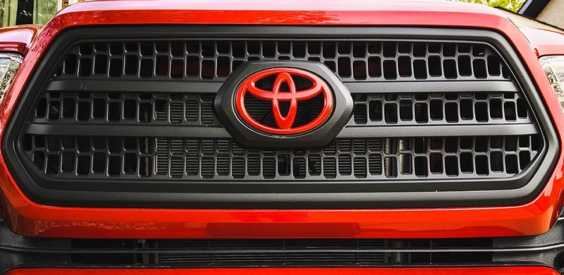

    For my Sports grille, I plastidipped everything then removed the Toyota emblem and sprayed it with color-matched Dupicolor spray paint right over the derp. Worked well. I think I'll do the same with the Toyota lettering once I eventually get the pro grille.

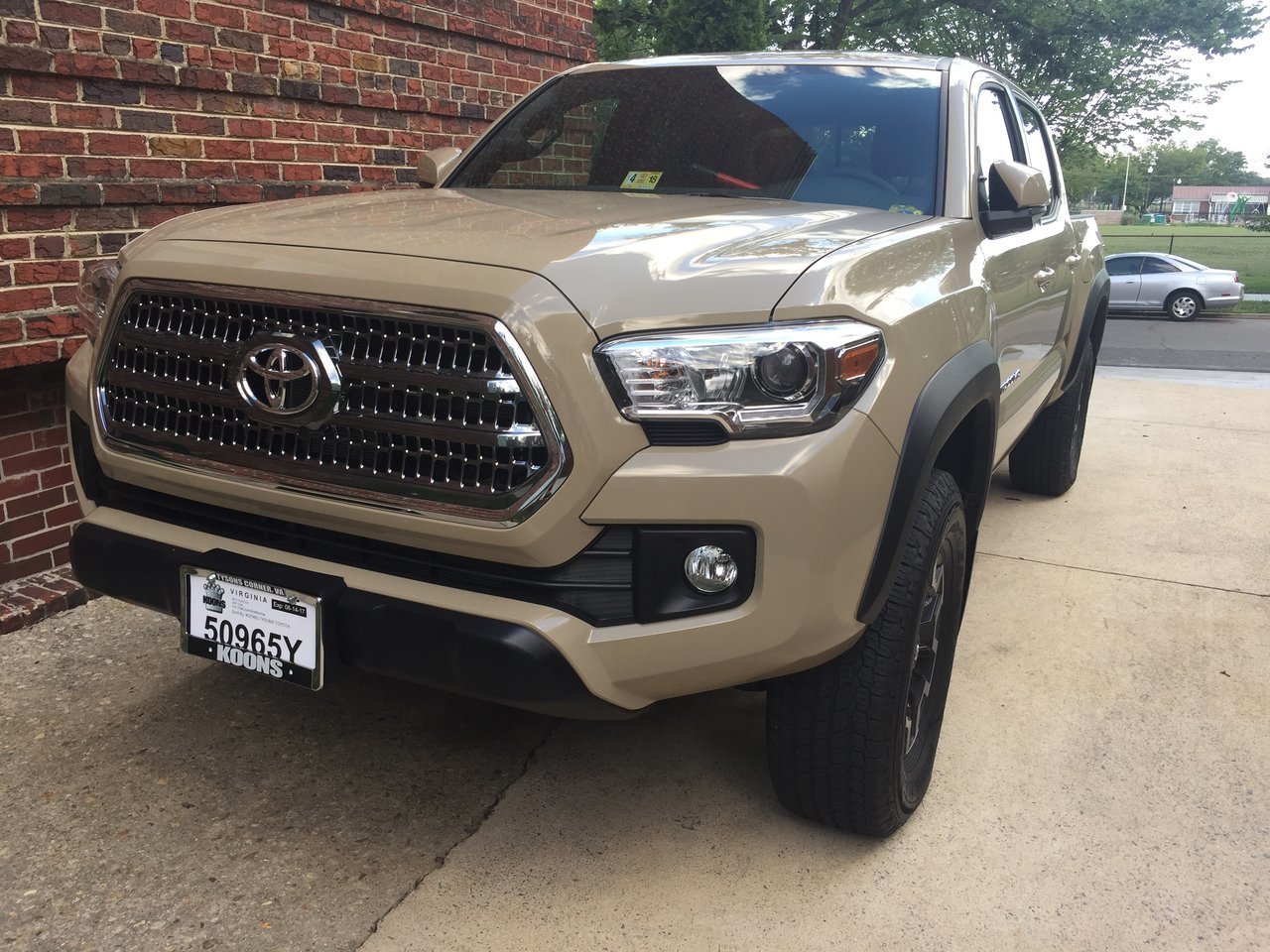

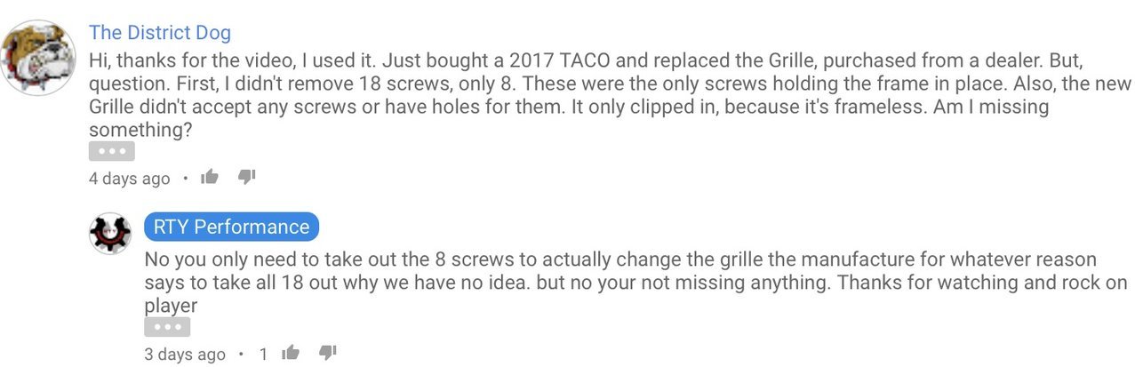

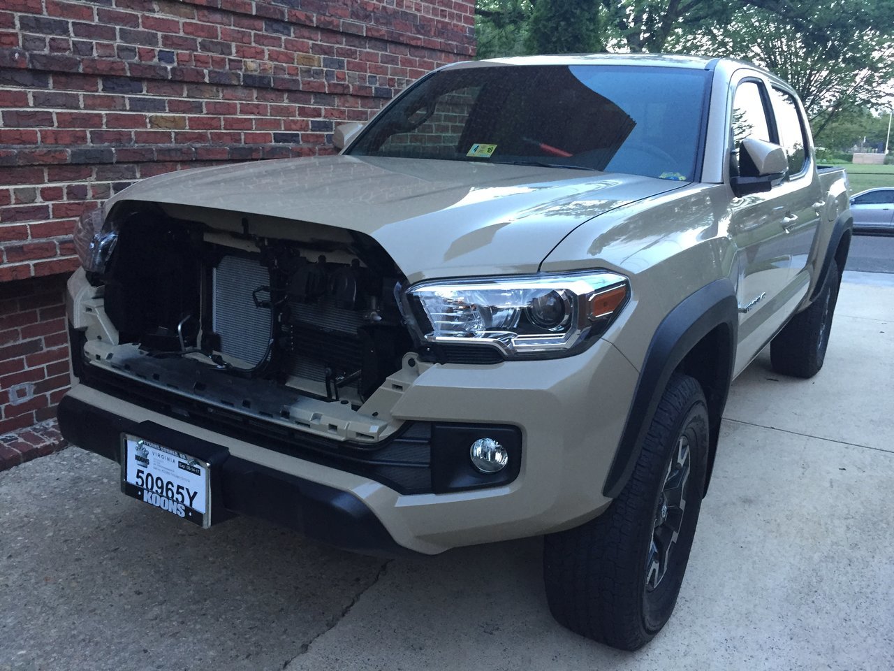

    2017 Quicksand Tacoma TRD Off Road

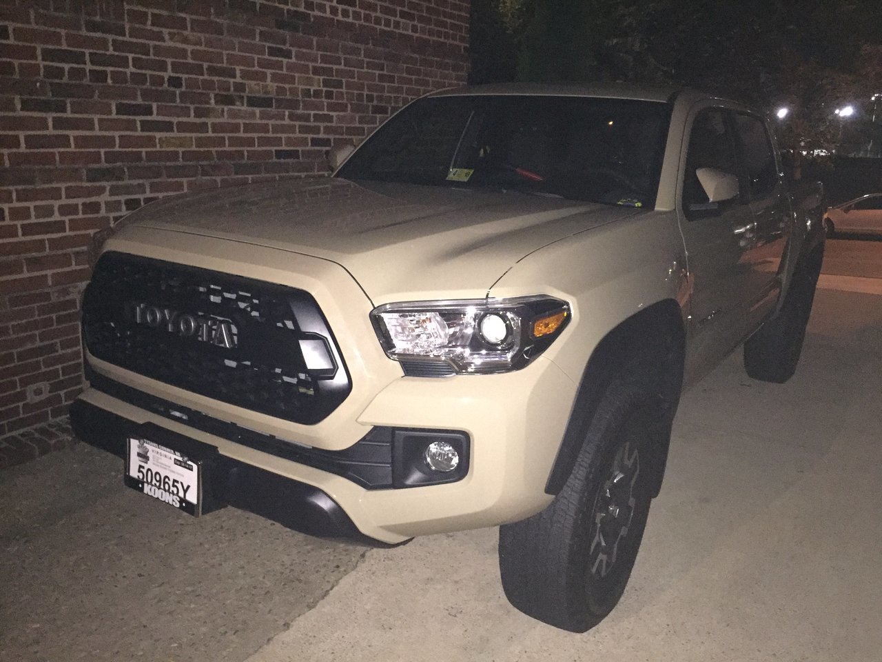

    I just replaced the stock grille with the TRD Pro grille on my 2017 TACO (install date = 7/27/17). The TRD Pro Grille I installed used NO screws. That's NO SCREWS. ORIGINAL OEM (3 piece): Body frame => Grille Frame => Grille. REPLACEMENT TRD Pro (2 piece): Body frame => Grille.
    From the original OEM "grille frame," I removed 8 - count them 8 - screws to separate the "frame" from the grille. These screws do NOT go back into the TRD Pro Grille. That's because the TRD Pro Grille only "clips" into the "body frame," eliminating ALL SCREWS used for the original "Grille frame." Only the "lower screws" surrounding the original "Grille frame" come out. Look at it carefully. The "higher screws" are "structure," NOT frame.
    Yes, this sounds confusing. Yes, there is a slick video on YouTube (by a Toyota Dealer) saying you need to "remove 18 screws" and use "8 screws" to install the TRD Pro Grille (this is WRONG).
    Again, REPLACEMENT TRD Pro (2 piece): Body frame => Grille. No screws, ONLY clips.

  17. Sep 14, 2017 at 2:51 PM
    #877
    itsraymondang
    itsraymondang Spam King
    Sep 10, 2017
    #229645
    329
    Houston, TX
    2017 White TRD Sport DCSB
    So those 2 circles are where the screw goes into? I thought the TRD Pro grill was just a clip on and done.
  18. Sep 14, 2017 at 7:40 PM
    #878
    pc3coyote
    pc3coyote www.pc3coyote.com
    Sep 28, 2014
    #139276
    1,627
    Paul
    SoCal
    17 BBP Sport DCSB 4x4
    From my understanding they stay but I could be wrong
  19. Sep 14, 2017 at 8:20 PM
    #879
    itsraymondang
    Sep 10, 2017
    #229645
    329
    Houston, TX
    Well I just screwed those 2 screws in and it's a little less 'wiggly'
