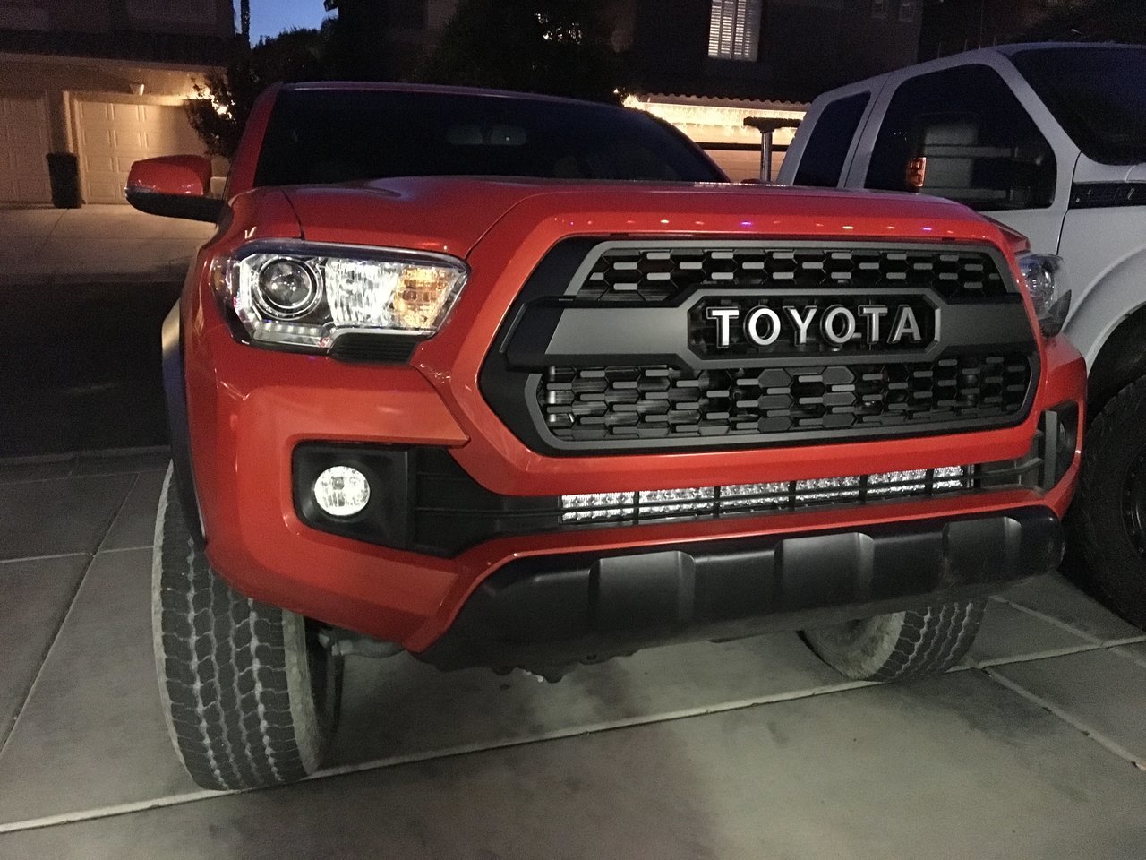

    Here is a photo of mine from areyourshop-a - snaps into place tight and no tabs were broken. Received in a week. It is a two piece

    What did you mount that light bar to and does the grill in front knock down the ability to aim it?

    I used caliraised mounts to mount it and bought the light from there so everything lined up correctly. The mounts bolt to your frame bolts that hold on the crash bar. If you do your grill it is a great time to put this in since the grill is already removed. Watch their youtube video and it is super easy. The grill in front does not mess with the ability to aim it and I had about 3/4 inch I could push the light back from the grill. I have it about a 1/4 inch away just to reduce heat exposure to the plastic.

    Cool, appreciate that. I was thinking if I got one I'd cut that lower grille work but it sounds like it's not necessary.

    Not at all my man. Had it offroad last weekend during pitch black and the small grill does not affect the light pattern that I could notice - and I am not a fan of cutting up my stock stuff. Goodluck!
