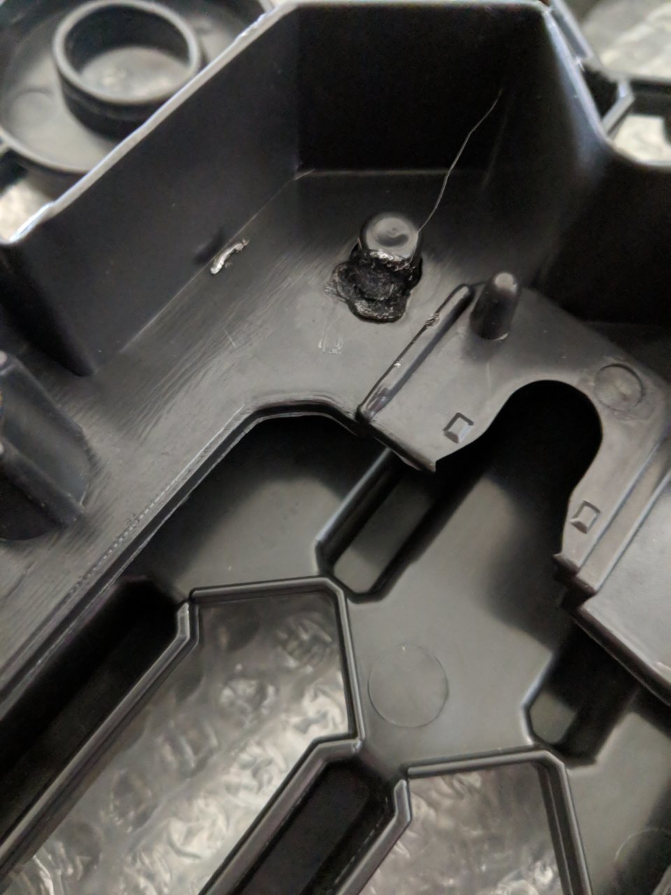

    How do you remove the cover to fit in the tss and garnish? I’ve got 2 clips on mine but there’s the 2 pegs that are glued to it almost
  4. May 12, 2018 at 12:55 PM
    #4164
    N2DesignsInc
    N2DesignsInc --------------------------- N2 Designs, Inc. Vendor
    Jan 26, 2018
    #242487
    2,358
    Los Angeles, CA
    2018 that identifies itself as a 2021
    Mods: Is this still a Tacoma?
    Use a box cutter or blade and do a few runs around each melted pin, it will pop right off.
  5. May 12, 2018 at 12:55 PM
    #4165
    aphillips916
    aphillips916 Well-Known Member
    Mar 7, 2018
    #246590
    697
    Aaron
    Winchester, Kentucky
    2018 Cement TRD Sport
    Sweet man, thanks!
  6. May 12, 2018 at 1:00 PM
    #4166
    aphillips916
    Mar 7, 2018
    #246590
    697
    Aaron
    Does it pop out through the front or back?
  7. May 12, 2018 at 1:02 PM
    #4167
    N2DesignsInc
    Jan 26, 2018
    #242487
    2,358
    Los Angeles, CA
    You make the cuts from the back, and it pops off from the front, you’ll see it loosen up once the pins are released. You’ll just have to press the two clips so they unhook and push it out from the back, it should fall right out.

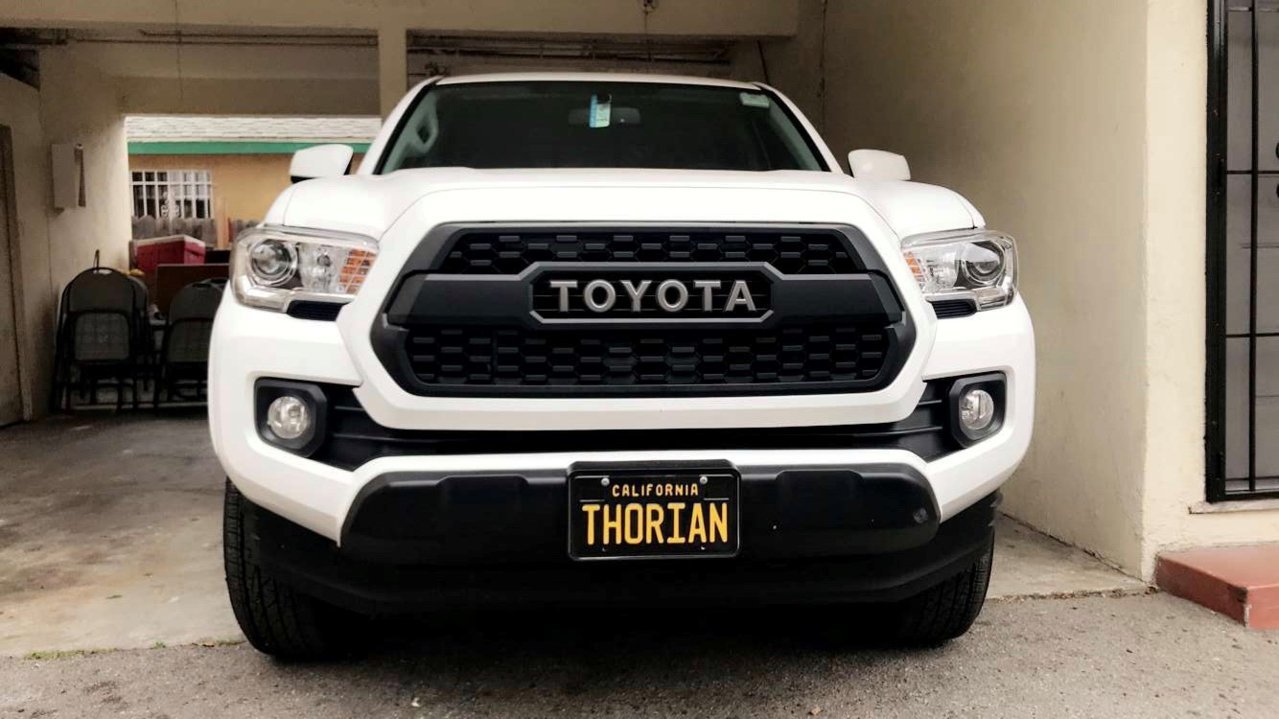

    I bought one off of @durobs and its freaking great! He had an extra he ordered off of ebay. I own a '17 so didn't have to worry about the sensor/garnish issue.
    Unfortunately for @durobs he did have to worry about it, so he had to go a different route (he got oem from a dealer out in Texas I think). But that presented me with a great opportunity to take his extra one off his hands for a sweet deal.
    He had offered it on another thread and I quickly jumped on it, it helped that his office was only 4 miles from my home, so I got to pick it up and check the grille out in person. The grille looked identical to the OEM, and it came in two pieces, the "tacoma insert" was one piece and the rest of the grille another. All of the hardware was included and I was able to install right away.
    The install lasted about 15-20 mins, and I just followed a youtube video, super easy.

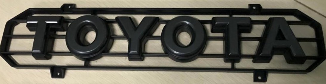

    So I ordered the grille from Trust-autoparts for $119 others on here have commented on and posted great pics of. I messaged the seller to confirm it is indeed the 2-piece and they confirmed it was but I'm concerned a bit at the picture I was sent. I sent another note, but curious if I should expect just black letters I'll have to apply stickers to or paint?

    Areyourshop
    Let’s come separate. Have to double side tape them on.
