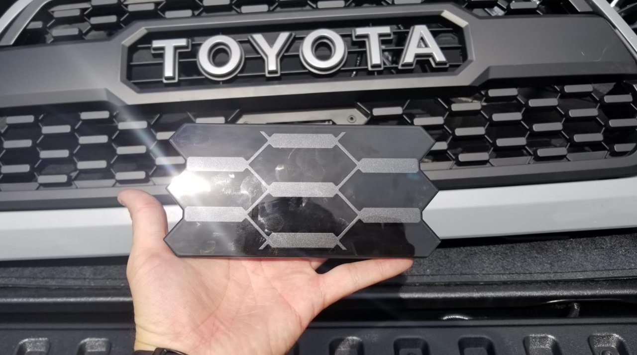

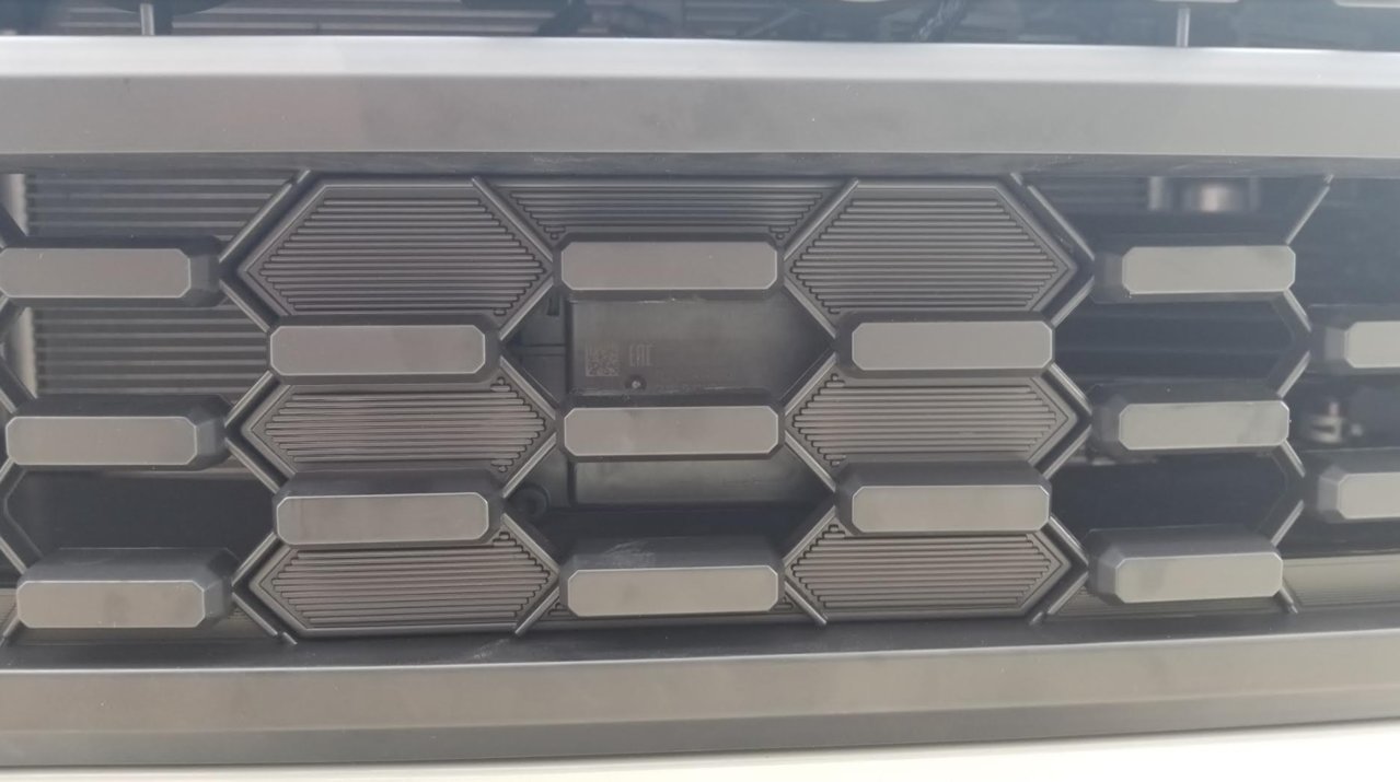

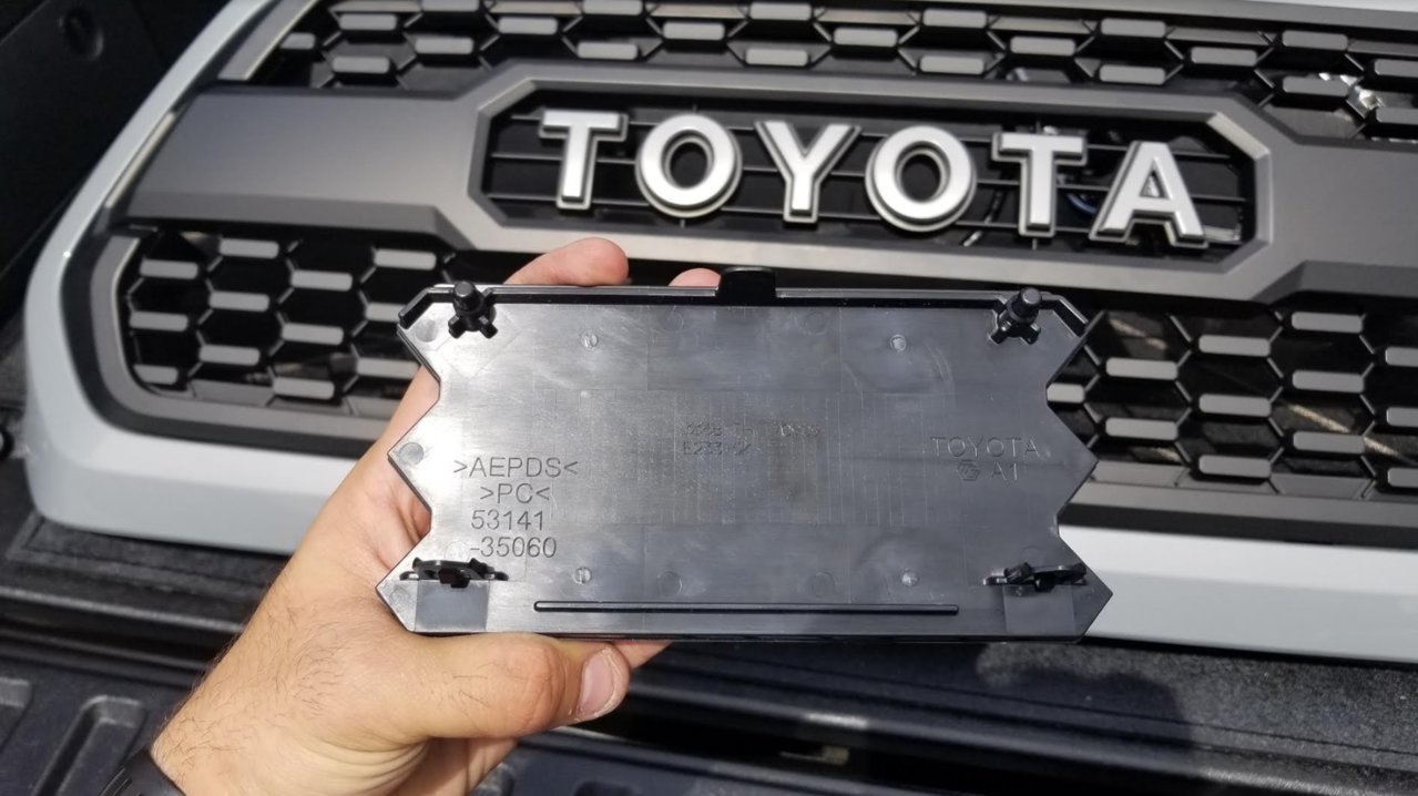

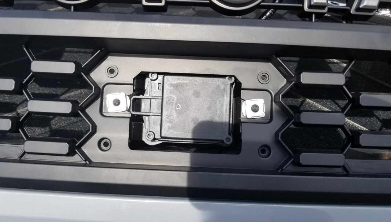

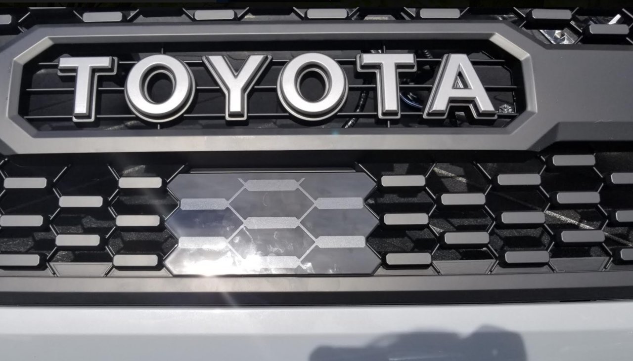

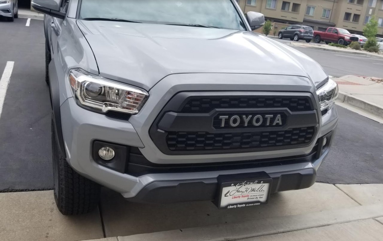

    Got mine in today from the Cali location and installed, fit perfectly and looks great but the OEM garnish tabs don't line up with the grille holes. Trying to figure out how I'm going to make it work, might have to break off the tabs and glue or 3M double sided sticky tape it to the grille.
    Here are some pictures, if anyone has any ideas I'm all ears. Until I figure out what to do, I put the cover back on to protect the sensor and I just won't be using the adaptive cruise control.
    Edit: Part # for the OEM Garnish is 53141-35060 in case anyone was interested

    There are members here not using the garnish, just the piece that came with pro grille. Like how you have it. They just use a piece of black plastic to protect TSS sensor. Some are using a section of front plate holder, cutting it out from behind plate. Install it between sensor and supplied piece TSS works fine. There are post about it.

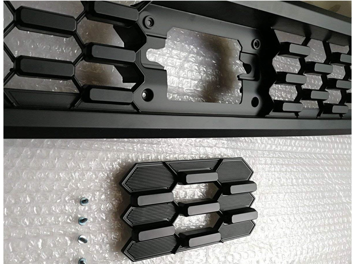

    All 2016-2018 grills will fit the 2018. There should be photos showing the removal of garnish for the sensor. That photo should show whether the holes are correct for the sensing garnish.
    I got my china grill from Amazon, showed all the photos I needed. Sensing garnish was from Ebay.

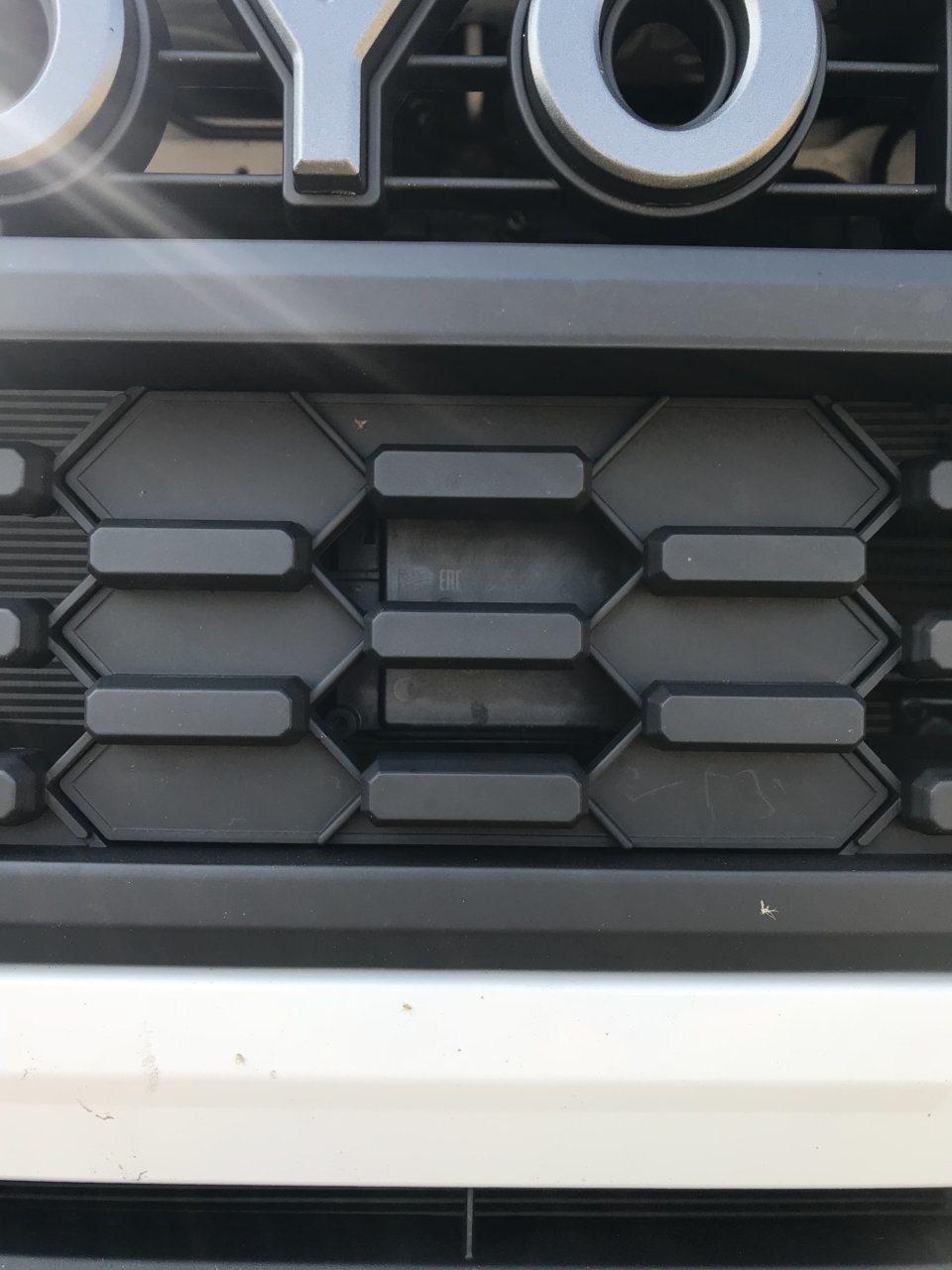

    If you don’t pull the cover off that comes with the grill. The sensor is blocked off pretty well. The only thing really is of concern is rain, mud, or snow.

    This is how mine sits right now. I really don’t like the way the glass looks, so I’m looking at alternatives to protect the sensor. I’m also in California and we have had very little rain.

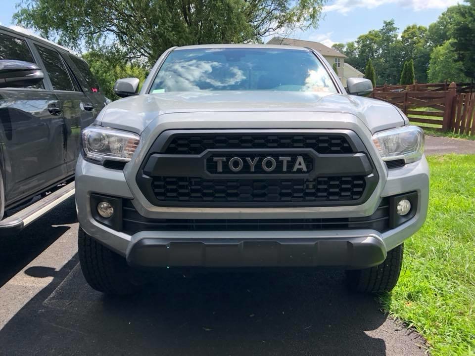

    Just installed my $88 grill today.... fits perfect... I'm also not going to use the glass cover (since I'm not a fan of how it looks)
    I think I'm going to get a piece of thin black plastic or something to cover the sensor... or I may just go to Home Depot and browse until I come up with a decent idea as to how to waterproof the sensor
    but for now, I love the way it looks!
