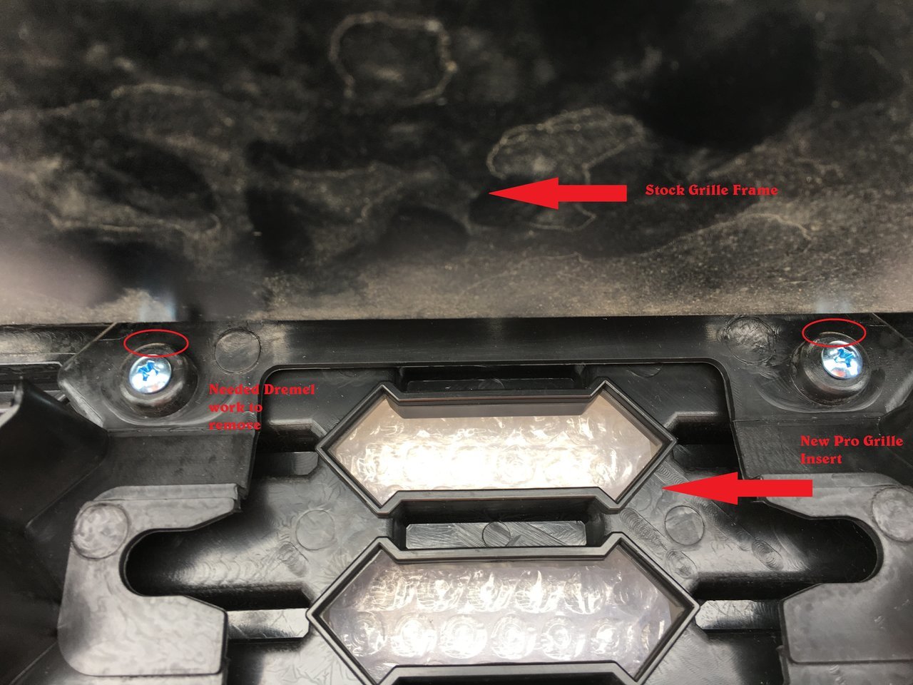

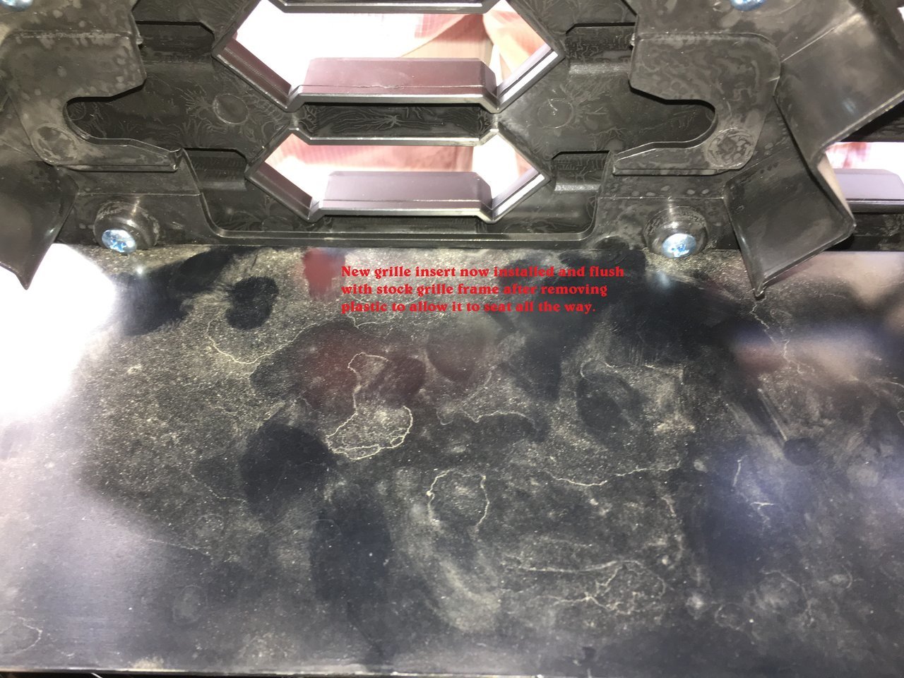

    I did need to file out 2 of the slots, on each end where the TOYOTA horizontal bars seat, to get the letter section to seat. I noticed that the flats with the holes for screws did not sit flush against the thread seat surface bosses. Non-issue and took 2 minutes.

    This might be why i had to push the shit out of it.:rofl:
    Hopefully I dont have to take it off to put it back to OEM or to replace again.

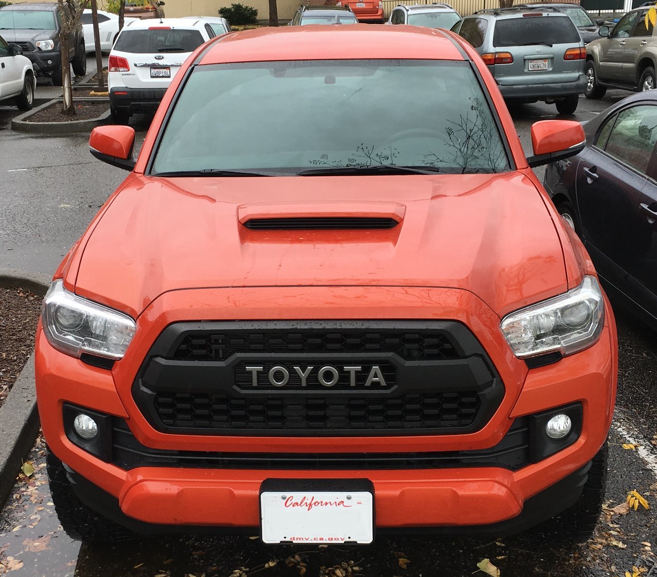

    Thanks for posting the details...it is good for all of us to go into aftermarket products with eyes wide open and having insight into install "mods" is gold standard posting here. Thanks...looks good on your truck.
