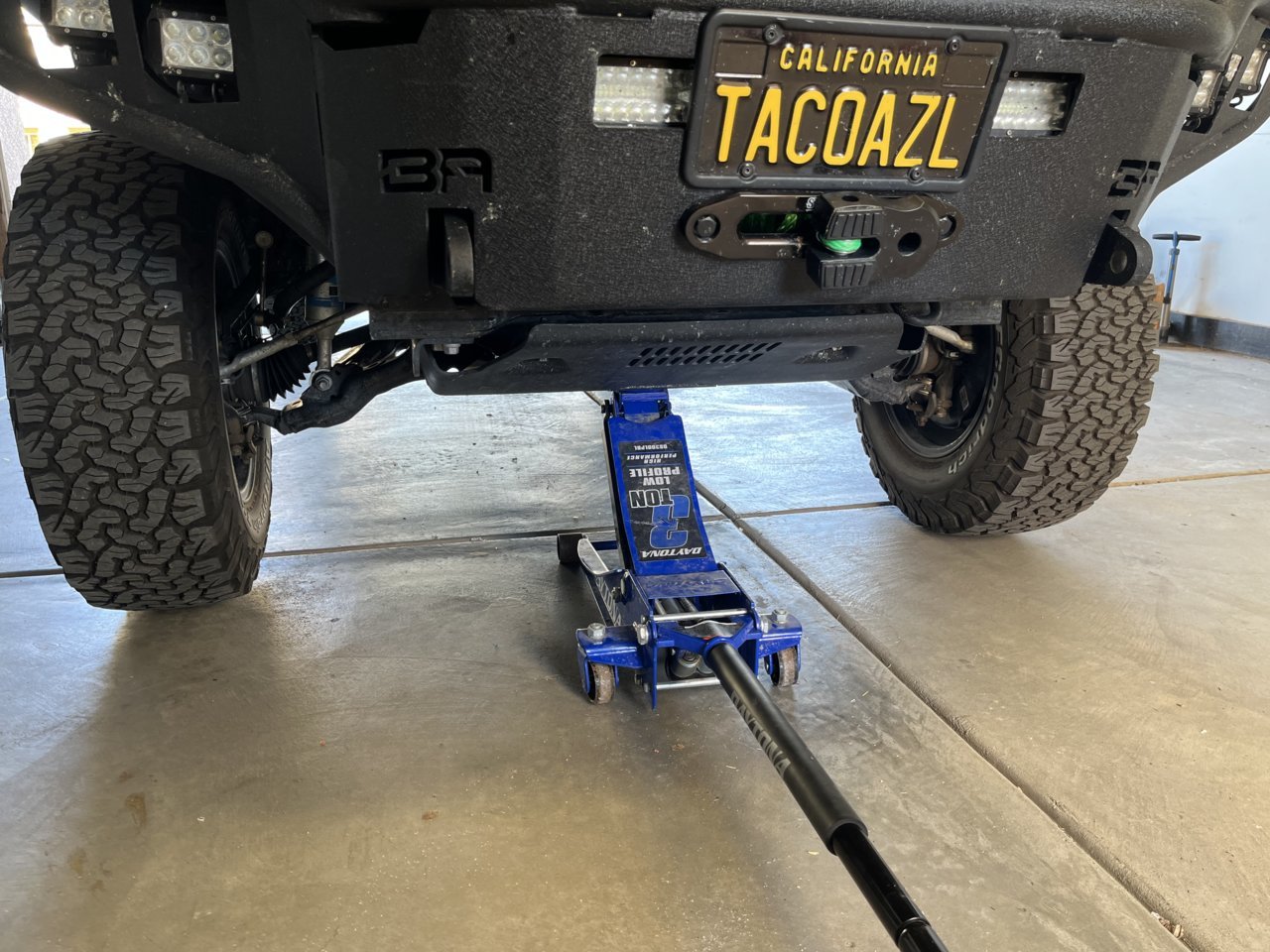

    I have also ran a jack directly onto the skid (at the jack point). No issues.

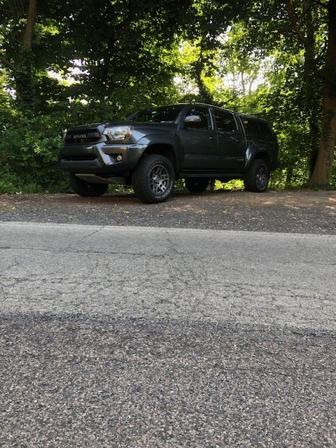

    I put on the Lostar version this weekend. Quality seems great although the packaging was horrendous so it had a few scratches right out of the box.
